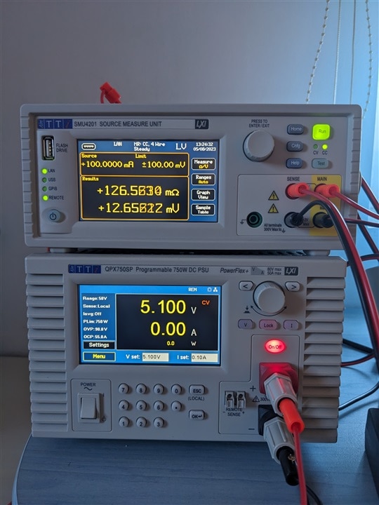

To test this theory I connected the Aim-TTi SMU4201 and the Aim-TTi QPX750SP to a pretty generic N-channel MOSFET (IRF7103), as follows:
Both the SMU4201 and QPX750SP were controlled over the LAN.
With this setup I wanted to plot the Drain-Source Resistance as a function of the Gate voltage. For this SMU4201 was set in Measure Resistance (MR) mode, while the QPX750SP was used to control the Gate voltage. I did a sweep from 0.1 to 15 V and I got this plot:
We can see that the MOSFET turns on a Gate voltage of about ~2V, and reaches its optimum Drain-Source resistance at around ~10V.
This experiment shows us that we can do some basic MOSFET characterization with only a single SMU and some other much cheaper instrument. For more advanced measurements and best accuracy we may still need two SMU-s, and probably an oscilloscope for high speed measurements.
The source code for the MOSFET characterization experiment can be found in the Aim-TTi-SMU4201-QPX750SP-MOSFET-Characterization.ipynb gist.
