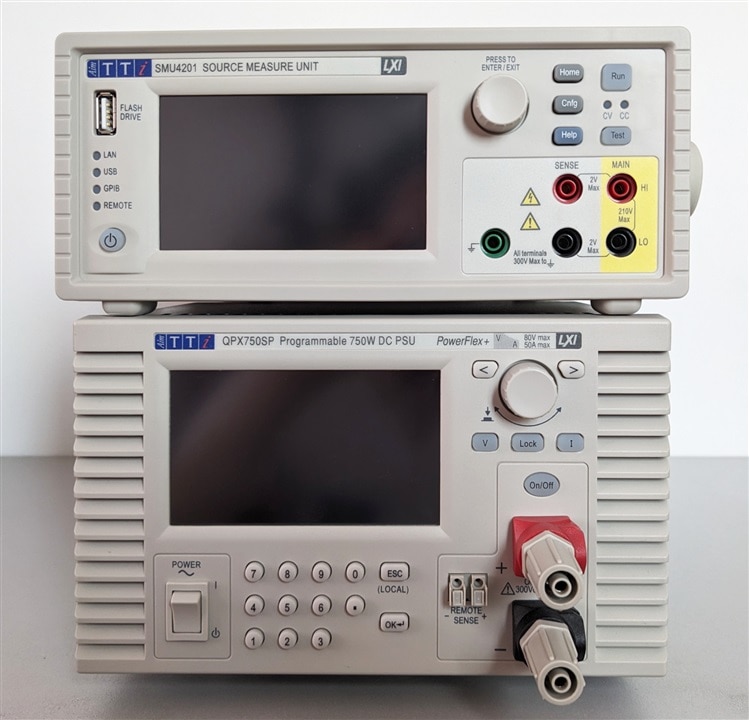

The SMU is fairly compact, Aim-TTi claims that is "smallest bench top smu on the market" it measures 250mm (W) x 97mm (H) x 295mm (D) with handles and bumpers, and 213.5mm (W) (½ rack) x 86.5mm (H) (2U) x 269mm (D) when rack mounted (with the accessories removed).
Bellow is what the SMU looks like along the Aim-TTI QPX750SP power supply, which will be also featured in the road test.

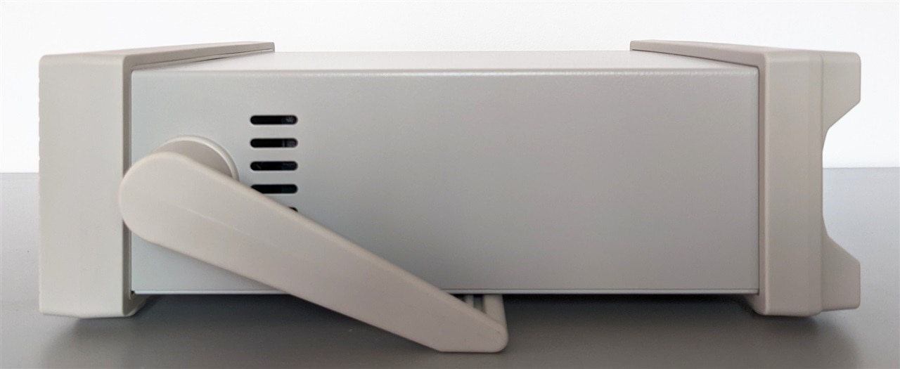

A combined handle + stand is fitted to the instrument. This can be set in 4 positions, from which 3 position are standing, while 4th is for carrying. Compared to leg style stands, the combined handle + stand is maybe a bit bulky, but I think it also allows more comfortable settings. I tend to use it the uppermost setting, which gives o good viewing angle with the instrument sitting on the bench.
{gallery}Stand / Handle Positions
Position 1 / Front
Position 2 / Front
Position 3 / Front
Position 1 / Side
Position 2 / Side
Position 3 / Side
Handle / Side
Handle Bottom
The front panel of the SMU comes with a touch screen (about ~11 cm in diameter), rotary knob, a couple buttons, 4 + 1 terminal posts and an USB port.
The back panel comes with screw-less terminals, power socket, digital I/O interface and LAN and USB ports.
The build quality of the instrument fields pretty good, as expected for the price. The only complain I have is that the on the front the 5 terminal posts and the casing are quite misaligned.

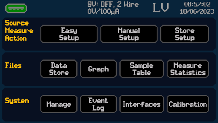

The rest of the settings can be accessed via the Configuration menu, which is accessible via the "Cnfg" button:
Note: I captured most of the menu interfaces using screenshots saved to the USB interface. Weirdly this feature is not active on some of the screens, although the USB icon is shown, but it is grayed out as there was no USB stick inserted. On other screens there is no USB icon. So, for these screens I made screen shots using my phone camera.
The Configuration Menu has the following structure:
  • Source Measure Action
    • Easy Setup - allows quick configuration of the instrument for common tasks
    • Manual Setup - is the place for more advanced / fine grained settings
    • Store Setup - allows saving / loading configurations
    • Data Store - setting of the measurement / sample memory
    • Graph - displays measurements in a graph
    • Sample Table - displays measurements as a table
    • Measure Statistics - show statistics about the measured values
  • System
    • Manage - miscellaneous settings
    • Event Log - information, warning and error messages
    • Interfaces - interface configuration
    • Calibration - instrument and touchscreen calibration

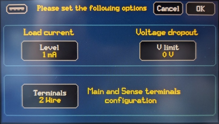

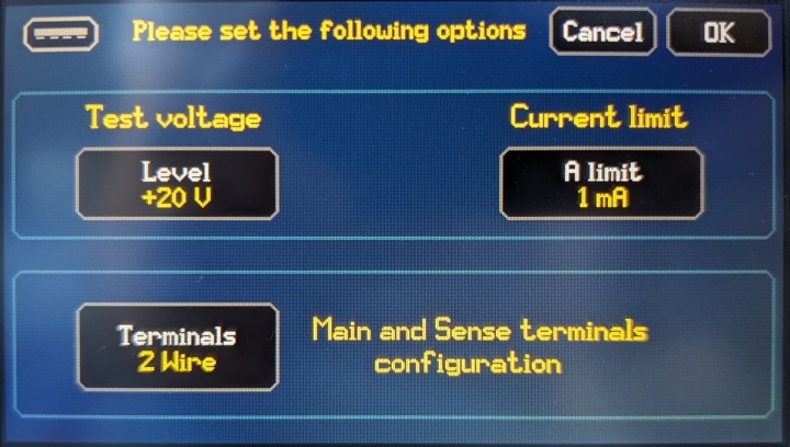

The Easy Setup menu allows us to quickly set up the instrument for the following functions:
  • Power Supply - current limited voltage source (2 quadrants)
  • Current Source - voltage limited current source (2 quadrants)
  • Load - programmable load (2 quadrants)
  • Voltmeter - allows measuring voltages
  • Ammeter - allows measuring currents
  • Ohmmeter - allows measuring resistances (with various voltage and current settings)
  • IR Meter - insulation resistance meter
  • LC Meter - leakage current meter
{gallery:width=720,height=408}Easy Setup
Options (1)
Options (2)
Power Supply
Current Source
Load
Voltmeter
(no configuration options, after a warning / confirmation prompt it jumps to the home screen)
Ammeter
Ohmmeter
IR Meter
LC Meter

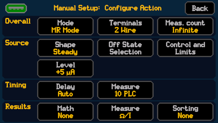

For more advanced features the Manual Setup screen offers a large set configuration options:
The screen is divided in four sections, which remain mostly the same in all of the available modes (except sequence mode):
  • Overall

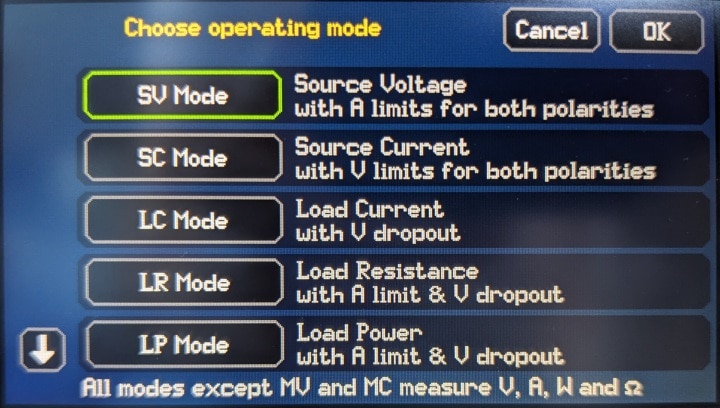

    • Mode - allows select between a Source (SV, SC), Load (LC, LR, LP) and Measurement (MV, MC, MR, MHR) modes, along with the Sequence mode
    • Terminals - we can choose between 2 wire, 2 wire + guard and 4 wire measurement modes
    • Meas. count - allows as limit then number of measurement
  • Source
    • Shape - allows choosing between Steady, Pulse, Sweep, List and Pulsed Sweep modes
    • Off State Selection - lets us set the choose Off state mode (0V/100uA, isolated, etc.)
    • Control and Limits - place for various control and protection settings
    • Level - source level in volts or amperes

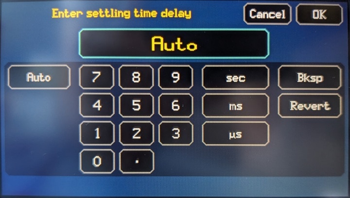

  • Timing
    • Delay - turn-on delay settings
    • Measure - power line cycle filtering (PLC)
  • Results
    • Math - apply math / statistics functions on the measurements
    • Measure - choose the main and secondary measurements

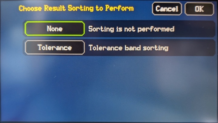

    • Sorting - none or tolerance band sorting

Operating Modes (1)
Operating Modes (2)

Delay

Sorting

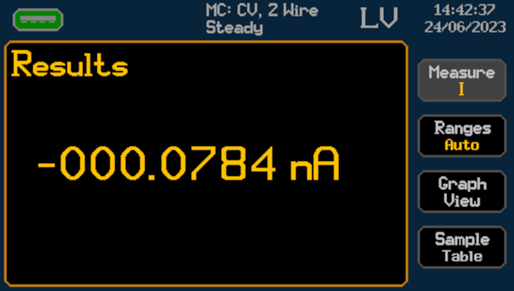

Measure Voltage (MV) Mode
Measure Current (MC) Mode

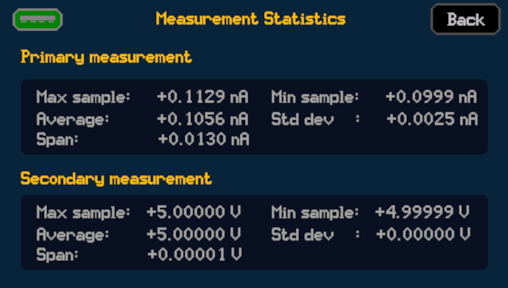

The Files section from the main configuration menu contains link to various features involving the measurement memory of the instrument:

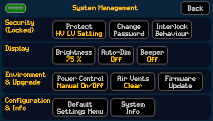

The System section takes us to the menus of system configuration, remote interfaces, event log, calibration and firmware upgrade:

Note: I tried to upgrade the firmware of the instrument, and to be honest I found it to be a bit sketchy. First of all the correlation between the firmware version displayed by the instrument "1.4.1-1.1-1.6-1.2-1.0", and the firmware version from Aim-TTi's website "SMU4000 Series Composite Firmware Update V1.08" is beyond me Grinning. As I was confused even after reading the manual, I wrote an email to Aim-TTi. A couple of days later they confirmed an upgrade was needed (still no info about what the version numbers mean), so I went ahead and did the upgrade as described in the instructions. This ended up being a bit scary, as although the upgrade apparently succeeded (new version number "1.4.5-1.1-1.7-1.2-1.0"), during the process the instrument threw a couple of boot errors at me.
