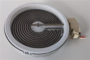

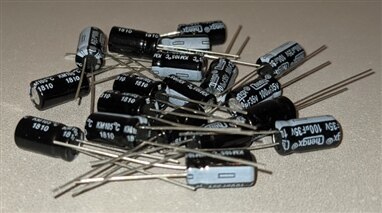

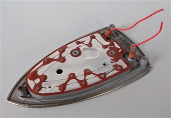

2.2 Dummy Loads
As I don't had a programmable electronic load to properly test the power supplies, I used some DIY loads made from components salvaged from broken electric devices.
These included a series of resistive elements:
a DC motor:
and some capacitors:

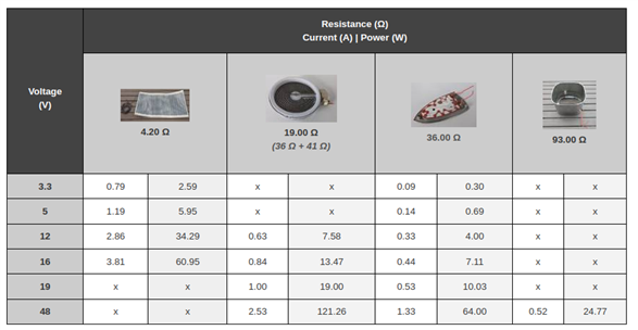

2.3 Passive Load Experiments
The first set of experiments was focused on passive loads:
These included tests with resistive, inductive and capacitive loads. The different power supplies were tested against loads at different voltages.
    (example combinations for resistive loads)
For each of the tests I measured the ripple and noise (rms and peak-to-peak). I also checked the the behaviour on turn on and off events.
Here is a (very) brief comparison based on the test results:

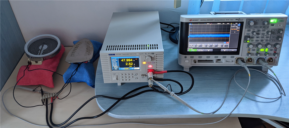

2.4 Dynamic Load Behavior & Protections
Next, I continued with some experiments with a more dynamic nature.
For these test I kept only the two "bench" style power supplies: the Aim-TTI QPX750SP and the RD Tech DPH5005.
I checked the power supplies behaviour under changing loads, in current limiting mode and facing short circuits.
The test setup looked like this:
As the experiments involved dynamic behaviour, I focused on measuring the time taken to react / stabilize after each event.
Here is a brief summary of the results:
