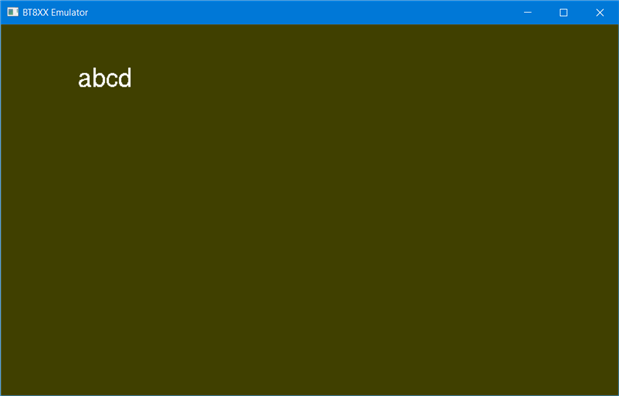

I tried run some coprocessor commands and has been seeing how they affected generated display list.
Example: Coprocessor TEXT command
One of coprocessor command is TEXT command. This command prints text using specified font at specified location. BT817 display list has no support for printing text because this kind of stuff is hardly hardware accelerable. Only way how to draw text using DL is using bitmap command which copy every letter from font bitmap to display. You must manually calculate pixel location for every letter, and you must issue command for printing every letter. Coprocessor very simplifies this because you issue just one TEXT command and coprocessor will generate all the required DL commands for you. I write project which view what happens with DL after issuing commands to coprocessor. Program looks as follows:
BT817_CoprocesorWr32(0x02404000); // CLEAR_COLOR_RGB(64, 64, 64)
BT817_CoprocesorWr32(0x26000007); // CLEAR(1, 1, 1)
BT817_CoprocesorWr32(0x04FFFFFF); // COLOR_RGB(255, 255, 255)
BT817_CoprocesorCmd_Text(100, 50, 25, 0, "abcd");
BT817_CoprocesorWr32(0x00000000); // DISPLAY()
BT817_CoprocesorCmd_Swap();
This program makes following scene on display:
After issuing these commands I will wait until coprocessor process all the commands and then I will read whole DL from memory, parse commands which are stored in this list and print them over UART. After executing this commands, I received following output (it is dump of DL memory):

Next command is more interesting. It is command drawing text using font number 22 to the location 100, 50.
This command is not a standard DL command and it is coprocessor command. After issuing them, coprocessor interpreted it and calculated following 5 commands which it added to the DL.
    0x0000000c 0x1f000001   BEGIN
    0x00000010 0x8c832ce1   VERTEX2II
    0x00000014 0x8ec32ce2   VERTEX2II
    0x00000018 0x91032ce3   VERTEX2II
    0x0000001c 0x93032ce4   VERTEX2II
The first DL command is BEGIN command with parameter 1 which means BITMAP. This command changes mode of drawing primitive to drawing bitmaps. Following 4 commands were VERTEXII command which is special command that defines source position in font bitmap (you can consider it as a letter index) and coordinates where should be letter pasted. For example, decoding parameters of first VERTEX2II command lead you to following human-readable command:
VERTEX2II(100, 50, 25, 97)
You can see coordinates 100 and 50, font number 25 and finally value 97 which is ascii value of ‘a’. This all make sense because first letter of string which we have print using TEXT command was ‘a’. Now let’s look to following command 0x8ec32ce2. It can be decoded as:
VERTEX2II(118, 50, 25, 98)
As you can see, there are two changes. First chage is that ASCII code changed from 97 to 98 because second letter is ‘b’ instead of ‘a’ and second change is that X coordinate is not 100 but it is 118. Because we are using coprocessor, we do not need to worry about it, but it is good to know that calculation of coordinates of every letter is job of coprocessor.
Following 2 commands prints ‘c’ and ‘d’ in similar way as previous letter was printed. Last command is NULL terminating command which is DISPLAY command which were just copied because it is simple DL command. This command terminates display list and inform graphics engine that there are no more commands.

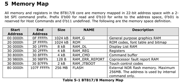

The last thing which I want to mention are memories. They are not totally related to the coprocessor, but they are intensively used and required by coprocessor commands. In previous example you can see following BITMAP_SOURCE command:
    0x00000030 0x0120004c   BITMAP_SOURCE
This command reference address memory at address 0x20004C which is ROM. So this mean that some texture used for drawing button is hardwired into ROM and do not consume any RAM or FLASH memory. In datasheet you can find more comprehensive description of available memory regions but from user perspective there are three important storages which can be used for storing bitmaps and some other things. They are:
  • ROM with hardcoded assets like integrated fonts
  • RAM which you can use for whatever you want, for example you can copy custom bitmaps or fonts here and then reference them from this memory. Capacity of integrated RAM is 1 MB.
  • External FLASH which you also can use for whatever you want similarly to RAM, but it is hard to write and of course you must include some external flash in your design if you want to use it. Evaluation board has onboard 16MB (128 Mb) memory.
On following screenshot from datasheet, you can see all regions. Except regions which I described in previous listing there are RAM for DL commands, area containing special function registers, FIFO for coprocessor commands, some small buffer for human readable description of coprocessor errors and RAM memory for storing firmware of touch controller (you can upload patches here. This is useful if you want to use originally unsupported touch controller. You can find some patches on Bridgetek forum and some of them are also as part of SDK).
