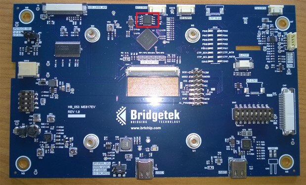

BT817 Evaluation Board also referred as ME817EV is board evaluating BT817 Graphics Engine designed to be used within devices requiring display input/output. At beginning I likely to describe what interesting parts we can find on reviewed board.

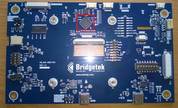

The main chip is not the largest one on this board. BT817 chip is highlighted on following image:

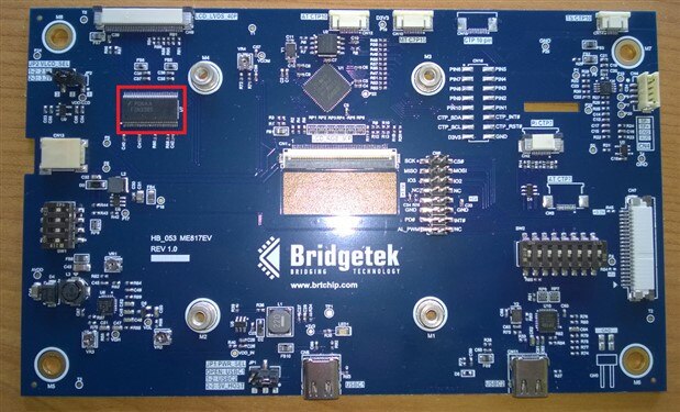

The largest chip is FIN3385 originally from Farchild Semiconductor, but Farchild Semiconductor was acquired by ON Semiconductor, so now you can find official datasheet at their website. This chip is used to convert RGB parallel data signals to LVDS interface. BT817 does not support LVDS but this chip makes LVDS interface on this board available. Chip is highlighted on following image:
Next chip near to main BT817 chip is external flash memory. It is 16MiB (128 Mib) serial flash memory from Winbond.  This flash memory can be used for storing some large assets like fonts and bitmaps without need them stored in program memory of your microcontroller. Memory is connected directly to BT817 and can directly access stored assets stored in this memory. Flash memory is highlighted on following image:

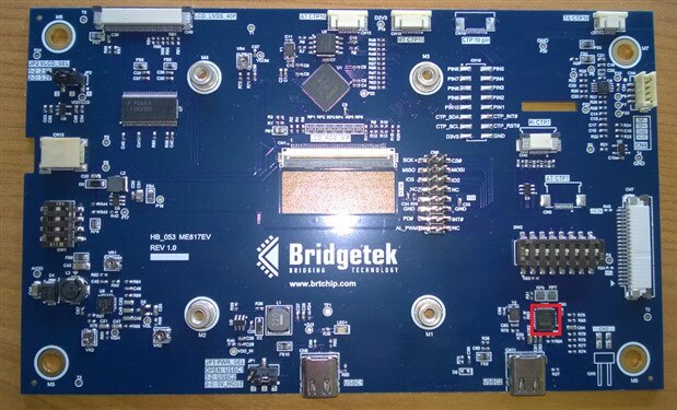

The chip which is located in the bottom right corner near right USB Type-C port is FTDI FT4222HQ. This chip is connected to the control QSPI bus of BT817 and allows you to command BT817 from the computer over USB without need to programming any external microcontroller. FT4222 is highlighted on following image:

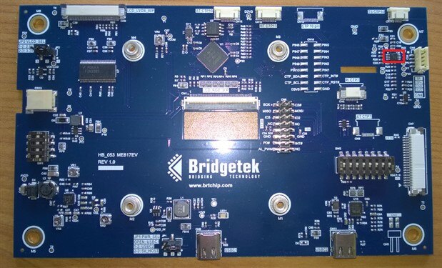

The chip in top left corner is TPA6205A1 audio amplifier from Texas Instruments. Note that board have no speaker, but you can connect your own external one using connector which is near to this chip. Amplifier is highlighted on following image:

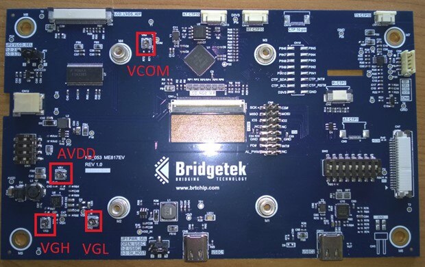

All other chips are used for powering board and display. TFT LCD displays requires multiple voltage usually referred as VGH and VHG, VCOM and also independent voltage for powering analog parts of display. Some of these voltages are pretty high (about 15V) and some of them are also negative (about -6V). Board must also power backlight LEDs and finally, it must generate voltage for powering all digital parts including main BT817 chip. Evaluation board can generate all these voltages. The most advanced powering chip is TPS65145 which is responsible for most advanced voltages like mentioned high voltage and negative voltage. It is highlighted on following image:

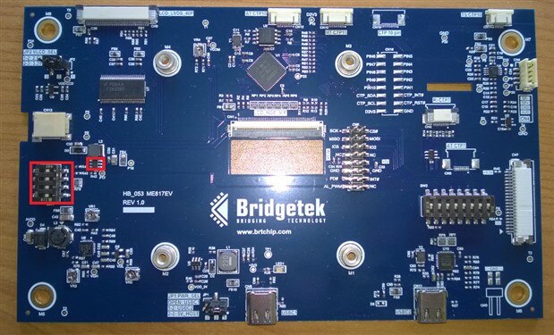

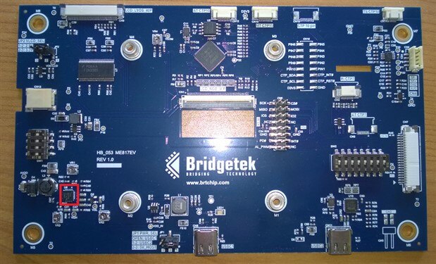

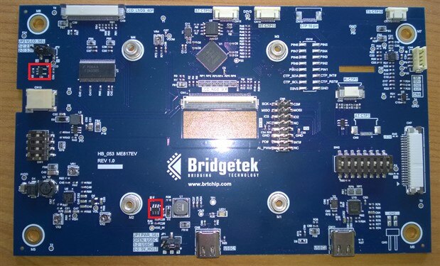

Powering backlight LED is managed by IS31BL3506A from Lumissil. It is boost converter connected in a way that regulates voltage to drive LEDs with constant current. Current flowing by LEDs is adjustable using switches. Regulator and switches are highlighted on following image:
The main supply for digital circuits is generated by AOZ1282CI regulator. This regulator generates 3.3V. You can also choose 2.5V using jumper for powering digital parts of display. In this case 2.5V is generated by MIC5504 LDO. Both regulators are highlighted on following image:

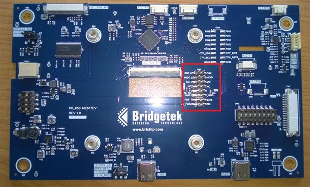

Third powering option is using is using 5V input at host control connector which you can use for connecting your own external microcontroller. This connector is very important to all developers and it highlighted on following image:

As I have mentioned in the previous section, powering cascade is very complex. Board generates lot of voltages and most of them are configurable using trimmers. This allows you to use board with almost any display (with compatible RGB or LVDS interface). I have seen some boards with RGB interface with fixed voltages and some unconnected powering pins, but this is not a case of this board. Boards with some fixed or unconnected voltages are usually restricted to some specific display but as I stated this is not case of RoadTested board which is very flexible. Voltages referred as VGH, VGL, VCOM and AVDD are configurable within boundaries used by most display. Voltages are configurable using small SMD trimmers. Trimmers are available near to related power regulators. It is hard to find them when you are looking to the board first time. There are also no notices that you should check its configuration before powering board with display connected. In my case they come preconfigured from the factory to voltages very near voltages which I needed for my display. You need screwdriver to configure them. It is mostly impossible to configure them by hand without screwdriver. They are small and do not occupy lot of space vertically. Because board was designed also for embedding inside device and not just an evaluation board, I accept less user-friendly trimmers. Near every configuration trimmer there are test points which can be used for checking configured voltage. Trimmers for configuring voltages are highlighted on following image.
Mostly I am satisfied with very flexible powering options on this board, but I think Bridgetek should spend more effort with documenting it.
