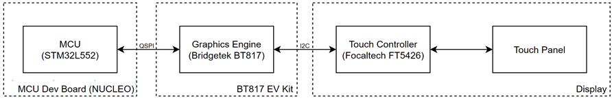

As part of my review, I created simple pacman game using STM32L552 MCU with screen drawn on display using reviewed evaluation board. Pacman is old simple game. You play with yellow player and you can control it’s direction on map. You must collect all dots from the map and prevent collision with autonomous ghosts. You can see my final implemented pacman on following video:
In following sections, I will briefly describe basic concepts of drawing elements to the display using most minimalistic way and some other features of BT817 chip like touch controller.
Initialize display communication
The first thing you need to do is setup communication between BT817 and your MCU/MPU (or other chip which you use for driving SPI bus). Bridgetek provide SDK which you can use. Provided SDK support is written in C and supports three platforms. You can potentially port it to your own platform. SDK supports running on computer (as a normal desktop program) and controlling BT817 over onboard FTDI FT4222 (FT4222 is originally USB-to-UART converter, but it can be reconfigured to USB-to-SPI). Second possible approach which is prepared inside SDK is using their own FT900 microcontrollers. Finally, third option to run SDK is with software emulated display instead of physical one. Even you decide to do not use provided SDK it is good reference for code examples, and it saved me a lot of time when troubleshooting my own library. There are also some different small SDKs and platform specific libraries for some platforms like PIC, STM32 or Arduino, but they are mostly outdated (but working), and they look more like project example rather than SDK. Because I like to know everything about chips, I decided to use chip in a very low-level approach and designed my own library (for STM32) from scratch.
Communication protocol is easy. It is standard SPI protocol which can be upgraded to QSPI for improving performance (you can increase bandwidth about 4 times when switching to QSPI). I attempted to try QSPI, but it does not work with my STM32 well. I have some notices about it in chapter Review of Development board. So, I used just plain SPI which works well. Device uses 22-bit address space (internally it most probably uses 32-bit address space, but 22-bit address space is accessible to you over SPI bus) and additional 2 bits identifies read or write operation. They also identify special host control commands. After you setup SPI communication you must do procedure specified in programming manual or you can find them in SDK sources. Procedure configures some system registers, clocking source, PLL settings for generating correct system clock and waiting until all internal engines boot properly. After that you need to configure display settings like resolution, refresh rate, offsets and some other display related things which mostly depends on parameters of display which you use. After that you can start writing to display list and triggering generating screen.

Touch controller
Another feature of BT817 chip which I have utilized is touch controller. Touch controller is unit which controls I2C interface to chip which physically checks for touches and executes appropriate commands to this chip for achieving continues retrieval of touches. After receiving touches, you can read details about them using standard (Q)SPI interface which you use for any other communication with BT817. Details about touches you then read from BT817 registers instead reading them from touch controller natively over I2C bus. It simplifies complicated implementation of this I2C protocol and managing registers and configuration of this external chip. In diagram it looks as follows:
Initialization is very easy and consists of only 3 steps. First step is resetting BT817 touch engine. Next step consists of configuring 6 calibration values which are used to recalculate touched pixel location from physical coordinates received from touch controller. For retrieving these values, you can use coprocessor routine, but I did it in much easier way and obtained them from demo application using debugger. Obtained values I hardwired to my STM32 project. Of course, for production use it is better to implement calibration routine correctly but for this simple demo hardwired values works well (on my machine ) . Final third step of configuring touch engine is enabling extended mode which allows use to support multiple simultaneous touches. BT817 Touch controller support up to 5 touches. Focaltech FT5426 supports 10 simultaneous touches at once. After this you can do optional step and configure generating interrupts. This I have done, so I checked for touches only when external interrupt on my STM32 happens.
Last feature of touch controller is support for tags. Last buffer which I have not described yet is tag buffer. It has similar behaviour like stencil buffer but does not offer function and operation feature. Instead of this you can configure them for settings static value when drawing some primitive. You for example set tag buffer value to 1 when drawing first rectangle and then you can set tag buffer value to 2 when drawing another primitive. Later when touch happen BT817 touch engine will provide tag value of elements being touched (1 or 2 depending on what element was touched or 0 when some other point was touched). In fact, when you use tag buffer you do not need to parse coordinates of touch, but you can use tag buffer value to determine what control have been touched. It can save you lot of time because for example checking touches inside circle is pretty complicate when it is done manually.
