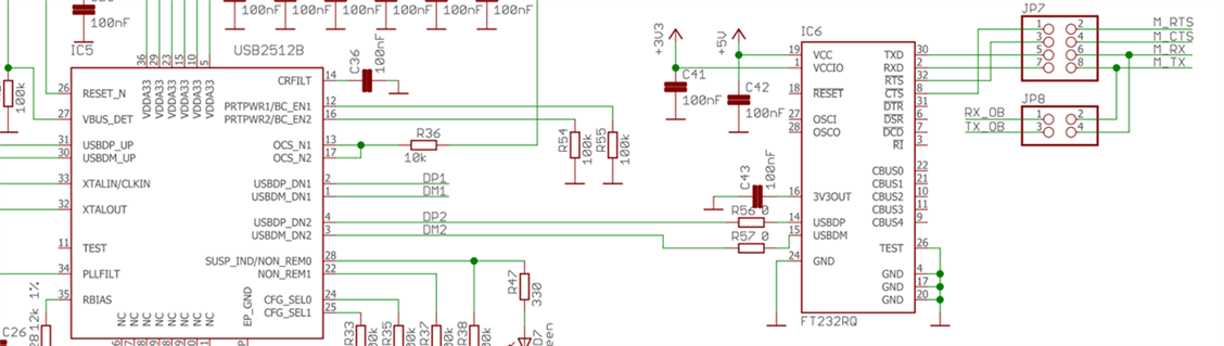

The first thing to do, following my nose, is to have a closer look at the nRF52840-DK and see if the schematics are similar enough that we can use it as a starting point.
We have a schematic for the PAN1780 eval kit in the “module integration guide”, and the nRF52840-DK has the “Hardware files” available from
https://www.nordicsemi.com/Software-and-tools/Development-Kits/nRF52840-DK/Download#infotabs
in this case Hardware files means a complete set of design files including the Altium project with schematic and layout, separate BOMS, Gerbers, assembly drawings, and even pick and place files.
This pack really does put the PAN1780 dev board hardware files to shame! Panasonic only provide un-searchable pdf prints midway through the module integration guide.
This really does feel like an oversight - if you can think of any reason it makes sense for Panasonic not to share the design files please tell me in the comments! there's just no good reason for it.

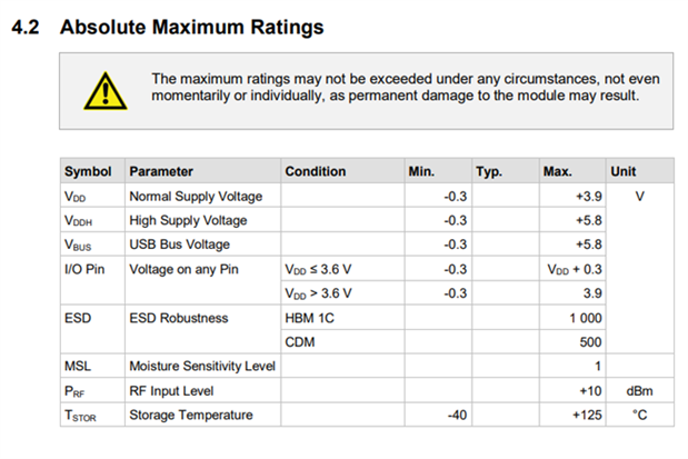

Ok, its not all the detail we get, we are also shown the recommended operating conditions:
And the absolute maximum ratings
But this just isn’t enough.

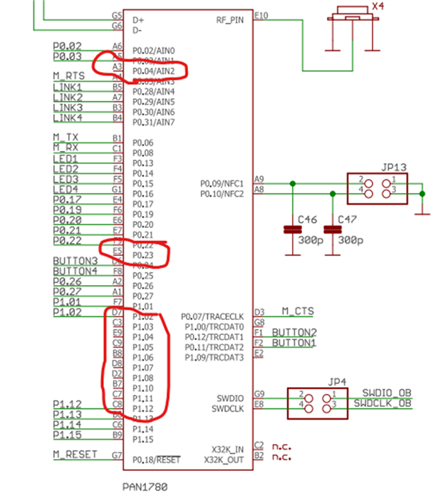

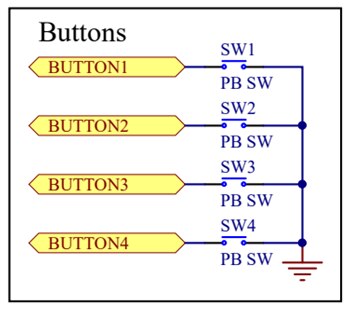

Okay, we should now be able to compare the schematics, and see how similar the 2 evaluation boards are. remember that we are looking to see what changes (if any) we have to make to the software examples for the nRF52840-DK so that they will run on the PAN1780 eval kit.
the schematics for the nRF52840-DK came as printed PDF in the download, while the schematics for the Panasonic Evaluation kit are found in the Product integration guide:
https://mediap.industry.panasonic.eu/assets/custom-upload/Devices/Wireless%20Connectivity/Bluetooth%20Low%20Energy%20Mod…
for reference before we dive in, here is the whole thing:
The Nordic board schematic is much larger than the Panasonic, but at least some of that is the vast number of connectors, which shouldn't affect software at all.
lets start at the top, here's the immediate vicinity of the Nordic nRF52840:
Nothing really on this page yet. if I had to guess, I would sat that all of the stuff on this page is on the PAN1780 module itself.
there's a 32kHz crystal on XL1 and XL2, and a 32MHz crystal on XC1 and XC2. The Antenna is a u.fl or pcb trace antenna (PAN1780 has a chip antenna).
The other pins are all either de-coupling caps and DC/DC inductors (presumably all mounted on-module on the PAN1780), power supplies, or just routed out to off sheet connectors.
Notice the 32kHz clock pins can be disconnected using the solder bridges. - its possible, though unlikely that the software demos will require us to mod those. probably should bear it in mind.
here's probably the corresponding section of the Panasonic schematic:

LEDS and BUTTONS
Starting with the LEDs, we should be pretty sure to find compatibility here, because we have used them in the blinky. Here are the Nordic LEDs:
which map to pins:
ok, so here are the Panasonic LEDs:
follow the net labels:
Great so they are about the same. If we give everybody the benefit of the doubt (and me a break from this tediousness) and assume that there are no firmware examples where you need to break the solder bridges on the Nordic, then the only difference is the resistors – no big deal. But that’s just for starters, what about the buttons?
Nordic:
(by the way, its a nice visual clue that the 2 schematics are done in different packages. I probably wont point out which is which too much, but just in case your not sure, the Panasonic is always the green wires/red pins /black text combo, while the Nordic is blue wires / yellow boxes / blue text format.)
Not quite so straight forward. Button 3 and 4 map to pins P0.24 and P0.25, but buttons 1 and 2 go through this analogue switch arrangement so there’s an option. It seems to be tied to the CTS switch too. Lets compare these to the PAN1780:
So we don’t get the options, only the default. Probably that’s fine right? A switch is a bit more trivial to change than a solder bridge, but default is the expected position for most things. again, be aware, but not a show stopper

User USB to IC / Module
since this is functionally the same on both boards, I'll only show the PAN1780 here:
Debug serial port
The Nordic has a switchable serial port by the looks of it.
the IMCU ports go to pins on the on board interface MCU (aka debugger)
Its not clear without digging deeper if this switch is controlled by the debugger driving IF_ON, or if the debugger is also reading the state. Either way, the IF_ON signal also affects power switches and other things, so I’d suggest it was probably reasonable to assume the default is ON.
The Panasonic pins are spread out a bit, note that the optional CTS is NC on the Panasonic – we only get the default.
This is a bit of a departure.
The Panasonic routes the same serial port pins via some link jumpers to an FTDI chip serial to USB converter. The USB lines are then connected to a port of the 2 port USB hub, which has the main X2 USB connector as its up-stream connection, and the J-link on the other downstream port. There is 2 further twists though, the Link jumpers can be changed to route the serial port Rx and Tx to either the J-link directly:
or, to the outside world:
So we can just use it as UART1 on these pins by bridging the jumpers across the gap.

Speaking of DEBUG...
The Nordic allows the switching of the SWD signals away from the onboard debugger to an external connector
as does the Panasonic via link jumpers, but, there's another subtle difference -  the Panasonic doesn’t give us SWO, connected to P1.00 on the nRF52840-DK (that pin doubles up as TRACEDATA0/TRCDAT0)
For that matter, none of the TRCDAT pins are made available for use in the same way they are on the Nordic:
M_CTS can be disconnected by removing a link jumper, and the 2 buttons are Normally-Open, but we can’t even get a test wire onto TRCDAT0 or 3
On the Nordic however:
So what does SWO do? What do the TRACEDATA pins do?
Well, SWO is the output for the ITM (Instrumentation Trace Macrocell) data. This is basically a high speed debug data connection, which allows much faster debug information to be sent through the debug adapter than would normally be possible through a serial port.
The rest of the TRACEDATA pins provide access to the ETM (embedded trace Macrocell) - a much more in depth debug port which can give you things like the call stack in real time and even the history without disrupting the processor. Its obviously extremely valuable for a certain set of embedded problems, but adapters which are compatible must read and process much larger quantities of data, and so are proportionally more expensive. (think £1500+) it seems unlikely that we have that functionality on the on-board J-link of the PAN1780, so I don't suppose we will miss it that much. the lack of SWO should be noted though:
SW is compatible if it:
  • uses board in default configuration
  • does not use the flash memory
  • does not use PIN P0.23
  • does not use the CTS and RTS function of the debug serial connection to the debugger
  • does not use pin P0.04
  • does not use ITM debugging (via SWO)
  • does not use pin P1.00 or P1.09
Rounding up
Most of the rest of the circuitry on the nRF54820-DK is just connectors, but there are a couple of extra features.
There are some pins marked SDA and SCL mapped to P0.26 and 27, which have switchable 4k7 pullups connected by default. This one again I think its fine, so long as we are aware of the lack of pullups on the eval kit.
on the PAN1780 eval kit, we can close out the comparison by looking at the GPIO pins on the module which don’t appear to be accessible.
We’ve already spotted the 2 debug related pins, and the one used for flash memory and CTS_OPTIONAL on the Nordic, but there are also a few more:
and our hopefully complete compatibility criteria for software examples provided by Nordic for the nRF52840-DK
  • does not use any of the pins:
    • P0.04
    • P0.23
    • P1.00
    • P1.03
    • P1.04
    • P1.05
    • P1.06
    • P1.07
    • P1.08
    • P1.09
    • P1.10
    • P1.11
