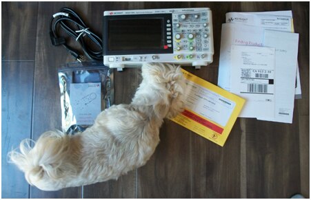

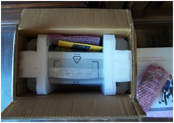

First I want to thank Element14 and Keysight for selecting me as one of the roadtesters for the InfiniiVision  DSOX1102GDSOX1102G Oscilloscope I knew when the package comes from a delivery confirmation email and I was happy to find it on my porch   I took the package inside the house:
Then I opened it,

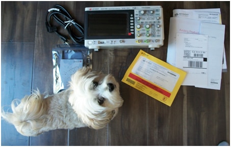

and I explored the contents.  Here is what I found inside:  The oscilloscope, power cable, two probes packed together in a bag, a certificate of calibration, and various documents with useful information about this product.

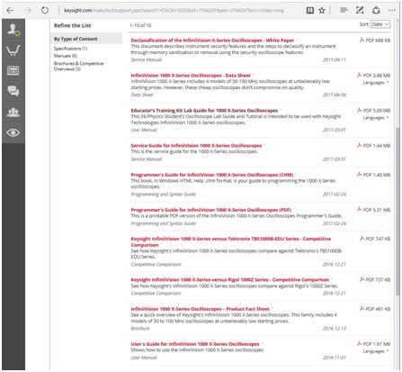

One of the documents showed me where to go on-line and download the manuals for this oscilloscope.  I took the document to the other room and I went to the Keysight web site address listed there.  Here I found multiple documents available for download:
I personally liked the educator training lab and I find it very beneficial to students who get exposed for the first time to using an oscilloscope.  I then went back to further explore the  DSOX1102GDSOX1102G oscilloscope
(my dog was also excited to explore this oscilloscope)

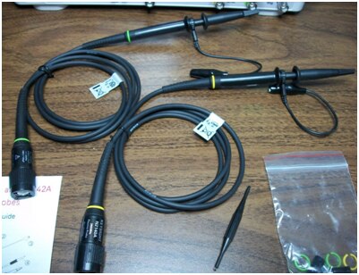

Next I opened the bag with probes:
And I attached the color rings to each probe:

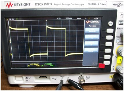

I then connected the probes to the oscilloscope and I calibrated the probe compensation using the small screwdriver included in the probes kit.  The “yellow” probe was a bit undercompensated ; the “green” probe was just right.  Here is a short video:
The probes may be undercompensated, like in this picture:
or overcompensated like in this other picture:
or they can be “just right” compensated like in this picture:

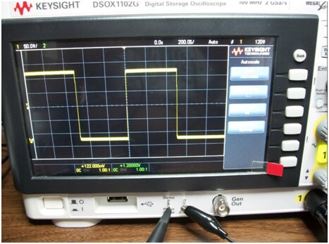

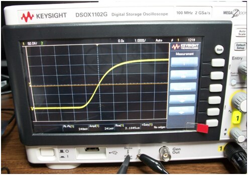

With this setup I then performed a few basic measurements of this waveform.  First I set the trigger on rising edge of channel 1 (yellow):

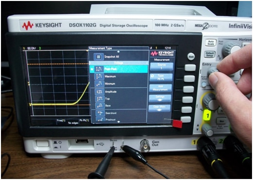

and I setup the built-in measurement function to measure the peak-to-peak value:
The knob labeled “Entry” highlights the measurement when rotated and selects it when pressed.  Similarly I have selected to measure “Amplitude”, “Rise time”, and “Duty Cycle”.  The four measurements are displayed at the bottom of the screen:
Notice that the duty cycle measurement displays “No edges”.  This is because the displayed waveform represents only part of a period of the signal, so I had to adjust the time base to display multiple periods and thus to provide the needed information for the built-in duty cycle measurement:

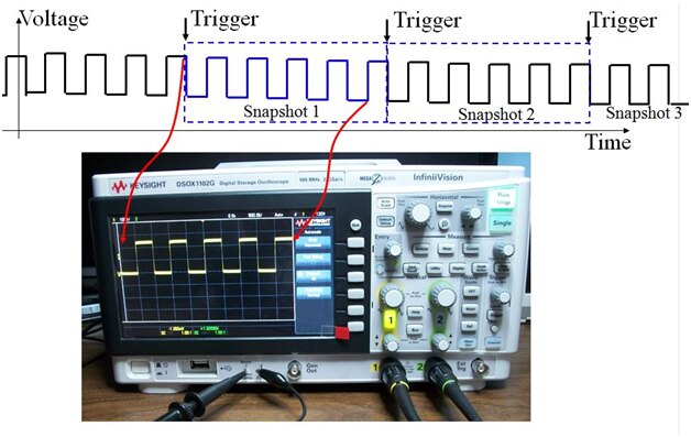

In a very simplistic way, an oscilloscope is an instrument that can be used to visualize how signals vary in time.  The following figure shows the graphical representation of a square wave signal and the image of this signal as shown on the display of an oscilloscope:
We can view the oscilloscope as an instrument that captures successive snapshots of the signal waveform and displays them one after another on the screen.  The trigger function of the oscilloscope ensures that each snapshot starts at the same location within the signal period so the sequence of snapshots overlap perfectly in one single waveform.  The time base function of the oscilloscope ensures that each snapshot has the same length in time, thus when sequentially displaying these snapshots the image is clear and stable.
