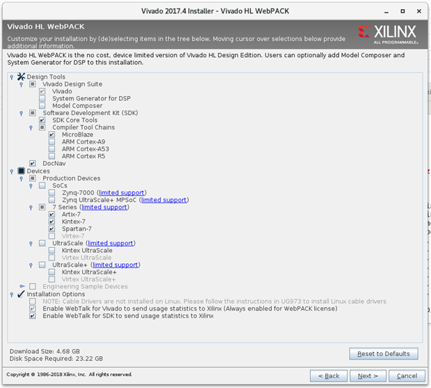

For the Arty S7 board, the choice of development tools is limited to Xilinx’s Integrated Development Environments, specifically the VivadoRegistered HLx Design Suite WebPackTm, a development environment for the FPGA hardware design, which is free for the Spartan-7 FPGA family. If the hardware design includes also the MicroBlaze soft core microprocessor, you can also take advantage of the Xilinx Software Development Kit for the development of the software side of your project. One important note: in order to be able to download and install any of the Xilinx tools, you are required to create an account on their website first.
For my project, I am using a Linux Debian 9 distribution as OS for my development, and the Vivado Design Suite 2017.4. Before installing Vivado, you need to make sure you read the list of requirements for the system, as the tool is quite demanding in terms of resources. In particular, check the recommendations for the minimum amount of RAM required. The Spartan-7 are not listed there, but probably you can apply the same recommendations as for the Artix-7/Zynq-7000. I have tested Vivado on Intel i7 machines, one equipped with 8GB RAM and 1TB HD (normal), and the other with 16GB of RAM and 500GB HD (SSD), and the suite had good performances when running the full build (synthesis-implemetation-bitstream generation). If you use less RAM (4GB), be prepared to hit problems and make sure you got plenty of coffee at hand before you start…
As for disk space requirement, it can vary, depending on what you choose to install. The screenshot shows my choices for the install, and it resulted on an installed size on disk of roughly 24GB (to reduce the install size, I removed the support for Zynq and the UltraScale platforms, as I’m using it only for the Spartan-7 FPGAs. This way I managed to save about 8GB).

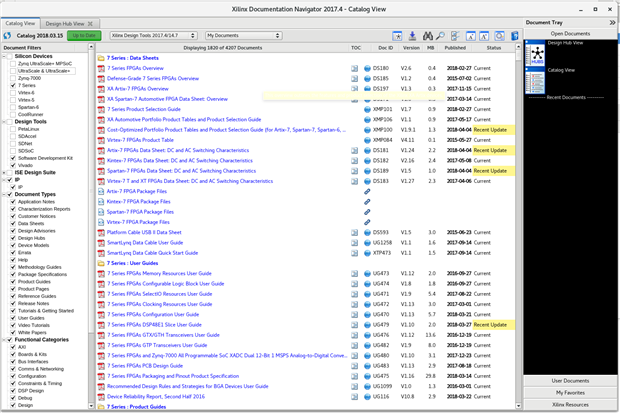

Although not strictly necessary, I recommend installing the Documentation Navigator. Xilinx produces an incredible amount of documentation (Guides, Application Notes), and navigating through all this stuff can be daunting, especially when you have to search it on the internet. I found the Documentation Navigator extremely helpful, offering a clean and friendly way of accessing the documents (see the screenshot below), although at expense of some disk space.
The installation will take some time, especially if you don’t have a fast internet connection available. Once Vivado is installed, the next step is to add the support for the Arty S7-50 board. Such support provides Vivado with the system-level information about the board (Spartan-7 pin mapping to the board interfaces), allowing the board to be selected as target when creating a new project.

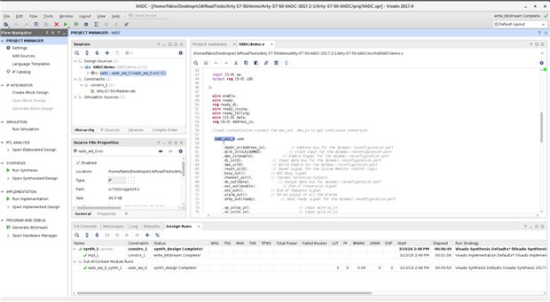

Vivado is now ready to be used for the first project. Being new to the tool, using the graphical user interface (GUI) is definitely the easiest way to work with it, but this is not the only way. Vivado supports the tcl scripting language, which means that, investing some time learning the language and the commands provided by the suite, a project can be created and built just using a script, without the need to launch the GUI at all. This allows automation of the build, and also contributes to save some precious RAM, better utilised for the synthesis of the hardware rather than showing the GUI.
To get started, there are couple of demo projects available on Digilent’s website. Lets load one, to get acquainted with the typical flow used to go from VHDL/Verilog modules and IP cores to the downloading the bitstream onto the board.
The demo used is the Arty S7 XADC. Basically, this project uses the 1MSPS analog-to-digital converter that comes with the Spartan-7 FPGA to sample the voltage applied to 2 pins of the Arduino compatible header (the voltage needs to be limited to 0V-3.3V, to avoid damaging the FPGA pins). The LEDs on the boards will act as rudimental meter (0V – all LEDs off, with the LEDs turning on one at time when the voltage increases, to reach the 3.3V – all LEDs on). The selection of which pins of the header to use as ADC input can be made by using a specific combination for the 4 switches on the board.
The project main file is the Verilog top module XADCdemo.v, where all the logic is defined. Looking at the code below, you can see the module uses also an IP Core (xadc_wiz_0) for the ADC, created using the XADC Wizard. This is one of the great features of Vivado: the IP Integrator with its IP Library. IP cores are the “CoTS” of the digital world: they are ready packaged modules, which offer a specific function that users can customise to their needs. Many of them are free to use in your design, while some need to be purchased.

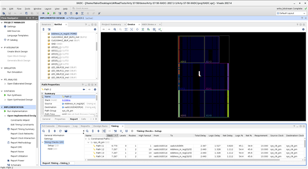

The other fundamental file of the project is the constraint file: this file contains the mapping between the board hardware, the FPGA’s pins and the I/O port names used in the VHDL/Verilog code.

Those step are easily found in the Vivado GUI, as you can see from the screenshot below:
The simulation step is used to test the modules, and consists in generating all the signals according to the code in the module, that you can later inspect using the logic analyzer tool that Vivado provides. Normally, to test your design, you would create a “test bench” module for each of the modules in your project (or at least for the most important ones). The test bench is basically a sort of wrapper module, which instantiates the module under test, and exercises its I/O by generating patterns of signals. For this demo, I will skip the simulation.
The Synthesis step is the first phase of the mapping of the code onto the FPGA hardware. The focus of this phase is mostly to operate the translation of the code into blocks that can be realised on hardware, to make sure it can be done, and as such it is device-independent (i.e. it won’t need the constraint file). If the synthesis step completes successfully, it still doesn’t mean that our design is actually mappable onto the hardware we are using.
The Implementation step is the one that will map the design onto our actual FPGA hardware. During this phase, the logic components will be placed and routed within the FPGA fabric, and a series of tests will be run, to make sure the mapping is within the specification. Once this phase is completed, Vivado gives access to a series of reports, where you can find all the information you need about the mapping. Particularly important is the Timing report, which uses accurate simulation techniques to provide information on delays affecting signals travelling on different paths (nets) within the FPGA hardware. Fine-tuning the timing specification will be needed if failures are highlighted by the timing report.
Once the Implementation step is successfully completed, you can start the bitstream generation step. This will create the binary stream of data needed to program the FPGA. On completion of this step, all is left to do is to download the bitstream to the board, using the Hardware Manager, and you are ready to go. Below there is the link to the video of the actual demo.
