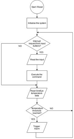

As for the hardware, lets try to use a simple design for the software as well. On the right there is a first sketch of the basic flow chart.
Once the system is powered-up (or reset), it goes through the initialisation procedure, when all the system’s modules are brought up and configured.
The core of the action happens inside is the main loop that follows: the system will accept commands from the buttons, changing its operating mode accordingly, and then will read the thermal data from the Grid-Eye, and will use it to determine if an object has appeared in the field of view.
The main sticking points for the design are:
  • the user interface design: need to devise an easy way to capture the user input, using only the 4 push buttons and the 4 switches;
  • the reading of the sensor: the GridEye samples the thermopile sensors and refresh the data only every 1/10th of a second (10 Hz) at the fastest, therefore accessing the sensor via I2C at higher frequency would be only a waste of resources. As designed in the flow chart, the system would loop on the reading constantly, and considering the system runs with an 81 MHz clock, even considering the overhead for the processing, it is still way too fast, so that needs addressing

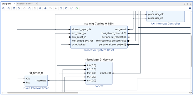

Let's address the last point first. As the problem is basically to "slow down" the loop, the first thought would be to add a delay. As the system is not particularly demanding for its timing, it would be easy to think such solution would solve our problems. But delays are blocking calls, and since our system would be spending most of the time waiting, beside the waste of resources, there is the potential problem of the "lack of responsiveness" caused by the blocking delays.
Considering that our system already uses interrupts for responding to user input, a better approach would be to follow the same route for reading the GridEye data as well: set up a timer that generates an interrupt every tenth of a second.
We don't have any timer amongst the resources we created earlier during the hardware design, this means we need to go back to our design and add one.
Fortunately, Vivado offers a Fixed Interval Timer IP block, where you can define exactly the time interval you want the block to fire an interrupt. Obviously, together with this block, we need to increase also the number of interrupt ports available on the Concat block, which will take care of bringing the line up to the AXI Interrupt Controller. The picture below shows the modified design.
Hopefully, there won't be the need to rework the design anymore, so lets fire up the Sythesis/Implementation/Bitstream generation build again, and make sure we export the hardware as well, so that our SDK project will be synchronised with the new hardware, and the new interrupt will be available to use.

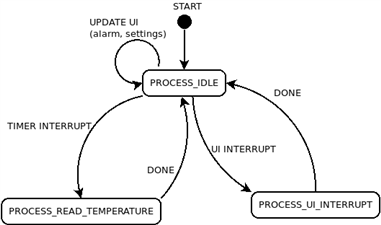

Incorporating this change, we can now think the design in terms of interrupts. Working with main loop and interrupts, rather than flow chart, it makes more sense to describe the system using a state diagram. The application main loop, which will take care of the user interface and alarm (actioning the LEDs) will be the PROCESS_IDLE state.For the two interrupts, we need to write the interrupt service routines, which will be invoked by the system when the interrupt is triggered. Such routines will be very "light", as they will only set a flag which will cause the state to change.
The timer interrupt will cause the state to transition to PROCESS_READ_TEMPERATURE. In this state, the system reads the frame temperature from the GridEye and checks if the threshold has been hit.Once done, returns the state to PROCESS_IDLE. The user interface interrupt, generated by the buttons on the board, will cause the PROCESS_IDLE state to change to PROCESS_UI_INTERRUPT. In this state, the GPIO ports for both switches and buttons are read, and the data interpreted, according to the rules specified later on in the UI design section. Once the processing is done, the state moves back to PROCESS_IDLE.

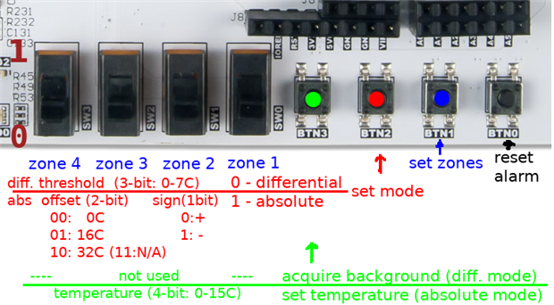

Lets address the other point we left suspended: the user interface. As simple as a system can be, it is only as simple as its user interface, and this is why it is important to find an easy (or, should I say, "easy enough") solution to the problem.
The system has 4 push button, which we can use for the main functions, and 4 switches, that can be used to "enrich" the push button, and provide the extras information needed. It seems natural to use the switches as a nibble (4-bit word), which we can use to let the user input data in binary form (either for on/off-enable/disable settings or for actual numbers). We can also use the LEDs to help, for example by flashing them to confirm the input of some switches configuration. The image below shows the mapping I have chosen for the system.
Let me explain the choices. The system needs to support the following functions:image
  • F1: Reset Alarm
  • F2: Set Zones
  • F3: Set Mode
  • F4: Set Threshold
  • F5: Acquire Background (only for differential mode)
For function F4, if the switches SW0-SW3 are used to input the temperature in binary form, that would only allow for values from 0 to 15C, which is not enough. We need to extend the range by using some fixed offset. Moreover, for the absolute threshold, we also need to define the sign of the threshold, as it could be either positive or negative.
Ideally, each button should be used for one function only , but unfortunately the board has only 4 buttons, so one of them will need to be "overloaded".This is the mapping:
  • BTN0: F1 (switches not used)
  • BTN1: SW0-SW3 will be used for F2  (each switch represents one zone: enabled=1, disabled=0)
  • BTN2: Switch SW0 will set the mode (F3) - OR -  SW1-SW3 will be used for F4 (if in differential mode), or SW1 will set the sign and SW2-SW3 set the offset (in absolute mode)
  • BTN3: F5 (if in differential mode -switches non used) - OR - SW0-SW3 will be used for F4, and the total threshold will be calculated as this value plus the offset previously set by SW2-SW3 with BTN2, all with the sign assigned by SW1 with BTN2
It sound very convoluted, but actually it is not as bad as it seems. The video will show how I have implemented the UI, and also how the LEDs are used for confirming the user input.

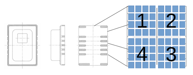

I have mentioned detection zones before, without explaining what they are exactly. The GridEye sensor consists of an 8x8 array of thermopiles, for a total of 64 pixels. The field of view of the sensor can be approximated as a square area, with an opening angle of 60 degree, both vertically and horizontally. For the detector, this area is split in 4 detection areas (zones) of the same size, 4x4 pixels. The zones are indexed from 1 to 4, as shown in the image below.
One final note about the user interface: to help improve the experience, the 4 green LEDs of the board will be used to give confirmation of the action to the user. The logic for the flashing of the LEDs will be part of the PROCESS_IDLE state processing, this way we will have good response time to the user action. Same applies for the alarm signal: when one or more zone detect an object, the alarm will be triggered. This will be shown on the board by switching on the 2 RGB LEDs (using only the red colour), and by turning on the green LEDs corresponding to the zones that sensed the object. To make sure the user interaction is not influenced by the alarm switched on (and viceversa), the status of the alarm light is preserved, so while providing input, the user will still have the usual response (confirmation flashing lights), but at the end of that, the alarm status is restored, so the information is not lost.
