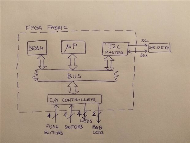

The challenge is to provide a “good enough” user interface, leveraging only the basic I/O devices present on the Arty board (switches, buttons and LEDs). I could have used a more sophisticated approach to provide a richer user interface, but I really would like the board to be self-contained, without the need to plug anything but the power supply and the Grid-Eye.
One note about the project: the system really doesn't exploit the FPGAs potential, and would probably be better (and cheaper) to realise it using one of the more common microcontroller boards. I chose it because I believe it still makes a good example of a simple System on Chip (SoC) application and, hopefully, will provide some insights for those who are just starting to experiment with this technology.
Lets now sketch our system. Below you can appreciate the system in its simplest form: there is the processing unit, some memory, an I/O controller (GPIO) and an I2C controller for the Grid-Eye sensor. Although such minimal system works, for the actual final system that will be created on the FPGA, I will include extra components, since I also want to experiment with the other parts available on the board.
The system is put together using the powerful Vivado IP Integrator, without the need to write a single line in any HDL language. This really shows the power of those “high level” tools, where you don’t need to deal with the details of the RTL design while creating your system. For a maker, this is definitely great news, as it does simplify and speed up the development time significantly.
There is a flip side though: hiding the details, you never really know what is happening “under the bonnet”, which spells troubles if, at some point, anything goes wrong! On a positive note, Vivado’s log files are quite verbose, and there are plenty of them, produced at each stage of the processing, making it a little easier to debug issues.
The choice of using IP cores and build the system around the MicroBlaze soft core processor saved quite a lot of time on the hardware design, although some of it had to be spent familiarising with the Xilinx software libraries while developing the firmware. For all those makers thinking of stepping into the FPGA’s world, but still hesitant because they fear they are lacking digital design skills, I think this approach is the one offering the path of least resistance: moving the complexity from hardware to software design, where most people feel more confident, surely gives the necessary boost to make the leap.
Obviously, my project could be completely realised usign RTL design techniques, writing all the modules from scratch in HDL (VHDL or Verilog) , but as first approach, I though it would be more valuable to explore the block design way. Nevertheless, I’m planning to re-implement the design without using IP cores, by writing all the modules from scratch in VHDL. That way, I will also be able to avoid using the MicroBlaze, and implement everything using only simpler finite state machines. But this is a subject for another blog...

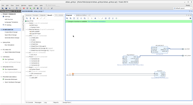

Once a new project has been created in Vivado, the next step is to create a block design, which will open a nice and clean Diagram window, where we can start adding our blocks by clicking on the "+" button. This brings up the IP Library navigation popup, where the wanted IP can be selected.
Below you will find a slide-show photo gallery, illustrating all the steps taken to create the design, with relative comments.
{gallery:autoplay=false} Vivado Hardware Design Steps

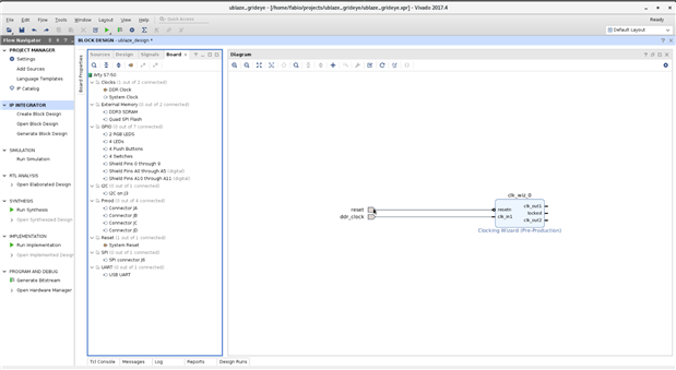

Step 1 - Clock setup: Add the DDR Clock and System Reset by selecting them from the "Board" tab, right-click on the selected item, and click on "Auto Connect". Customise the Clock block by double-clicking on it, and in Board tab select "Reset" for "EXT_RESET_IN", and in
"Output Clock" tab, select "clock_out2" and set 200MHz as frequency, then select "Reset Active Low" for Reset Type. Run the Connection Automation wizard, and accept all the defaults.

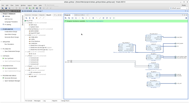

Step 2 - Add External Memory: Add the 256MB RAM and 16MB Flash external memory. This can be done by clicking on the "Board" tab, and selecting DDR3 SDRAM and QUAD SPI Flash. Right-click on the selected item, and click on "Auto Connect" in the popup menu. Manually remove the "sys_rst" port created by the wizard, and customise the DDR by doble-clicking on the "mig_7series_0" block. On the page "Memory Options" of the wizars, deselect the box "Select Additional Clocks(if required)". On the page "FPGA Options", select "Enabled" for "XADC Instantiation".image
Step 3 - Add I/O ports: Add all the external ports to the design. This can be done by clicking on the "Board" tab, and selecting the following I/O ports: 2 RGB LEDs, 4 LEDS, 4 Push Buttons, 4 Switches, I2C on J3 and USB UART. Right-click on the selected item, and click on "Auto Connect" in the popup menu. Customise "axi_iic_0", setting 400KHz as frequency in the tab "IP Configuration" tab. Customise "axi_uartlite_0", setting 115200 as Baud rate in the "IP Configuration" tab. Customise "axi_gpio_1", checking the box "Enable Interrupt" on the "Board" tab.image

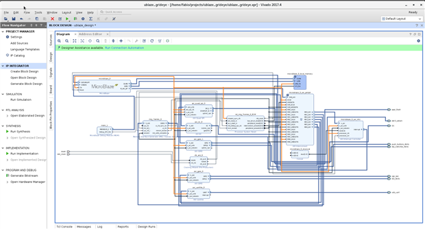

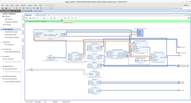

Step 4 -Add MicroBlaze: Add Microblaze IP from the IP Catalog, and customise it by running the Block Automation wizard. It is important to add local memory (128KB) and some cache (8KB) at this stage, so that the wizard will also create the BRAM blocks. We also want to select the "Interrupt Controller" checkbox, which will add an AXI Interrupt Controller block to the design (we will need interrupts to capture use input). For the clock connection, select "/mig_7series_0/ui_clk".image
Step 5 - Connect the blocks: Run the Connection Automation wizard to create all the connections between the blocks. For all the AXI related selection, just use the suggested default value. For the "mig_7series_0" clocks, choose "/clk_wiz_0/clk_out1" for  "sys_clk_i" (100MHz) and "/clk_wiz_0/clk_out2 " for  "clk_ref_i" (200MHz). Leave "sys_rst" unconnected. For the "axi_quad_spi_0" clock, select //mig_7series_0/ui_clk".image
Step 6 - Interrupt Setup: All the interrupt signals need to be connected to the interrupt controller. To do that, the "microblaze_0_xlconcat" needs to be customised (by double-clicking on the block), and the number of ports need to be set to 4. Then the interrupt signal from the I2C , UART, GPIO1 and QUAD SPI blocks need to be connected to the xlconcat block inputs. This completes the design of the hardware.image

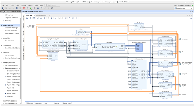

Couple of notes on the design illustrated above: you might be wondering why the "ui_clk" clock signal (81MHz), generated by the DDR memory controller, has been chosen to drive all the clock lines to the other blocks, when the board provides a 100MHz clock, or I could have used the 100MHz and 200MHz clock signal generated by the clock wizard block.
There are 2 reasons for it: the first is that the AXI slave interface of the DDR memory controller works with the clock generated by ui_clk, so no matter how fast the rest of the system is, this is were the bottleneck is.
The second I believe it is somehow related to the first one: when you drive the other modules using a faster clock, for instance a 100MHz clock, the implementation will report a negative slack timing failure for some of the paths. I haven't had time to investigate the issue, but I think to solve it I would need to introduce some registers in the failing paths, which basically translates into "slowing down" that path. Therefore, to play safe, my choice to use the slowest clock in the system as source for the rest.
The other comment is related to the input buttons and switches: I have not created a debouncer for them. There are plenty of ready made modules on the internet I could have borrowed to create the HDL source module to add to the system, but the design is already quite busy as it is, without adding further blocks. Moreover, when testing, I didn't have problems using them, so for the time being I will leave the debouncer circuit out (another item in my to-do list for the RTL implementation...).

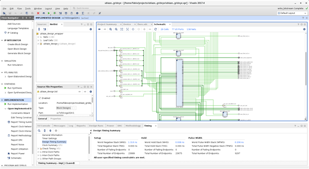

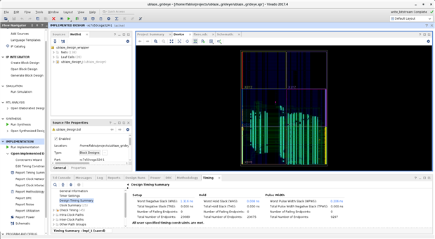

Clicking on "Run Synthesis" in the "Flow Navigation" window you kickstart the sysnthesis process. You can now sit back and relax, because the Synthesis step takes a good 15 minutes, when running on my computer, which is equipped with 8th gen Intel core i7-8550U, 16 GB of RAM and 512 GB of SSD HD.
On successful completion, you can start the Implementation process by clicking on "Run Implementation" in the "Flow Navigation" window. Again, the implementation won't take as long as the synthesis, but still will take another 5 minutes of your time.

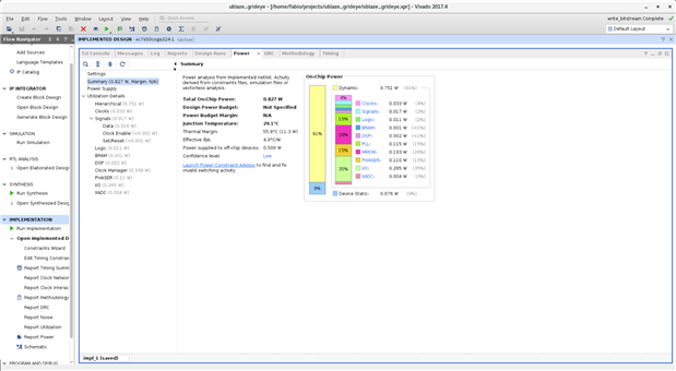

Once that completes without error, you can click on "Open Implemented Design" to access all the reports generated by the tools. There are lots of information, including timing reports and power consumption estimates (see the slideshow below), that you can drill down to gain insights on how your design has been mapped onto the FPGA fabric and how well it performs. If you click on "Schematic", you can also take a look at the actual RTL schematic created from your design. This is the place where you can find out about the details of each path and, if needed, for example make modifications to add a buffer or a register.
{gallery} Implementation Reports
Implementation Technology Schematic and Time Summary Report
Power Estimation Summary
RTL Schematic View

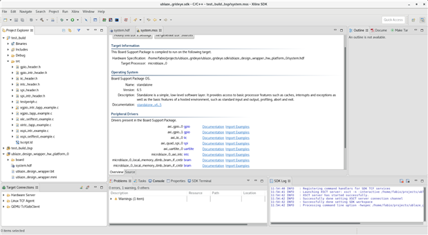

With the hardware design now complete, we need to test it on the board. Since we designed a system that, out of the box, does nothing, downloading the bitstream to the board, using the Hardware Manager, won't really give us any feedback on the quality of the build. We need to write some testing software that we can run on our system, than can show us the hardware works as expected.
This is where the choice of using a MicroBlaze-based design pays off: for such processor, we can leverage the nice integration between the Vivado tool and the Eclipse-based Xilinx Software Development Kit (SDK), which will create all the necessary framework for developing on the hardware we just implemented on the Spartan-7.

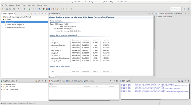

From the Vivado tool, clicking on "File->Export->Export Hardware", you will be presented with a dialog, asking you where to export the hardware definition files, and giving you also the choice to export the bitstream file . Exporting it to "Local to Project", will keep both the hardware project files and the software development files inside the root project folder defined while creating the Vivado project, which is useful if you want to keep the whole project self-contained.

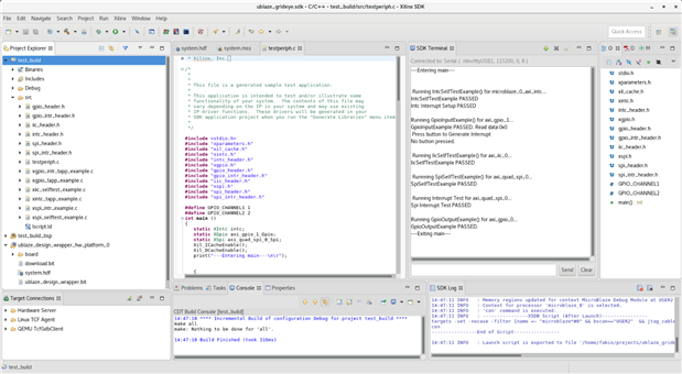

To start the SDK, from Vivado, click "File->Launch SDK", and the Eclipse-based development environment will open, and create the software support package for your hardware design. On opening, you will be greeted with the Hardware Platform Specification, which contains all the information about all the devices used in your hardware, and all the addresses where the memory-mapped devices can be accessed.

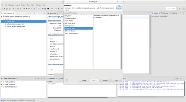

Let's  now create a test application, by clicking  "File->New->Application Project" from the SDK top menu. This will open the create project wizard where, besides the usual setting the name and location for the project, we can also select what kind of application we would like to create. It offers several project templates to choose from, to test our board, including the classic "Hello World" application (it writes the famous "Hello World!" string on the UART port). Although tempting, I prefer to test it with the "Peripheral Tests" application, which will run some tests on the hardware (LEDs, Buttons, Interrupt controller, etc), and reports back the results via UART.
The wizard creates the Board Support Package, which contains the software libraries supporting the board hardware the modules created in the FPGA, and the skeleton of the Peripheral Tests application.
Now, we can build our application, and run it on the Arty. The SDK can also download the bitstream to the board (this is why it is useful to include it when exporting the hardware from Vivado), so we can do that first, to make sure the Spartan-7 is programmed (assuming the board is connected via USB to the machine running the SDK).
Before running the application on the hardware, we need to connect the SDK Terminal tool to the UART of the board, so we can capture the output from the application. Alternatively, you can also use PuTTy or any other communication tool you are used to.
To run the application, select "Run As->Launch on Hardware" from the drop-down menu brought up by right-clicking on the top of the application tree in the Project Explorer window.
If all is OK, you should see an output from the Terminal, similar to the one below, and the RGB LEDs on the Arty should flash (once per colour).
