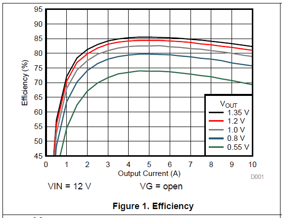

The datasheet of the TPSM84A21TPSM84A21 says shows the efficiency graph.
As in the image below, I've also measured with VG open.
Feeding a stable 5V to VG improves the efficiency with a few (2 - 4) %.

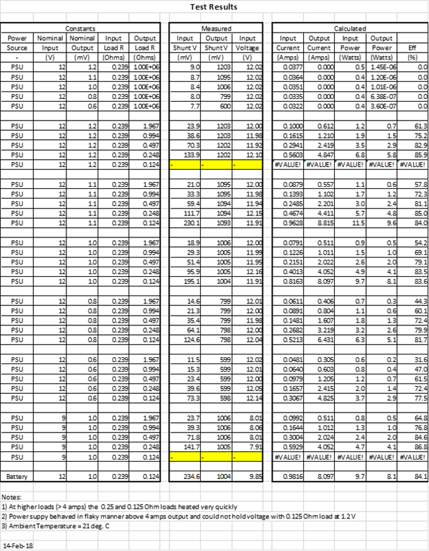

Road Tester fmilburn has measured efficiency on his kit, and posted that on his Road Test Review.
I'm reproducing his results without permission image.

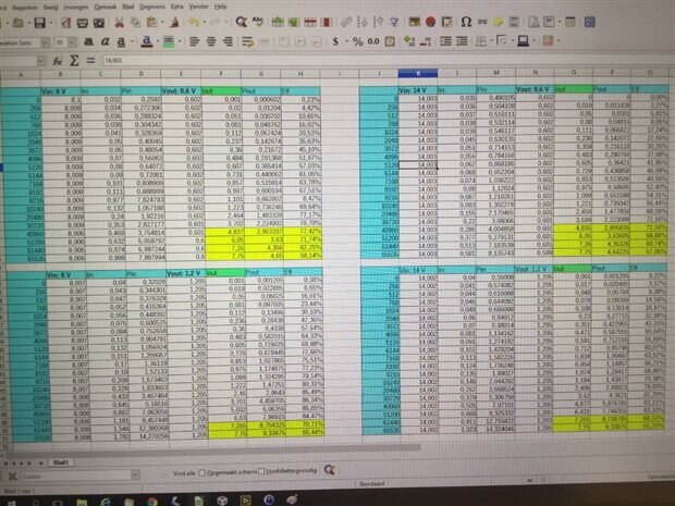

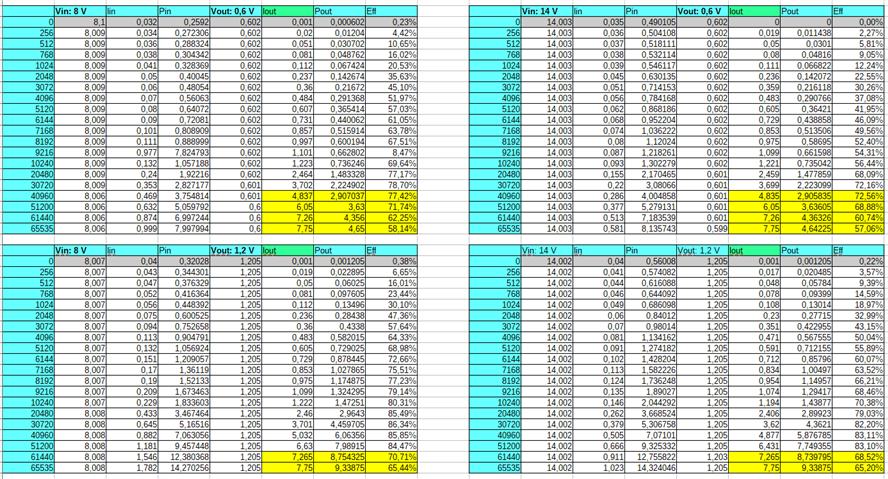

My Measurements
The datasheet and Frank's measurements show the switcher operating in the middle of it's input range, at 12 V*.
I've measured at the lower and upper range, 8 V and 14 V.
I've increased the current draw for 4 combinations, from 0 A to 7.75 A.
  • top left: 8 V in, 0.6 V out
  • top right 14 V in, 0.6 V out
  • bottom left: 8 V in, 1.2 V out
  • bottom right: 14 V in, 1.2 V out.
spreadsheet attached to this blog
Ignore the first few low range measurements. Too close to 0 to calculate a reliable efficiency.
The yellow coloured measurements are done with a non-calibrated current meter. Don't pin me down on those.
This is because the internal resistance of my DMMs limits what I can draw from the EVM at 0.6 and 1.2 V.

    For anyone who likes to see proper curves: I see what you mean about the readings at the higher currents.

    Jan, Nice update to your review. The data looks to match the specification quite well. Gene

    jc2048 wrote: I see what you mean about the readings at the higher currents. Yes. Those are measured by the DC load. It's obvious that I have to do more work to get reliable measurements. At this moment…
    Jan Cumps over 8 years ago in reply to Jan Cumps
    Jan Cumps  wrote:
    The dip in the blue line just above 1 A must be a typo when copying the readings of my meters - or another goof-up. I'll have to do that measurement again.

    Jan Cumps over 8 years ago in reply to jc2048
    At this moment it's barely hanging on to the ballpark figures for current measurement. Current set (not used here) isn't even close to ballpark yet image.
