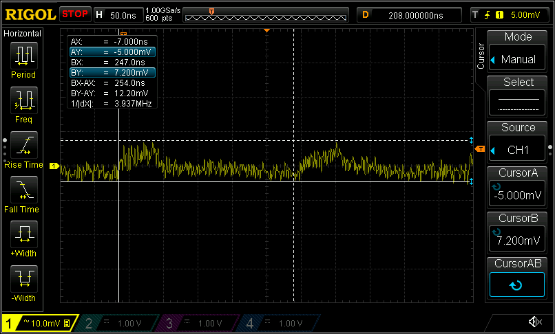

Test Conditions
I've chosen the highest input voltage aloud and the lower end of the output voltage.
The current is the maximum I can draw from the device with the tools I have.
  • VIN: 14 V
  • VOUT: 0.6 V
  • IOUT: 7.75 A

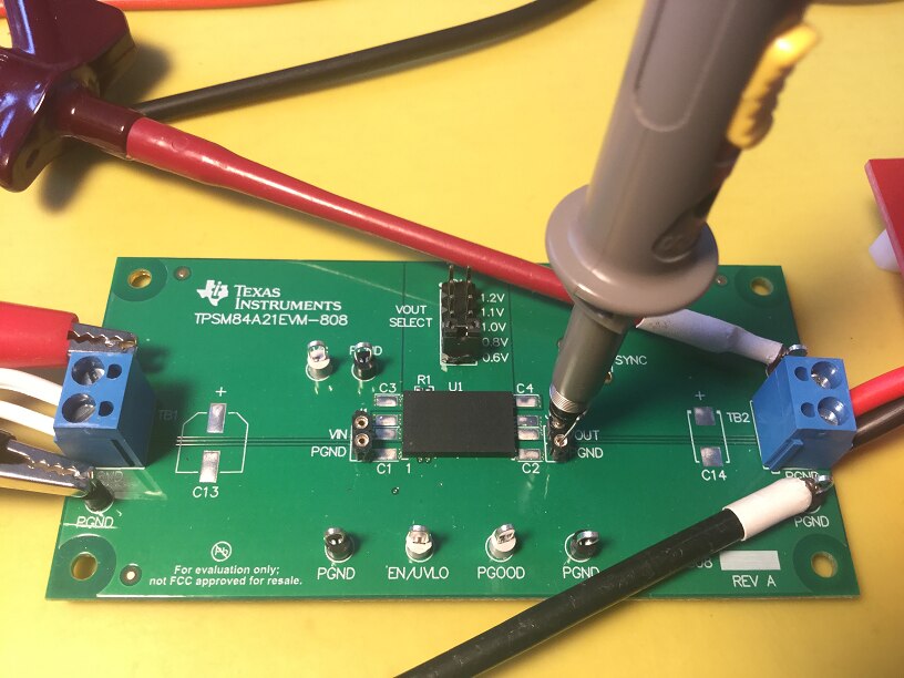

I've put an oscilloscope probe on the output, in x10 mode.

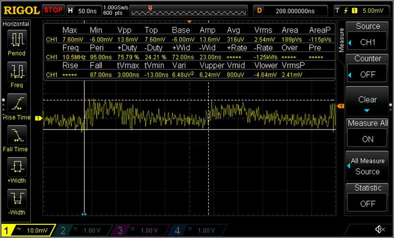

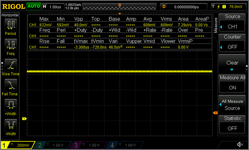

Measurements
DC 200 mV /DIV
AC 10 mV/ DIV, 50 ns /DIV

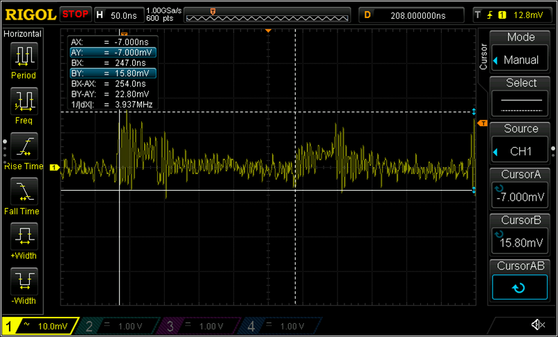

Cursors to show the switching frequency component of 4 MHz.
With 20 MHz bandwidth filter enabled - same as in the datasheet specifications.
I measure 12 mV without external caps, 14 V in and 0.6 V out, 7.75 A

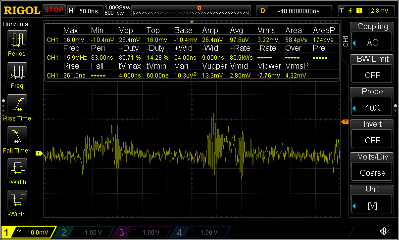

Same settings as in the datasheet, except the capacitors - 14 V in, 1V out, 1 A:
