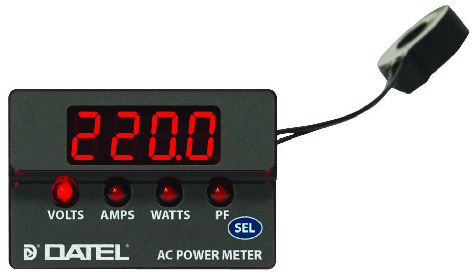

  • rsc
    rsc over 3 years ago
    I built one like that using one of these meters about 10 years ago and it still serves me well.
    When we take equipment out for field experiments it's nice to know startup currents/watts vs running currents/watts for solar power and other limited power supplies. My version doesn't have WiFi or Bluetooth however.
