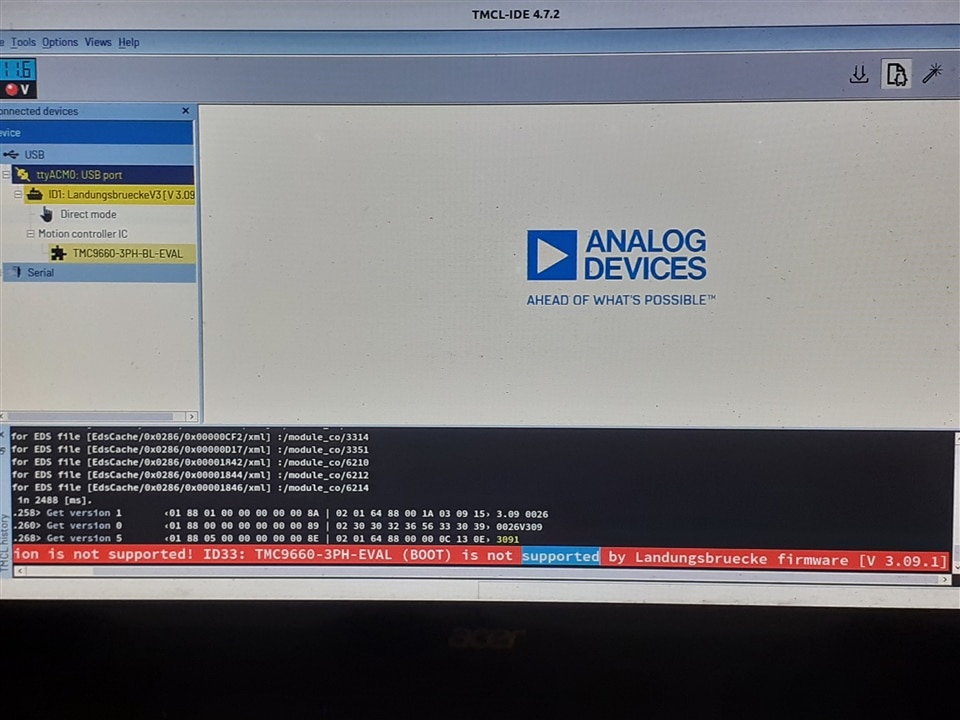

I am trying to install TMCL-IDE for windows. I am getting this error. Please help me in solving it.

    How to solve the error in red label.
  • cstanton
    cstanton 1 month ago in reply to manojroy123
    Do you want to share the full error message? It looks like it's cropped out on the right hand side there.

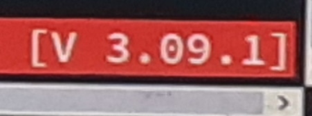

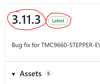

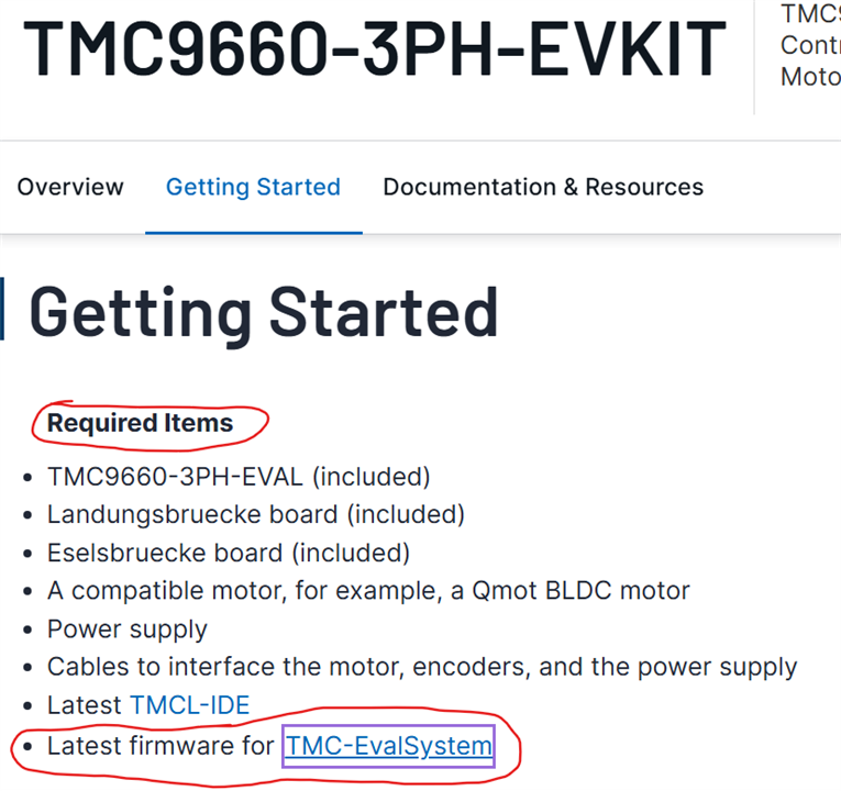

    beacon_dave 1 month ago in reply to manojroy123
    https://www.analog.com/en/resources/evaluation-hardware-and-software/evaluation-boards-kits/tmc9660-3ph-evkit.html#eb-gettingstarted

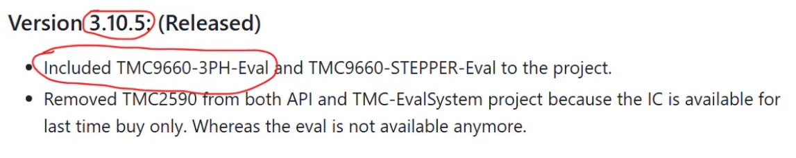

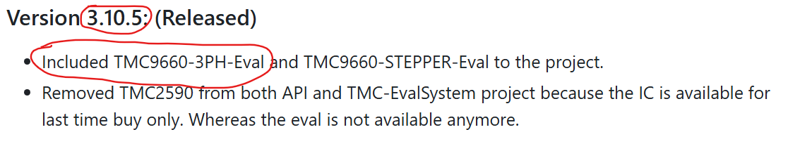

    https://github.com/analogdevicesinc/TMC-EvalSystem/releases?page=1
    Looks like you may have old firmware on the Landungsbruecke board that does not support the current TMC9660-3PH-EVAL board
    as it only appears to have been included since the v3.10.5 firmware
    How can I update the firmware of a Trinamic product?
    https://ez.analog.com/motor-control-hardware-platforms2/w/documents/18637/how-can-i-update-the-firmware-of-a-trinamic-product

  • beacon_dave
    Support for TMC9660-3PH-Eval only appears to have been added in V 3.10.5
    You need to update the firmware.

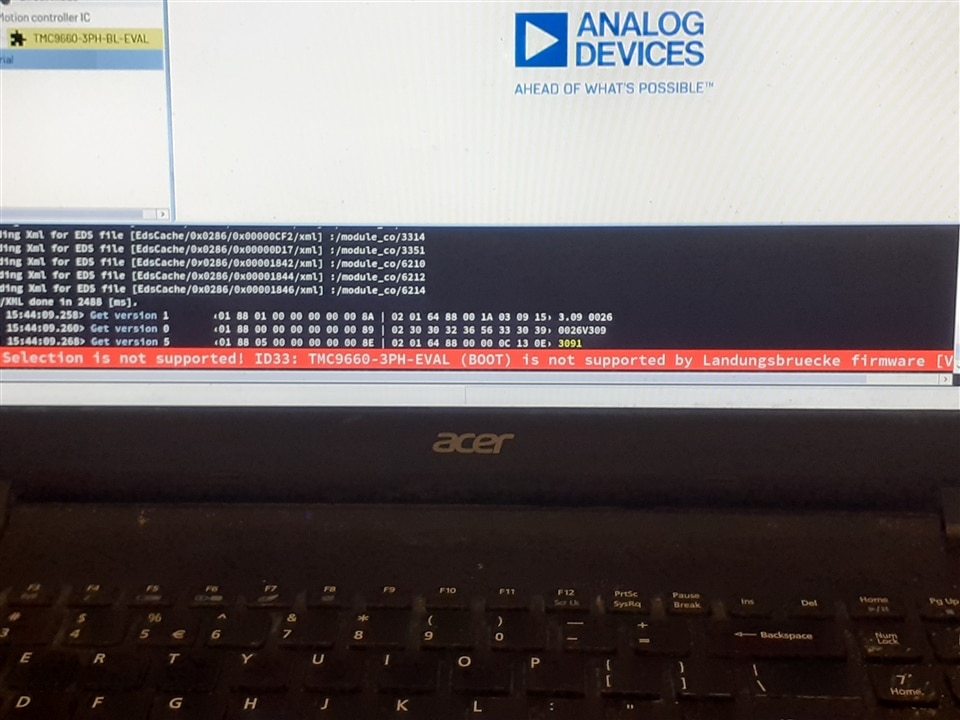

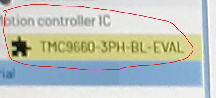

  • manojroy123
    manojroy123 1 month ago in reply to beacon_dave
    I have updated the firmware with LandungsbrueckeV3_v3.10.5_BL.hex but it is still not working. But it is not showing any error.
  • manojroy123
    Please help me in solving this error.
  • cstanton
    Hi Manoj,
    It looks like you’re hitting roadblocks at each step and immediately asking for the fix. That slows things down because the community can’t see what you’ve already tried, and it doesn’t help you build confidence in solving problems yourself.
    Here’s a better way forward:
    1. Work through the official resources first
    • TMCL-IDE software download & docs:
      https://www.analog.com/en/resources/evaluation-hardware-and-software/motor-motion-control-software/tmcl-ide.html
    • TMCL-IDE on Linux – setup guide:
      https://www.analog.com/media/en/technical-documentation/user-guides/how-to-start-linux-tmcl-ide.pdf
    • TMC9660-3PH Evaluation Kit page (with getting started guide):
    • Evaluation System (software + drivers + updates):
    2. Apply structured troubleshooting
    • Check your OS version against the requirements in the docs. (You've done most of this already)
    • Note the exact error messages (copy them and paste them in, don’t just post screenshots, especially where cropped).
    • Try the documented steps for your OS before asking.
    3. When you ask for help
    • State the product and version (board, TMCL-IDE version, OS, hardware if you're using anything additional).
    • Show what you tried, and the result.
    • Ask a focused question (e.g. “The Linux guide says to install dependency X, I did that but now I see error Y. What should I check next?”).
    The community is happy to support you, but you’ll make faster progress if you use these resources first and show what you’ve learned when you come back.
