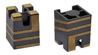

2.4GHz SMT On-ground MID Chip Antenna
  • Product Name: 2.4GHz SMT OnGround MID Chip
  • Protocol: BLE, BT, Thread, Wi-Fi, Wireless Hart, Zigbee
  • Type: Wi-Fi Antenna
  • Length: 3.00mm
  • Mounting Style: Surface Mount
  • Net Weight: 0.042/g
  • Polarization: Linear
  • Radiation Pattern: Omnidirectional
  • Thickness: 4.00mm
  • Width: 3.00mm
Click Here for More Information
Your thoughts about roadtesting these specific products would be appreciated. Thanks.

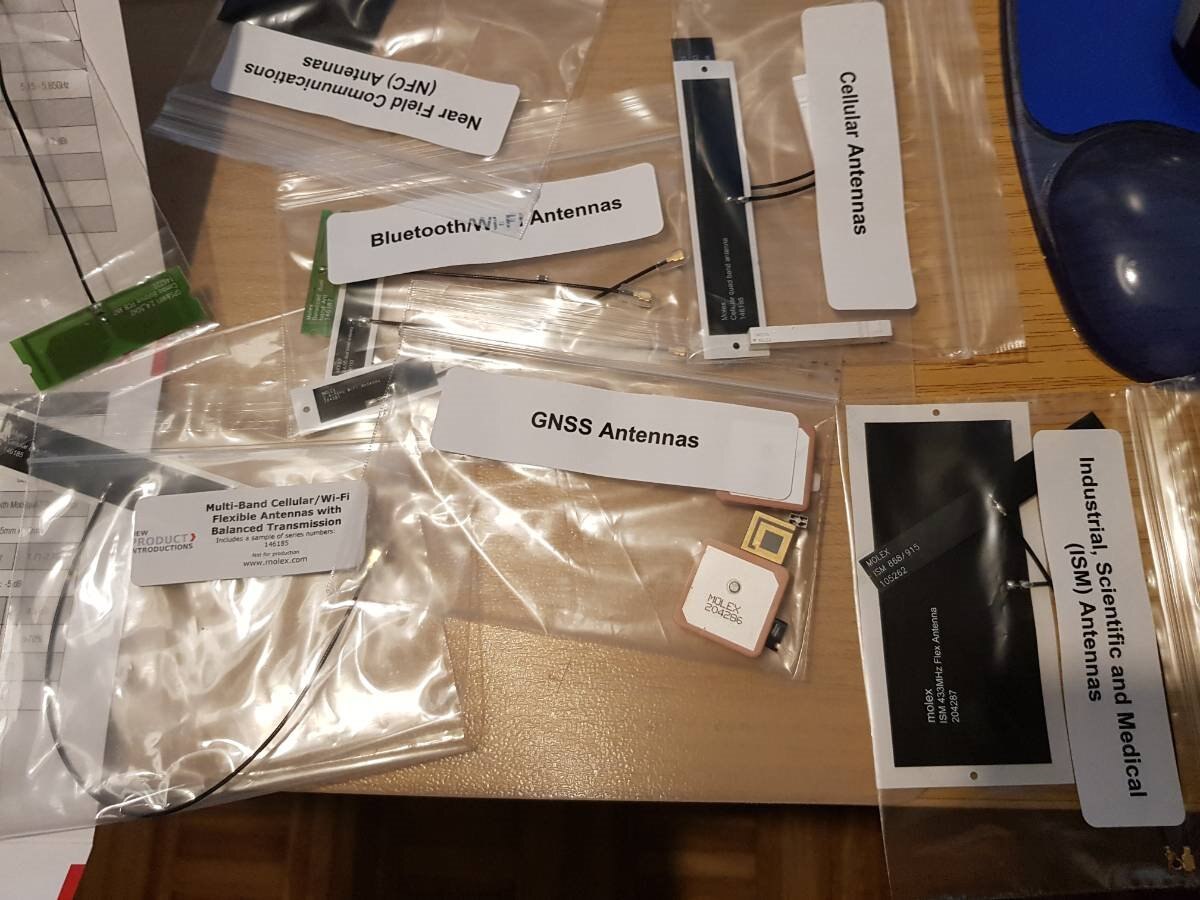

    I recently got my hands on Molex Antenna Sample Kit from Avnet.
    Although still I don't know what to do with them. image
    Any help would be welcome
