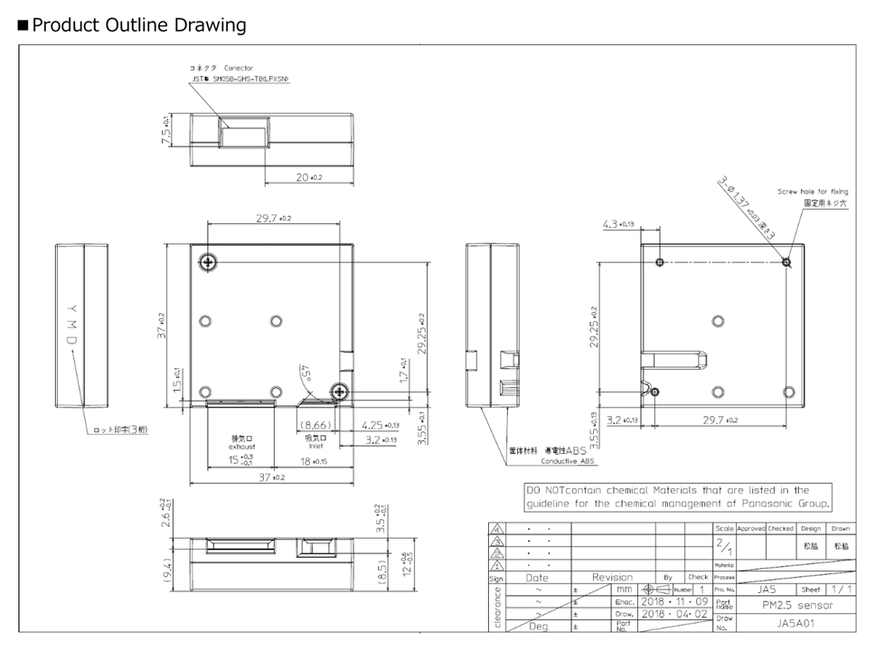

The sensor
The SN-GCJA5 square enclosure is a mere 37mm x 37mm and is only 12mm thick, making it the smallest PM sensor enclosure I’ve ever come across.
However, this enclosure appears to be missing mounting holes. It was not immediately apparent as to how one fixes the enclosure in place. The above diagram indicates 3 screw holes for fixing but two of those already have screws on the underside keeping the two parts of the enclosure together. The sensor documentation instructs the user not to remove those two screws. I did not attempt to use the 3rd screw hole in case it damaged the sensor.
By way of comparison, the larger Omron B5W-LD01 sensor does include mounting holes while the Sharp GP2Y1026 sensor did not, although it did have a ledge to hold it in place.

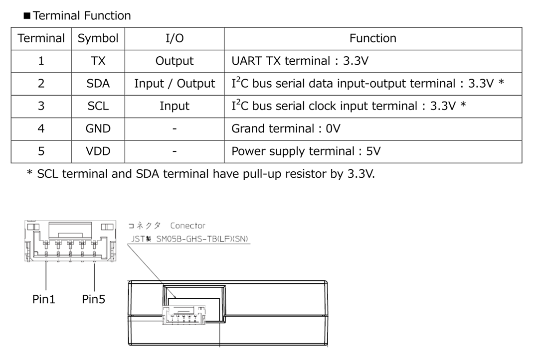

The connector used on the SN-GCJA5 sensor is a 5-pin JST (SM05B-GHS-TB) Wire-to-Board type connector with a 1.25mm pitch. As we all discovered, getting hold of a cable harness with this connector is hard to find at the moment as frequently distributors are temporarily out of stock.
This sensor is not the only one with a unique connector. The Sharp GP2Y sensor uses a 6-pin, 1.5mm pitch JCTC connector (11501W90-6P-S-HF) and the Omron B5W-LD01 sensor uses a 5 pin, 2mm pitch TE connector (AMP 292164-5).
The difference though is that with these two other sensors, it is easy to hack on your connector if you could not get hold of a suitable connector.
