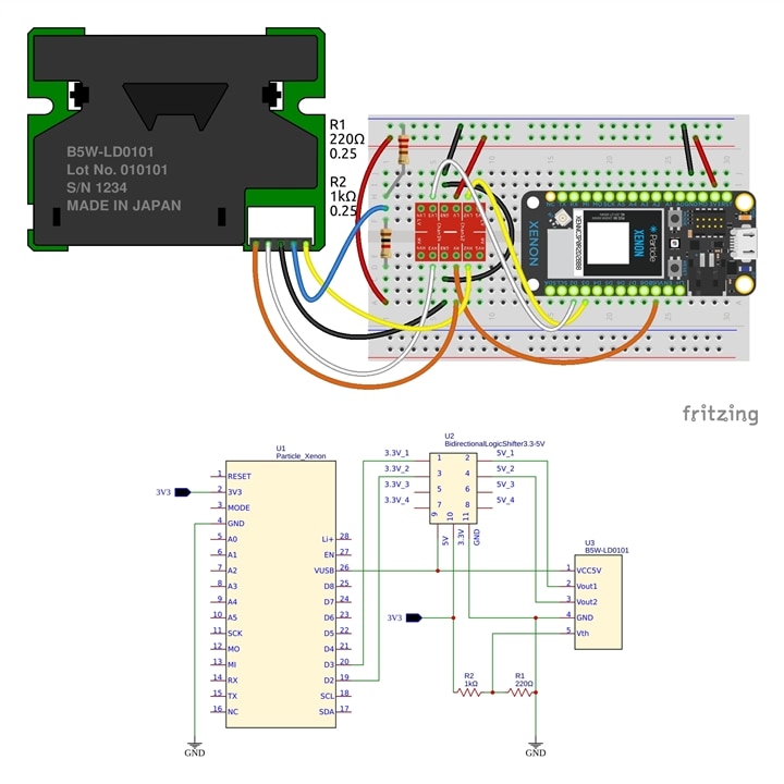

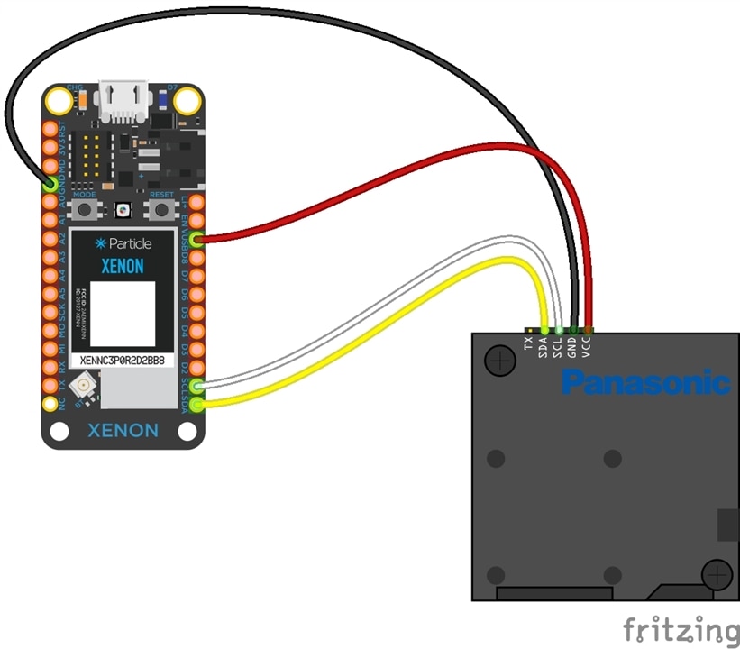

A BLE Feather Dust Sensor Node using I2C Interface
I’ll start with the I2C Interface and a single-file BLE library option using ble_app2.h (a copy of this header file can be found on my GitHub repository: https://github.com/Gerriko/mbedOS6_BLE_DustSensorNetwork).

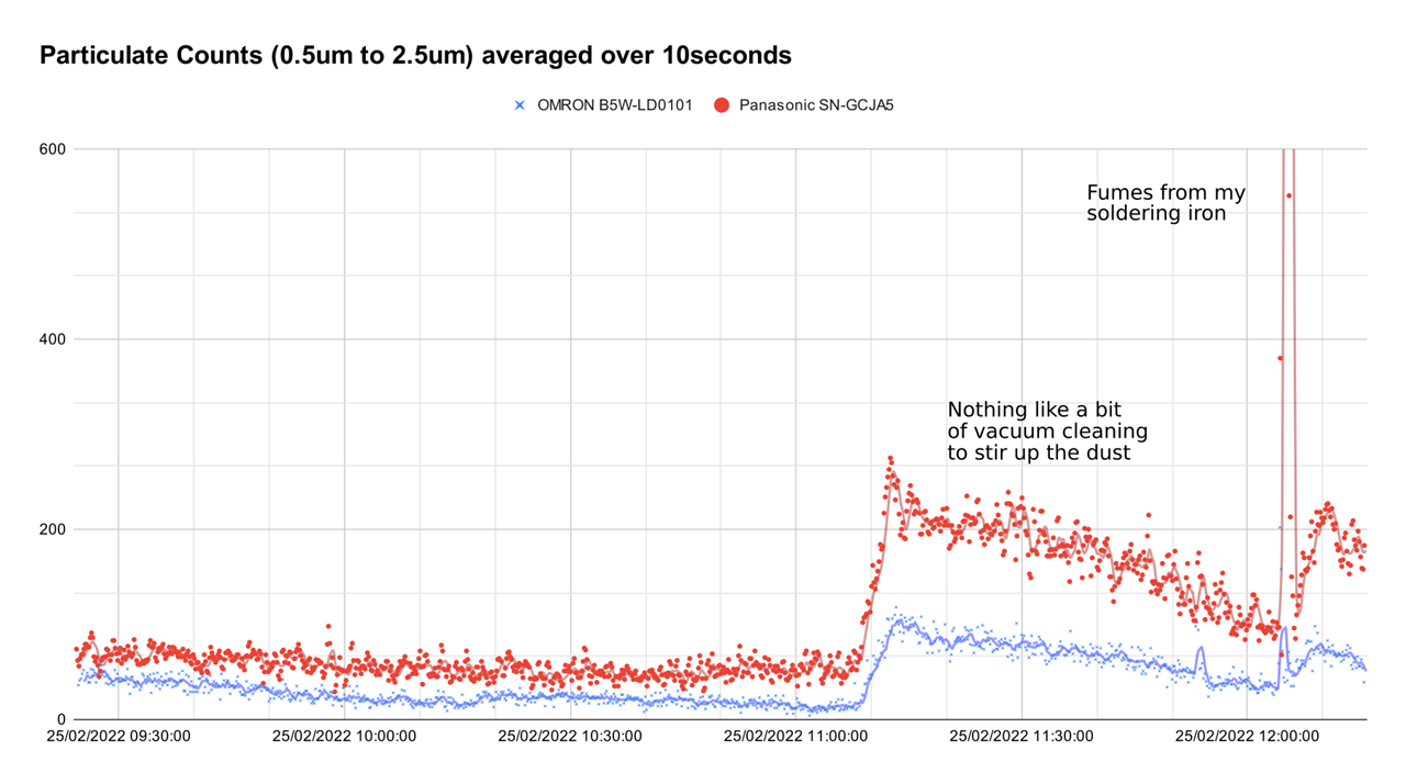

The dust sensor I’m using for this BLE node is the SN-GCJA5 Laser Type Particulate Matter (PM) Sensor from Panasonic Industries. This sensor can communicate either via UART or via I2C. For this project I am using I2C.
If you feel MbedOS is a little daunting, then I also have two getting started guides for those who would like to learn how to obtain data via UART or I2C using a 3V3 Arduino board:
/products/roadtest/b/blog/posts/getting-started-with-the-panasonic-sn-gcja5-laser-type-particulate-matter-pm-sensor-using-uart-ttl
/products/roadtest/b/blog/posts/using-i2c-communication-with-the-panasonic-sn-gcja5-laser-type-particulate-matter-pm-sensor
For this exercise, I am using an nRF52840 Bluetooth 5.x SoC. It just so happens that I chose an old Particle.io Xenon board for this demo as it is conveniently in the Adafruit feather form factor, which fitted nicely inside my test enclosure.
Note that this code project works equally as well on a Panasonic PAN1780 Evaluation kit or the Nordic Semiconductor nRF52840-DK board.
So to start my MbedOS project I first created a library for the SN-GCJA5 PM sensor.
This library contains both a manual blocking write, wait +500us & read method, and a non-blocking write+read transfer-callback method. I did not encounter any problems using either method.

A BLE Feather Dust Sensor Node using pulse counts
The second dust sensor node uses a B5W-LD0101-1/2 Air Quality Sensor from Omron.
According to the Omron product page(https://components.omron.com/us-en/products/sensors/B5W-LD0101-1-2) this sensor will detect particles down to 0.5 μm in diameter while using an LED light source. It is worth noting for future reference that this sensor will be discontinued with last orders on 31 March 2022.
The 5W-LD0101 provides two pulse outputs. One is for 0.5 μm or larger and the other is for 2.5 μm or larger. According to the data sheet, the number of pulses counted within the measurement time can be taken to be the sensor count. The minimum pulse width is 0.5 msec and it recommends using a sampling frequency of 4 kHz or more. For my application, I decided to use external interrupt triggers rather than polling at 4kHz.
Here is the pulse counting code:

Also worth noting that unlike the SN-GCJA5, this sensor communicates at 5V rather than 3V3 logic. Hence a logic shifter is used to interface with the nRF52840 MCU.
Here is a short test video of the UART output from periodic pulse count measurements using interrupt triggers on v1 and v2.

So here are the results from a couple of hours of automated data logging.

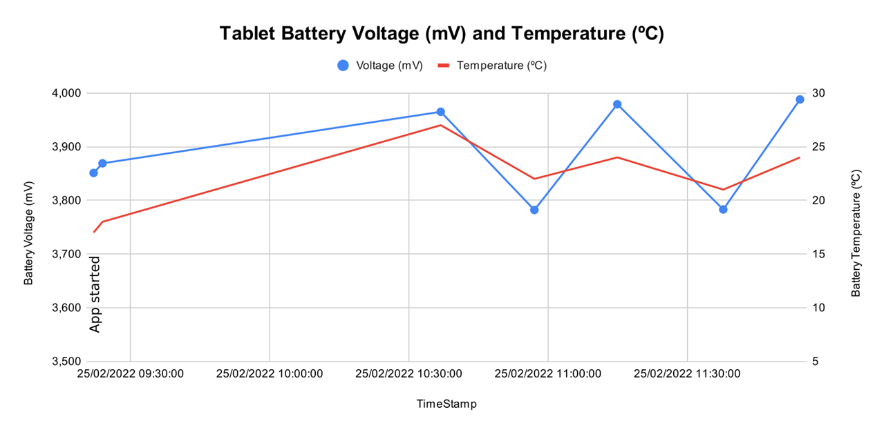

First I will start with the non-related battery monitoring. Basically, the smart dust hub app monitors charge percentage and allows charging when battery is below 50% and stops charging when battery charge reaches 55% (these values can be altered by the user). Battery charging will also stop if the battery temperature exceeds 28 degrees. The app then sends the changeover charge/discharge & discharge/charge events to the Google cloud.
This chart plots the battery voltage and temperature over time.
Now onto the dust data. Unfortunately, I did not have a means to calibrate the two sensors so I have no idea which absolute value is correct. What the data does show is agreement on the degree of change, especially with smaller particles so I am quite pleased with the test results.
