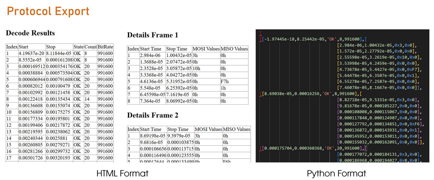

Memory Depth, Logic, and Serial Bus Decode
    Debugging Software and Protocol Stacks

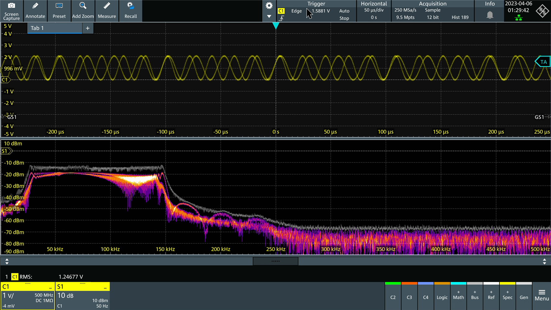

The spectral analysis is pretty phenomenal. The MXO 4 doesn’t seem to perform just a normal FFT; instead, it might be using a CZT algorithm, but I’m purely speculating. All I know is that I’ve never seen this kind of performance from an oscilloscope or a traditional sweep spectrum analyzer. Saying that it is speedy still doesn’t really do it justice; check out the video to see it for yourself.
The spectral analysis isn’t a nice-to-have thing; it’s an essential thing for oscilloscopes, and especially with the MXO 4 because it extracts considerable use from that low-noise front end and the high-resolution ADC. The spectral analysis is necessary for a deeper examination of signals because it can use “processing gain” to pull out signals that are impossible to see from the normal time-domain view. ‘Scopes are under-used if the spectral analysis capability is not used. However, older ‘scopes do not make it easy.
Examining Power Supply Noise Spectrum
To investigate this, I connected up what I hoped to be a low-noise power supply to see what I could see.
Incidentally, at this point, I wanted to attach the probes to the test bed in a better way than using a long ground lead. It would be handy to have a way to convert the ‘scope probe to attach to 0.1” header pins. By coincidence, the probes seem to plug perfectly into 2.5 mm headphone jack sockets! A couple of crimp sockets were soldered to the socket, and then some polydoh can be used to secure it (or epoxy glue can be used). This solution applies sideways pressure on the ‘scope probe tip, but it doesn’t seem excessive, and it did not bend the tip. Please don’t blame me if you try it and it doesn’t work out well! The proper method is to purchase a probe accessory kit because it comes with a cylindrical attachment that will not apply sideways pressure as the jack socket does.
With hindsight though, I should have just used an SMA connector and capacitor in series for this particular test. Anyway, at least I now have a DIY adapter for the times when a higher impedance is needed!
The spectral view is very easy to configure; the span and bandwidth can be entered in a way similar to a dedicated spectrum analyzer, and a very fast spectrum view shows up. Peak markers can be switched on, and they very rapidly track the frequency content. Power levels can be measured, but in this case I was using the passive voltage probe and I was interested in amplitudes, so the vertical axis was set to dBuV. Seeing frequency content poking out above the approximate 10uV RMS (in this example) noise floor was effortless!
Now I could try to improve the supply, and it was immediately observable what effect a ferrite would have on the supply connection.
Within minutes I’d narrowed down the problem to the power adapter, and by swapping that out (it was an old Fairway Electronics AC-DC power adapter, and I replaced it with a Meanwell one) and adding a ferrite, I’d reduced the switching harmonics to content almost in the spectral view noise floor.
It is just as easy to peek into tinier segments of the RF spectrum; the screenshot below shows the spectrum from DC to 1 MHz; perfect for fine-tuning all manner of circuits for low noise!

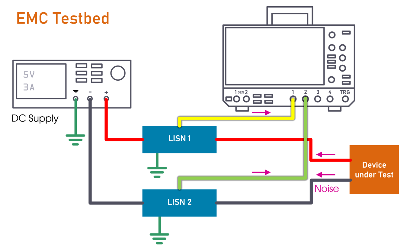

Conducted Emissions Testing
The testbed that I used is shown below.

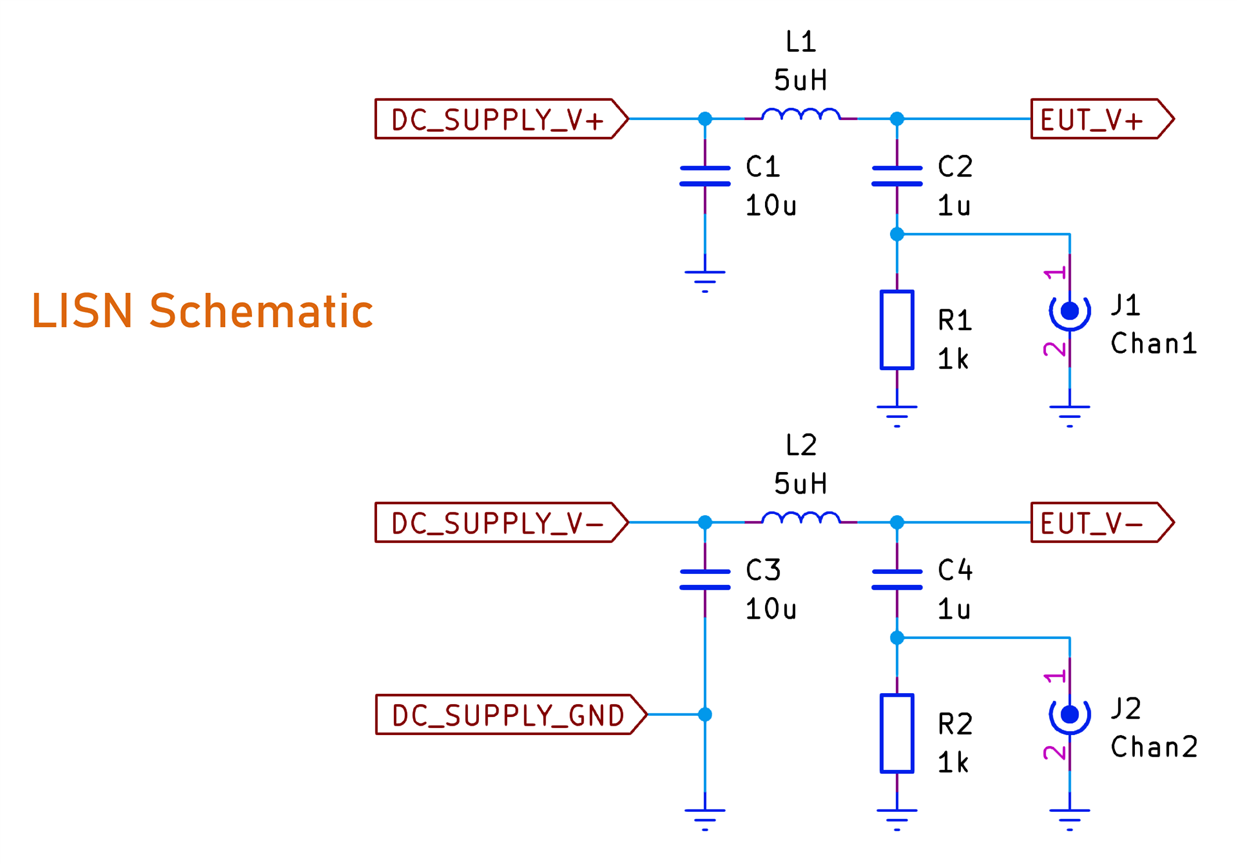

For measuring conducted emissions for any circuit/device-under-test, a test component called a line impedance stabilization network (LISN) is needed to isolate the variability of the power source from the signal levels that the MXO 4 will see. I used a homemade LISN pair, in a non-ideal environment, to see if it is even feasible. This minimal circuit that I used is part of standards but is replicated all over the Internet with various slight modifications, in particular, additional circuitry is often added to protect test equipment from transient voltages. In brief, the noise path from the device under test is through the connectors J1 and J2.
As suggested above, it would be preferable to dedicate space for such testing, with the equipment and physical setup as laid out in standards, so that tests are repeatable. There are IEEE and CISPR standards that explain all this; it can get pretty involved to set it all up, as the example diagram below shows. I did not use a proper EMC bench setup. However, as can be seen further below, there is a lot of value in even a non-ideal setup since not everyone has the space for a permanent EMC testbed.
 (Image source: Academy of EMC )
For now, my minimal setup was sufficient to explore if the MXO 4 could be usable. I was impressed! It was great to see the MXO 4 allows for spectral analysis on maths channels as well as the normal oscilloscope channels because this is very handy for separating the common-mode and differential-mode emissions using a simple formula.
The constructed LISN is shown below. I used 20 turns of 0.7 mm enameled wire (22 SWG or 21 AWG) wound around an 8 mm drill bit to make the inductors. It was taped inside a biscuit tin for shielding.
For the device-under-test, I used a Raspberry Pi 3B attached to a capacitive touch display. Next, the outputs were observed on the MXO 4 with the power supply switched off, and it was possible to see the importance of equipment and wire placement to minimize the noise. Since I didn’t have a metal ground plane, I placed the LISN (in its M&S biscuit tin) on top of the metal power supply chassis, connected to its ground, and then placed the Pi + capacitive display on top of the metal biscuit tin : ) (This kind of pyramid of equipment, which works well in small spaces, I’m calling the shabaz ground pyramid EMC test method : ) The spectrum display with the power off was saved as a reference trace, and then the supply was switched on. I was expecting to see both differential-mode noise (for instance from DC-DC converters on the Pi and display board) as well as common-mode noise since there are plenty of high-frequency clocks and signals on the boards, which could couple to the ground. The common-mode noise can be seen by summing the two channels.
In a similar fashion, it is possible to see the differential-mode noise by subtracting the two channels. This is great, but ideally we want to see what sort of margin there may be compared to standards. This is done using limit lines that need to be applied against the spectrum output. If the output exceeds a limit line, then the device-under-test fails compliance tests.

The response above was captured with the Bass control set to a minimum. By increasing the level of the Bass control, I could see the frequency response change (the y-axis gain scale is different in each of these screenshots):
Here’s the results with the Bass increased a little further, and the Treble control backed off a small amount, to get a reasonably flattened response to with half a dB or so (i.e. within about 5%):
The above was great news; the circuit seemed to be behaving, and more importantly, it had been confirmed that the MXO 4 remote control/programmability with Python code was a good method to use to capture and process results for any future circuit too. I now felt confident the instrument could be used for a variety of work, reliably generating signals and capturing data.

The data table can be navigated with a mouse to quickly check if the data looks about right, and then the entire data can be exported in 4 different formats, including XML and CSV. I found myself regularly using the HTML format since it was so quick to browse what was going on, and I liked the Python format for post-processing.
The Python-friendly format is extremely handy if you wish to do performance profiling of the protocol stack, or even for comparing captured data with a test dataset. This would be useful for spotting issues that might not be normally noticeable in some regression testing, for instance, if delays change slightly due to added code between software releases. A few dozen lines of Python code were sufficient to read the data captured from the MXO 4, and plot latency between data bytes across the SPI bus. I could immediately see where software development effort should be best expended to improve the speed of the file system. For instance, the chart below shows the timing for a file write operation (the operation wrote just two lines to a file!). More than 1800 bytes of SPI data were transferred to perform that high-level operation. Looking at the chart, it is clear that a large part of the time is spent polling. Hovering on any part of the chart with the mouse shows the MISO and MOSI message exchange at that point in time, along with the frame number so that it can be directly correlated with the decode table displayed on the MXO 4. The polling may be related to the Flash speed, however the initial first 17 milliseconds or so of the file write operation, when most of the 1800 bytes of the operation were transferred, could potentially be sped up with a faster SPI data rate and perhaps packing more than 20 bytes into a frame if possible, because from the chart it appears to be a hard-coded limit somewhere in the file system code.
The code is on GitHub; it accepts the SPI data saved by the MXO 4 in Python format and builds the chart with the content. I’m not entirely happy that I have the best chart design for examining SPI timings, I think it is possible to do much better. However, the chart is still a good start for understanding what is going on; I would never have known what the file write operation looked like in this detail otherwise. Going from thousands of data bytes and narrowing down to specific ones to see things like polling is now a breeze.
