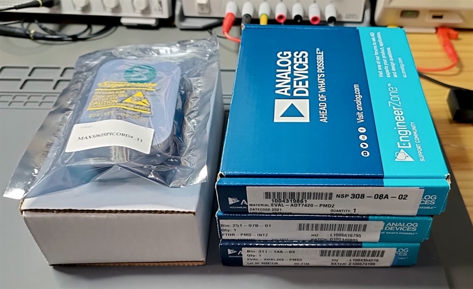

A stack of boxes on a desk. On the left there's a white cardboard box containing the MAX32650 Feather board, and on top the MAX326325 Debugger. To the right there's 3 blue cardboard boxes containing the Feather to PMOD adapter, the accelerometer and the temperature sensor boards

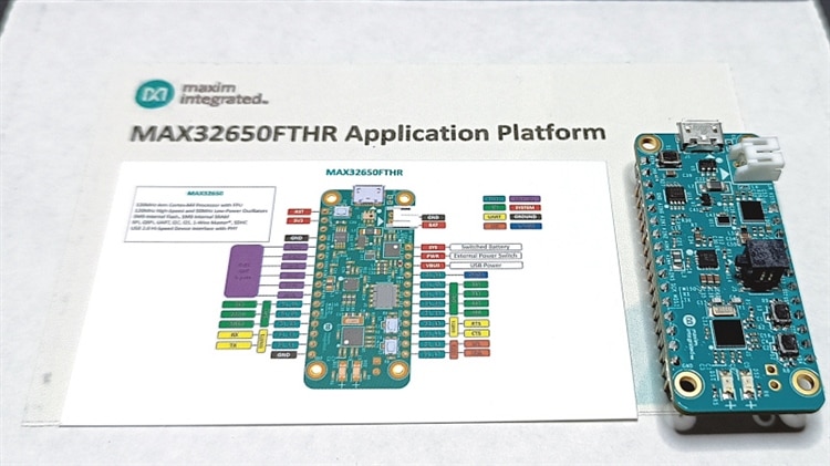

The MAX32650 Feather board sitting on top of its own box, next to a small card describing the pins
MAX32650FTHR Eval board
  • Compatible with Adafruit’s Feather specs.
  • On-board 6-channel 24-bit ADC capable of 16k samples per second.
  • Battery connector and charger circuitry to operate from battery.
  • Micro-SD Card slot.
  • MAX32650 microcontroller:
    • ARM Cortex-M4 architecture. 120 MHz, with plenty of lower-power modes and oscillator configurations.
    • 3MB flash memory and 1MB internal RAM.
    • It also supports memory expansion through several interfaces with fast DMA capabilities
    • USB 2.0 Hi-Speed interface.

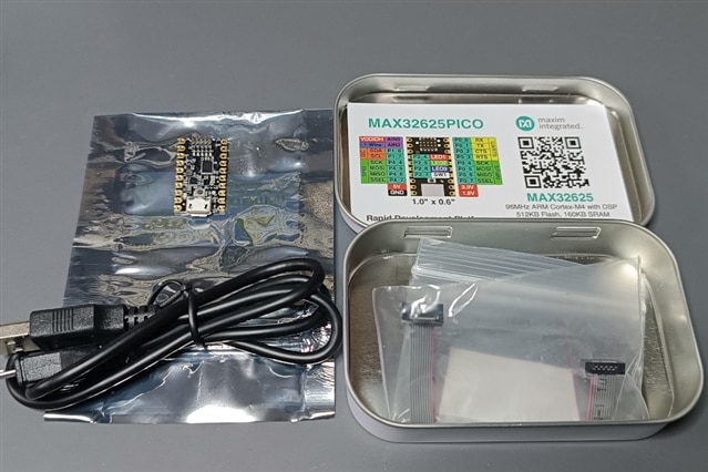

The tin can where the debugger comes in, opened, showing a small printed paper card with the pinout, and the debugger itself on top of its antistatic bag
MAX32625PICO JTAG debugger/programmer
  • Extremely small footprint.
  • Can be used as a development platform (thanks to its MAX32625 micro), or as a debugger for other boards (as it'll be used here).
  • Can boot as a storage device for directly updating its firmware, or uploading binaries to a target board.

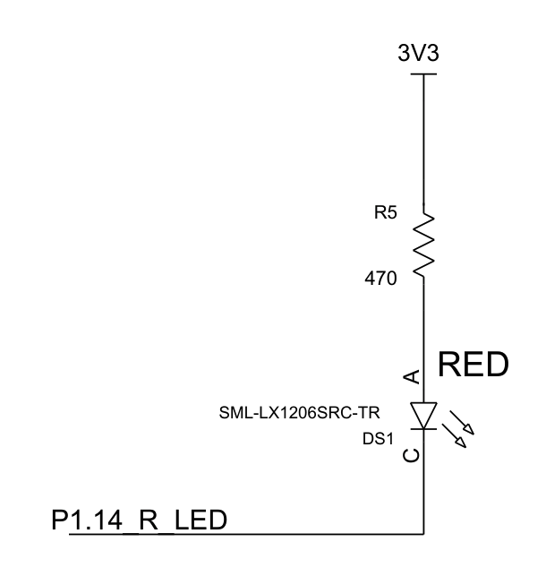

Here’s where I found my first real hurdle. I wanted to perform a power consumption analysis of the processor with different clock configurations, but the many ICs on the board make that task almost impossible. There’s a couple of voltage regulators, a battery management IC, a voltage reference, the ADC, etc, and they will all draw current or have power losses.
While I can’t directly measure how much power is used by these components, I spotted another "leak" of current; The red LED on the board was kept very faintly ON, even when in its OFF state. Apparently the pin connected to it remains f̶l̶o̶a̶t̶i̶n̶g̶ (EDIT: "floating" doesn't seem to be a good description for the actual situation here. It has been pointed out in the comments that on top of VDDIOH (~3.3V) there's also a VDDIO voltage for GPIO pins of 1.8V, and this pin seems to be kept at that level), and the voltage across the diode (1.52V) is just enough to light it, albeit very dimly.
I checked with a scope, and there was no oscillation at the pin, so estimating its power consumption was technically straightforward. Using ohm’s law I got 3.25mA through the LED, so we can subtract that number from future current measurements.
But that’s the only part of the power consumption I could isolate with some degree of certainty.

  • Agreed. measure voltage across R5 and divide by 470 to get the current. This may  help to work out why there is any current.
    MK
  • If it is the case, you can pretty accurately exclude parasitic current becase voltage on LED terminal is deterministic and stable (not floating). Basicaly measure voltage drop on resistor (which is known=470ohm) and pass it to ohm law.
  • Here is schematic of LED connection:
    I think there is different problem.
    Floating pins (Hi-Z) do not allow source or sink currents except leak insufficient to lit LED (even lightly). But Maxim MCU supports powering individual GPIOs by two different supply rails VDDIO (typicaly 1.8V) or VDDIOH (typicaly 3.3V). I think pin is correctly configured as output, but incorectly configured as VDDIO mode instead of VDDIOH. So when GPIO is set HIGH it is set to 1.8V, which makes voltage drop 3.3 - 1.8 = 1.5V on resistor and led which make it bright lightly. When it is set to LOW, there is full 3.3V on LED and R.
    You can check it by measuring voltage on LED. I guess on one terminal you measure exact 1.8V and on other something higher between 1.8 and 3.3V.
  • You said:
    While I can’t directly measure how much power is used by these components, I spotted another "leak" of current; The red LED on the board was kept very faintly ON, even when in its OFF state. Apparently the pin connected to it remains floating, and the voltage across the diode (1.52V) is just enough to light it, albeit very dimly. I checked with a scope, and there was no oscillation at the pin, so estimating its power consumption was technically straightforward. Using ohm’s law I got 3.25mA through the LED, so we can subtract that number from future current measurements.
    I'm not quite sure that this is correct - ohms law does not apply to LED s - the current through them is not a linear function of the voltage across them. I'd expect the current through a dimly lit LED to be a lot less than 3.25mA.
    Perhaps you could copy the section of the schematic with the LED on it so we can be sure we are not at cross purposes here.
    Thanks.
