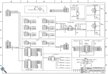

The sensor shield uses the Arduino Uno form factor and Arduino sketches compatible with the Arduino Uno are provided for all the sensors in the kit.  Not only does this make for easy demonstration of the sensors, it is helpful for porting to other microcontrollers.  The sensors come on individual PCBs approximately 20 x 20 mm (.79” x .79”) with male pins on 0.1” spacing.
I found a schematic for the sensor shield but it is too small to be read and it was not clear how to use all of the jumper settings.  Jan Crump has clarified this in his a post.
There are four sections to place modules on the sensor shield (two analog, 1 digital IO, and five I2C).  There are many jumpers provided for setting voltage, and interrupts – most are not used in the directions provided.  As an example setup, in the photo below the heart rate sensor is in the I2C section and the voltage jumper is set to 3V while there is a flying jumper to 5V from the module to power a LED on the module.  The pressure sensor has been placed in one of the I2C locations.
The jumpers settings prescribed in the instructions are noted in the individual sensor sections. This is a minor criticism but my personal preference would be for all sensors on the same 3V setting.  The one 5V sensor appears to have 3V3 equivalents in the ROHM catalog.

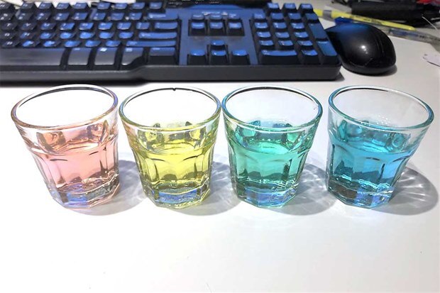

I plan to pursue how the sensor performs when reading a backlit liquid sample.  This is not ROHM’s intended application so the results will be experimental and will not be used to check the datasheet.
For the experiment 4 samples were mixed (red, green, blue, and yellow) of food coloring (McCormick food and egg coloring) in water (1 drop in 500mL). image
The initial experiment was to determine how the color sensor distinguishes backlit liquids in these color concentrations.  Each sample was illuminated by a small LED flashlight with the color sensor on the other side of the sample and covered with a paper dish to shield it from the computer monitor.  The lab lights were turned off.  In the photo below the yellow sample is being tested.
The raw results are shown below.
A typical response for each color is given in the table below.
Sample
Red Response
Green Response
Blue Response
Red
2104
5027
4088
Green
815
6986
3677
Blue
874
6701
5300
Yellow
5048
19265
4657
There is clear differentiation in the samples and these preliminary results are promising.  The concept will be pursued further in the buoy project.  It is hoped that turbidity can be measured as well as possibly detecting red tide and other environmental conditions.
