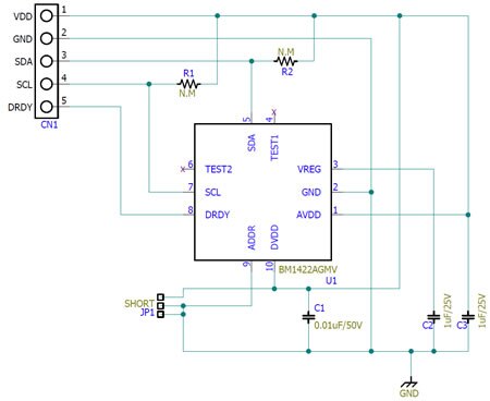

Evaluation Board
This tiny PCB contains the sensor, required bypass capacitors, optional footprints for i2c pull-ups and a jumper to change the address of the sensor.
The sensor comes in a QFN  package.
The datasheet does not explain the physical constructions.
But it's safe to assume that there are 3 sensors on board. Each physically mounted in one of the 3 axis.

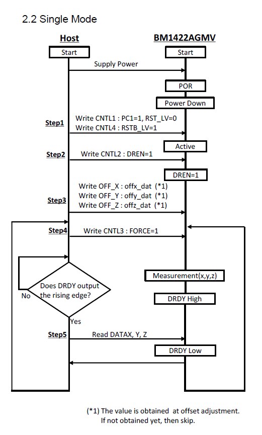

What surprised me is that the example available from the ROHM website is better than what's on github.
The downloadable one supports a trigger when data is available from the magnetometer.
That's a useful demo for this device and it is interesting for Arduino education.
The Software registers the trigger, and based on the mode of the device attaches that trigger on the falling or rising edge.
image source: BM1422AGMV datasheet

  // Step4
  reg = BM1422AGMV_CNTL3_VAL;
  rc = write(BM1422AGMV_CNTL3, &reg, sizeof(reg));
  while(_drdy_flg == 0) {
    delayMicroseconds(100);
  _drdy_flg = 0;
  rc = read(BM1422AGMV_DATAX, data, 6);
  return (rc);

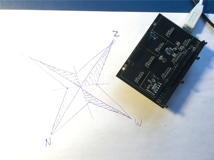

A few measurements, first flat on the table, with the text on the sensor PCB facing:
North:
BM1422AGMV XDATA=1.208[uT]
BM1422AGMV YDATA=-0.375[uT]
BM1422AGMV ZDATA=-76.875[uT]
South:
BM1422AGMV XDATA=-26.333[uT]
BM1422AGMV YDATA=-24.333[uT]
BM1422AGMV ZDATA=-79.417[uT]
East:
BM1422AGMV XDATA=-28.917[uT]
BM1422AGMV YDATA=-4.042[uT]
BM1422AGMV ZDATA=-80.917[uT]
West:
BM1422AGMV XDATA=1.333[uT]
BM1422AGMV YDATA=-26.708[uT]
BM1422AGMV ZDATA=-78.083[uT]

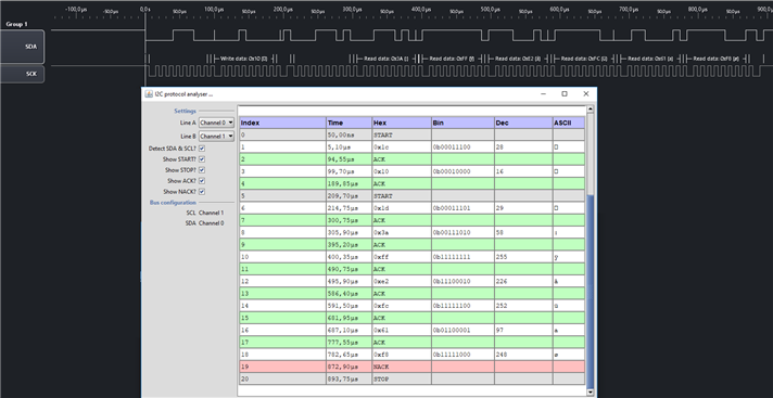

i2c Traffic
I've captured the traffic of a measurement sequence. Here you can see the effects of the following lines of code:
It generates an address write, then 6 blocks of char size data returning.
You may recognise this address on line 3:
#define BM1422AGMV_DATAX              (0x10)

    Have you tried to calibrate out hard and soft iron interference? Because from your data it seems there is some present. If you are in Belgium you should be getting total magnetic field of around 49 uT…
    Jan Cumps over 8 years ago in reply to kulky64 +3
    There is an iron molecule in my neighbourhood
    Jan Cumps over 8 years ago in reply to DAB
    DAB  wrote:
    Nice post Jan.
    Have you done any sensitivity testing to see how accurate the device is to tell direction?
    DAB , in the comment above I tried to dial in to the magnetic north, following kulky64 's instructions - keep the sensor horizontal and try to get the Y be 0.
    This after non-optimal but good-enough-for-this-exercise calibration.
    It's very sensitive. I could not dial in to Y==0.000 by manipulating the Arduino. It only worked by using the USB cable as a long tail. That allowed me to very slightly pivot the Arduino until Y == 0.000.
