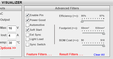

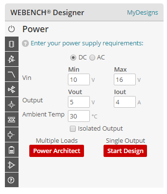

For any engineer developing a product the need to come up with a design that is constrained by the specification set. Webench is a tool I use a lot. With a very simple starting section plugging some data into Webench front page then submitting opens an online GUI with numerous suggestions. After getting the open selection screen, I wanted the Integrated solution for relative design ease and then finally narrowing down necessary option the the TPS54424 came on top. To understand I wish to create a power supply circuit to power a Raspberry Pi with voltage monitoring and an enable pin to switch it on and off when necessary.
The beauty of Webench is the simplicity to start with, just a few parameters to get started and a stream of option come up. The process is simple and for the project sorting the most important specification for the project narrowed down several components that would be more relevant.image
Initially Webench can be daunting at the beginning but after few attempts getting the best solution was really easy to narrow down the preferred parts with ease.
All the negative aspect with ease of use initially, Webench is a fabulous tool that allowed me to precisely narrow down my search to only a few parts with TPS54424 being one of them. The result selection was a competition between a few TI components. As I was ready at the time to order parts the Road Test came along at the right time.
For more experienced users of Webench the narrowing down of the right product will become easier and in my case the review allowed me to spend some time on manipulating information to get the best product in minimal time. Further more I hope in the near future use some more advanced tools to improve the design process. This is an essential tool for engineering a solution, I highly recommend it.
Webench design tools
Once the search has been completed the next stage for me is to ensure the most important factors are there. One my major design constraints for my project is efficiency. This will be a purely off-grid project. So I require to get the most efficiency for the project while maintaining very high regulation for the Raspberry Pi.image
I could have spent a long time carry out simulations within LTSpice or TINA, but instead WEBENCH offers a much quicker simulation bench than I would have expected to do outside the reference tool. A good indication initially was the sorting for efficiency in the initial search.
Therefore WEBENCH offered me to simulate efficiency shown in the image to the left, and thermal performance shown in the right. I do not discuss the thermal performance till almost the end of this review but the similarities to the real life bench results I measured are astonishing.
It is important to remember that the simulation was based on my parameters for 5V 4A output using the TPS54424A chip.

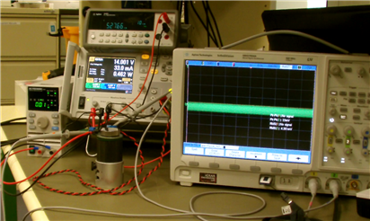

The test equipment I was using are:
  • Agilent – N6705B – DC Power Analyser
    Comprehensive DC generator which more than sufficient power capability with a 4 wire connection feature that compensates for DC variations due to cable losses. The DC Analyser does have an optional load module but was not fitted. I have recommended this module to be installed.
  • Agilent 34405A – 5 ½ digit multimeter
    This meter used primarily for reading down to mV connected directly onto the EVM Vout test point.
  • BK Precision 8500 – Programmable DC Electronic Load
    Original load used, unfortunately failed a noise test and was canned after trying to get noise measurements done. There seems to be some conductive emissions from the load that interfered with my measurements. Also could only cover up to 5A load.
  • BK Precision 8534 – DC Electronic Load
    This one has excellent noise capability but had no way of logging data, therefore the video method was the only way to collect data. Also had a 30A feature, obviously for low power low voltage applications.
  • Agilent MSO7054A – Mixed Signal Oscilloscope.
    What can I say, I want one!!
  • Fluke TiR27 Thermal Camera - One  of the best fault finding devices I have used in my time as a technician.
The problem I had was there was no way collect the data in the current setup and the requirement for licences for Agilent Benchvue Software were not available so I was unable to record the data automatically. I really didn’t want to write it down as I was taking notes, so instead took reams of video then later sitting next to my computer able to quickly punch in numbers. It is fortunate that I will be using the video later to edit a video version of the review later.image
Still a very laborious task but found a method where I could combine multiple test into one video.
Along with some extra tests most of which were very quick including oscilloscope capture capability. The data came up with was amazing and decided to take it onto myself to try a new display method of showing plots.
Primarily these are 3D plots based on numerous reading taken I was able to get a reasonable display that showed some interesting data.

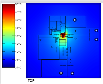

Further to this I also carried out a thermal test and shown to the far right is a thermal image taken using the Fluke TiR27 thermal camera. This image was taken during the converters maximum input voltage and output current. For an integrated FET DC/DC converter the temperature is very low considering. This would be relative to it efficiency.
The TPS54A20 is currently not the major board that I will be using for my project but this is a good supplement board for cascading in processor so most of my concentration will be no the next board, but further test were carried where there is a lot of images but not enough room to show in this review.

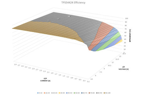

In this case I first took measurements as opened from the box with no modifications. 4.5 - 17Vdc I/P and 1.8V O/P. As with the TPS54A20 I reached slightly less efficiency. This would be a fairly accurate assumption, a couple of reasons I could think of but mostly due to the necessity of a large swing Vout would be fairly accurate, otherwise there would be no requirement for the TPS54A20 for low to mid current applications.
The Load / Line Regulation plot though is nothing short of fantastic.
It clearly shows a flat plane with excellent stability over all current and voltage input ranges.
By changing the z axis from 0 - 2V to 1.74 - 1.796V the plot looks at lot messier but does show what I feel an optimal design. I clearly shows a curved response with load regulation optimising the worst case in the central region. Any other method of design may have caused a downward trend in load regulation that could have started at an optimal point down to a much poorer regulation at higher voltages. This did confuse the theoretical calculation of load regulation at 100mA to 0, whereas the real regulation is 0.00085. Still impressive though but can hide many sins.
