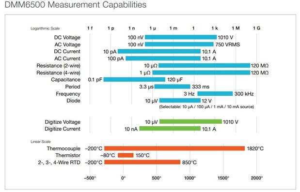

Some of the key features of the Keithley DMM6500 are
Fig: Key features of DMM6500image
Fig: The Measurement capabilities of DMMimage
