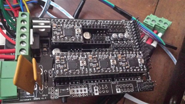

    As for the drivers i want to say its a ramps 1.4 for an arduino mega, here's a picture
    Found the kit i bought: SainSmart MEGA2560 A4988 Ramps 1 4 3D Printer Kit for Arduino RepRap | eBay
    I'm also changing the couplers from the 3d printed to the metal ones and changing my stop switches to mechanical ones
    I don't have an oscilloscope but I do have a multimeter

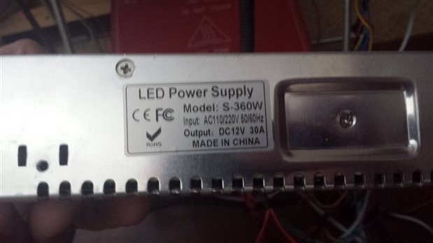

    Also here's my power supply ratings
  • D_Hersey
    D_Hersey over 12 years ago
    google isn't letting me see your links
    e14 Contributor over 12 years ago in reply to D_Hersey
    Saved the photos to my computer and reloaded them, are they working now?
  • D_Hersey
    Yes, now I can see them.  Your power supply seems adequate.  See that your connections are solid.  This is a fairly high current deal.  If you are using screw terminals, make sure your wires are freshly tinned and central in the connector and that the screws are tight.
    I'll try tinning the ends for all of the wires. Also the z motors like to put the carriage at an angle
    No change. All of the motors are loud and barely move
