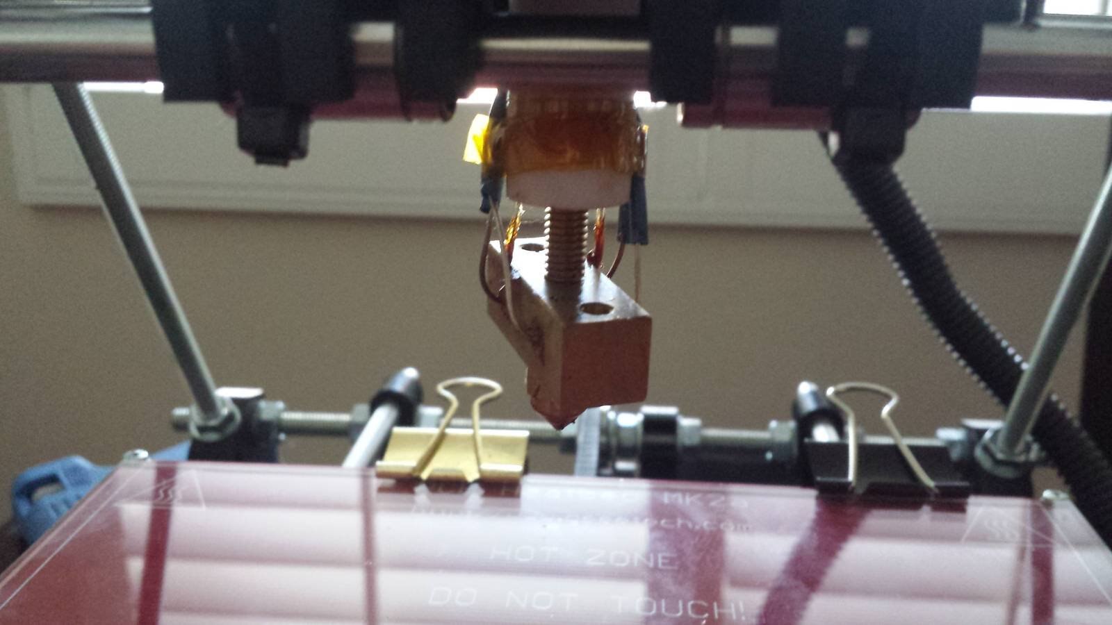

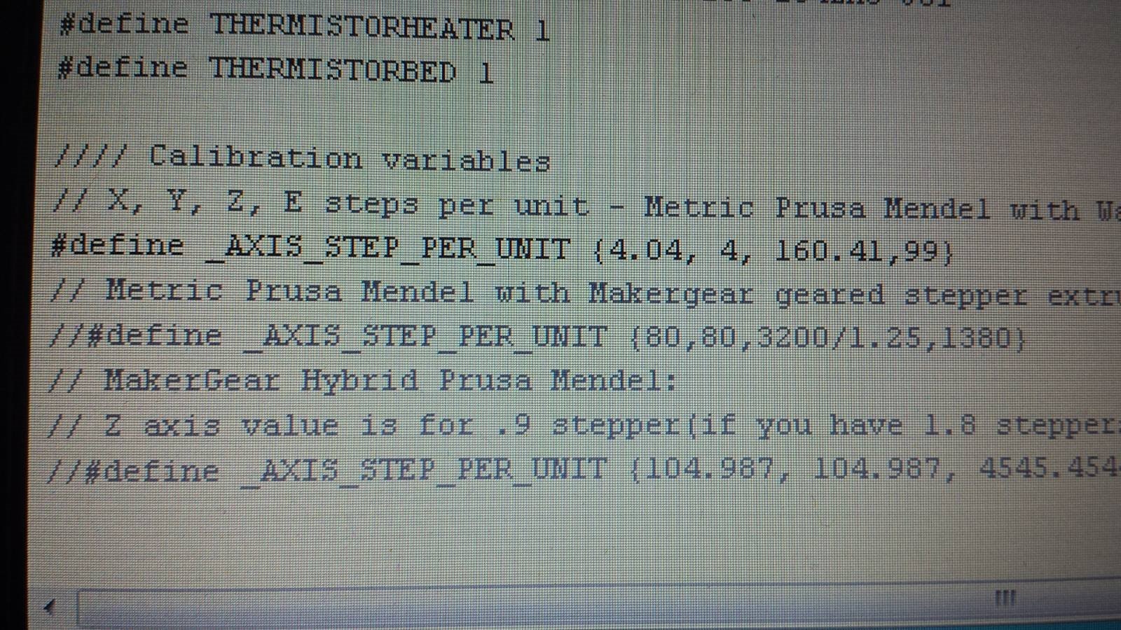

    So it turns out it was the settings that the software comes with. I have it set to this
    It seems off but it was working.
    the only issue right now is this
    and the temperature was reading something like 375 but I think it was a wiring short. I'll just have to reorder the parts and insulate it better
