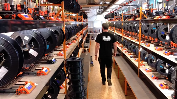

    When it comes to changing filaments, I can tell you write away that the stock Ender3 Pro isn't the best thing. It's incredibly fiddly where you need to straighten the end of the filament to have a chance of getting it through the extruder to the bowden tube. I can't really say about the Ender3 V2 or the Prusa, but the Prusa uses a direct drive all metal hot end, so there shouldn't be any issues on that part (that's another sort of limiting factor for the stock Ender3 Pro, it doesn't have an all metal hot end, so it can print PLA and maybe PETG, but it wouldn't work with anything that requires higher temperatures). I'm surprised to hear that you have that much problem with first layers adhesion, a thing I usually do is to get the bed closer to the nozzle and then compensate for that in the model by putting chamfers all around the bottom surface to compensate for the elephant foot effect. Since the prints are mostly flat (take up a wider area but not that high in z axis), I think something with a bed leveling sensor would be an absolute must. The Ender3 V2 and both the Prusa Mini and Prusi i3 MK3S have a bed leveling sensor which should help dramatically. As hlipka  already stated, the Prusa really is a work horse, a thing I love about them is that they use their printers to well, make more of their printers.
    Here is a picture of their print farm making parts for printers. I really find that fascinating and cool! To summarize a bit, all of the things I've heard about the Prusa is that it's a really good machine which is a work horse that doesn't require that much work around it. On the other hand, I love the Ender3 series of printers, since they are really affordable with really good quality prints and if you love tinkering around with them, you can do whatever you want with them, with so many different mods done by others already. There's an abundance of upgrades that can be done, from linear layers, all metal hot ends, direct drive systems, different beds and so on. But again, it doesn't require any of those mods to get really high quality prints, I'm running it pretty stock except some 3D printed upgrades and I'm really pleased with it.
    Have you had any progress on fixing your machine?
