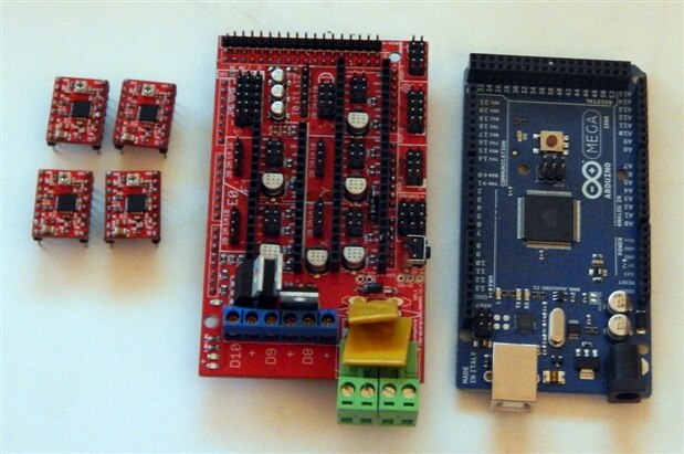

    The way it sounds your design would be similar to a Reprap (Cartesian style).  The bed moves in the y while the print head moves in the x and the whole extruder platform moves in the z.  I would check out Reprap.org.  But most 3d printers use a nema 17 motors with around 55 N*cm (78 oz*in) of torque.  The typical cartesion style printer used 5 stepper motors in which the z axis has 2.  Way below what you would need for a CNC machine.  You can always up the motors but will have to change from the standard electronics. Typically my electronics of choice is the Ramps 1.4.  The downside is it doesn't have much room to grow.  While some of the newer boards has extra inputs.  For the hotend my go to is the Lulzbot Budaschnozzle but have also used J-head which is more common, cheaper and still good all around.  I hope this gets you started.

    Nate has it right there - NEMA 17 motors typically afford more than enough torque for most 3D printers, as they do not have the robust force requirements of a subtractive-manufacturing system like a CNC cutter. RAMPS (1.4 is the current standard) is a shield for the Arduino MEGA microcontroller board, and then the stepper motor drivers are fit to the RAMPS interface points.
    I typically use something like the Pololu controllers, and you will need one per stepper motor you are controlling. A complete set of RAMPS+Arduino MEGA+Pololu drivers (x4-5) costs around $40 USD on eBay if you watch for a good deal. I also use the all-in-one combinations like the Mightyboard or RAMBO for more compact printers but those are produced in lower volume, so tend to run around $80 USD each for the same capability in a single board.

    The Gen6 controller board will work just fine.  Just remember that having a single board solution isn't always the best.  I'm not trying to persuade you into another one but just want you to be aware that if a stepper driver fails, which I have had numerous times over the years your soldering skills will need to be up to par.  Where for example with the Ramps you just purchase a new module and swap out for the faulty one.  Like I said before the Gen6 is a great board.
