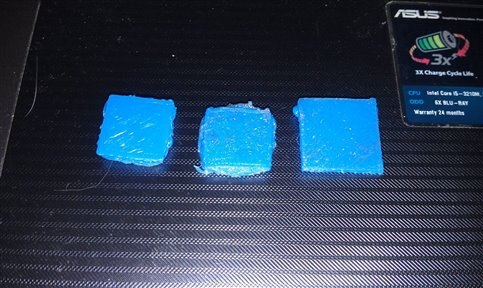

The beginning of the test cube, 3 different attempts, learning about the settings..
In each case, i stopped the printer early because it was not moving high enough Z axis,
meaning it ended up, grinding around inside the previous layer.

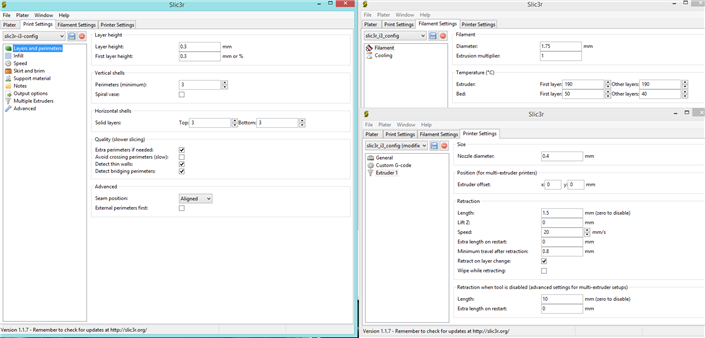

This is my typical slic3r settings(hope you can see, not sure about the resolution on the webpage)

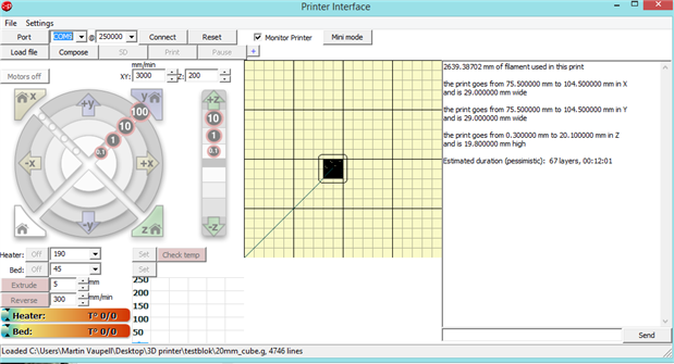

And promterface.. (havent really done anything here, except when i was calibrating the hotend temp for marlin.)

    I raised the Z axis around 20mm and tryed extruding via pronterface also working, extruded quite a bit, and it was ok. (i did not retract at all)

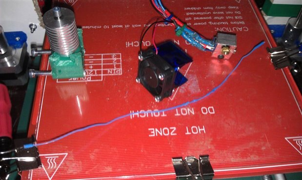

    The filament i pulled out of the hotend "topside" is right there.
    Just to be safe i disassembled the hotend and it was clear, seems i was able to pull it all out, before it completely cooled.

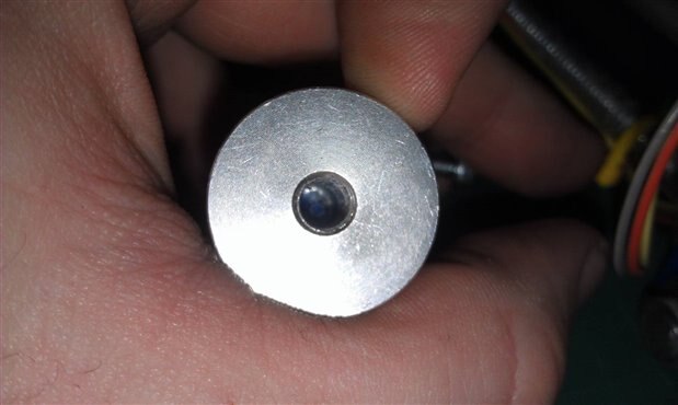

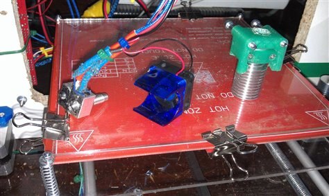

    However, when i then turned to printing a test, it was stuck again, i disassemblyed the hotend and found the block to be located in the upper part. image
    During disassembly i also broke the hotend, so i had to wait for a new one.
    This is the part, where the pla is stuck as you can see..
