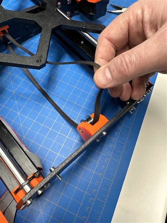

This video is from a Prusa MK3. It used to be intermittent. But now, whenever the y-axis moves, it makes this zip-tie noise.
I think the source is this bearing, but the high-pitched sound makes it difficult for me to localize.
Does it sound like a dead bearing to you?

    Upon further inspection, it isn't the bearing.
    I started to loosen this pully, and the noise went away. And then I realized the top screw was stripped. Well, the nut inside of the plastic mount is stripped. I'm also seeing signs where the pully is wearing into the plastic.
    So I think the squeaking noise was the pully rubbing against the mount which was no longer stable.
    Regardless, I have new linear bearings coming. This printer has well over 1500 hours of printing on it.
    Probably time for some replacements.

    While removing the idler assembly, I noticed two things. The first is that the noise when away once it was loose. I found that... odd since the linear bearings would not have had a change in load. Then I found the lock nut for one of the screws was also loose. At first, it was nearly impossible to turn. Then It spun freely inside of the plastic housing. (The nut was supposed to be retained by the plastic.)
    M3 Hex Bolt Cap with bent threads
    So, yeah, that screw took some damage over time. (And probably some from my expert disassembly skills.)
    The second finding was that after finally removing the idler assembly, I noticed there was a dot on it!
    Left is my precision removal technique. Right is the new spare part I printed (years ago). It shows the dot.
    I thought it was curious because I did not remember that dot when I assembled the printer.
    While re-reading the assembly instructions, I saw this tiny-yet-important-gem:
    Take the Y-belt-idler and place it on the front plate. Note there is a mark (circle) on the printed part facing up.
    I put the key sentence in bold.
    Yeah, so 3(?) years ago, I installed the idler wrong (upside-down). And the "intermittent" noise was likely stress on THAT bearing. So now I do believe the noise is a failing bearing, just not the one I initially thought.
    After 1500+ hours of print time, like that, I think it is safe to say I need to replace that pulley's bearing.

    It all looks symmetrical to me and the pulley is bi-directional. And yet it matters which way is up??? What is your theory on that?
    I could see how too much belt tension would increase bearing wear, or even how a loose screw could cause uneven loading, but how does orientation make a difference?

    It isn’t symmetric. There is a slight asymmetry to the design.
