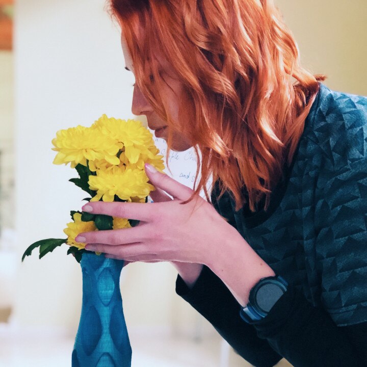

    We have designed and 3D printed various models in it as shown below.
    DIY Decorative Vase
    We designed and 3D printed this Decorative Vase in SelfCAD. You can use it to decorate you home. You can download the model here  https://www.myminifactory.com/object/3d-print-diy-decorative-vase-decor-ideas-95203
    See the design process here https://www.youtube.com/watch?v=N3iY7XCARSA&feature=youtu.be
