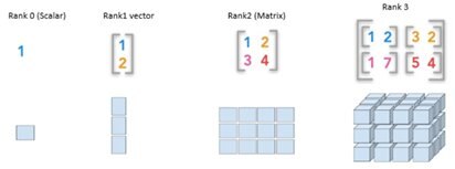

Tensors
A Tensor is described as a multidimensional numbers array. The following figure shows Rank0 tensor, Rank1 tensor, Rank2 tensor, and Rank3 tensors.
Figure 1: Tensors
