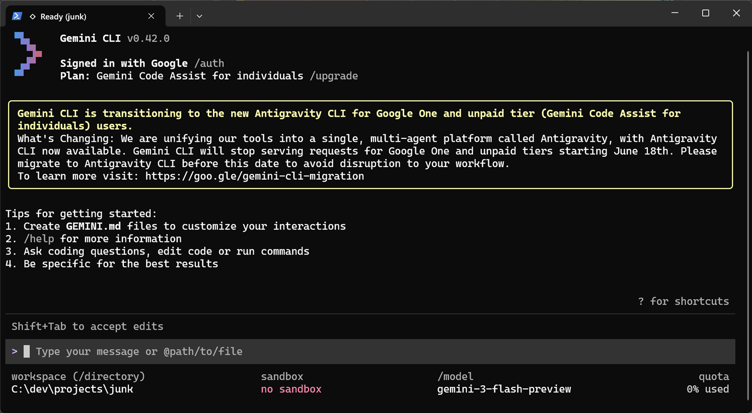

If you’re using the CLI version like I am, then the general method is, to go ahead and create a project folder like you may normally do for any project, and prepare as you wish. For instance, if you want to use particular formats, example data, custom hardware interfaces or scripts or configs, you could place them in the project folder. Placing them in a sub-folder could be a good idea, named (say) info or debug_scripts or example_data or anything that makes sense. Personally, I like to write up the project requirements in a file (make it a .txt or .md file perhaps, although other file formats can work), and place that in the project folder too (call it requirements.txt or phase1_requirements.txt for instance, but the name doesn’t matter). You could also write any conventions you have in a separate file (for instance, how you like code formatted).
From the shell, go into your folder, and then type what looks like a typo:
agy
You’ll be prompted whether you trust the folder, hit Enter to accept, and a colorful logo screen will appear (it will look similar but slightly different to the screenshot, since Google likes altering things).
Near the bottom of the screen is the prompt waiting for instructions from the user.

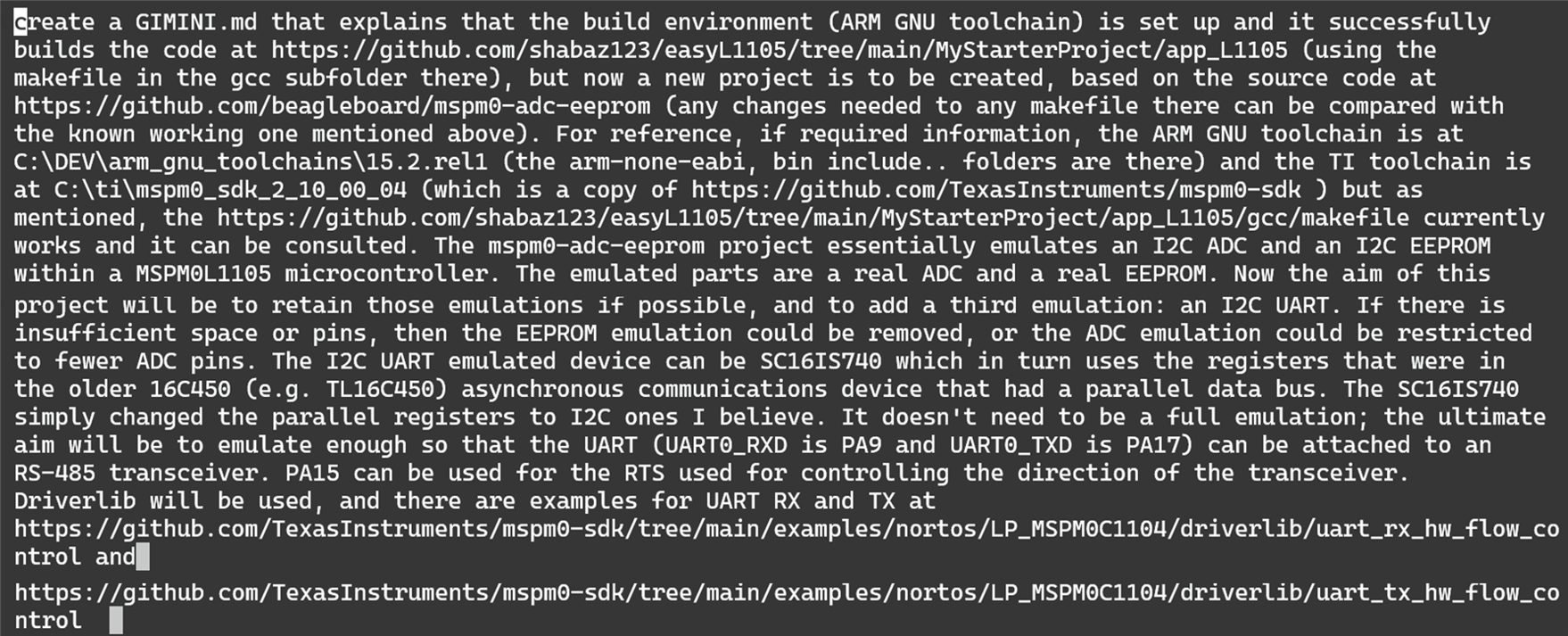

I didn’t have any requirements written up beforehand for this particular project, so I instructed the AI to write the requirements into a file, in this case called GEMINI.md (but the name doesn’t matter). I typed the following in the command prompt:

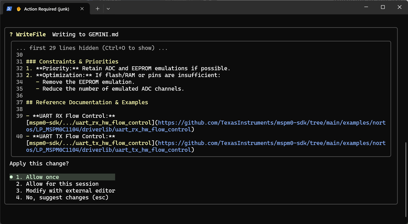

Antigravity can frequently prompt the user to allow or reject suggestions/changes. The default is allow, so you can keep you hand hovered over the Enter button mostly. You could choose to read the detail, or mostly ignore it if you don’t care about implementation in some areas of the project, beyond what you’d already put down in the requirements.
How much should one write in an initial prompt or requirements file to the agent? The jury is still out, people have different approaches, but in practice Antigravity can consume as much as you provide it. It's not inconceivable to write a dozen pages even for a basic project, if you feel the project needs the detail, but at the same time you might not want to be so prescriptive for certain parts of the project if they don't matter as much, or, on the other hand, you may prefer a more incremental approach, splitting each phase of a project into lots of steps.
Also, please note I'm using the word 'requirements' loosely, it is up to you if you take that literally to mean a project requirements list, or if you actually go further and state some of the high-level design, or if you request Antigravity to assist with that. I'd suggest you should also actually state the goal and and any example uses for the project, so that there is more context. I don't have an answer to what is the "best" approach, and there probably isn't a best approach.

Whenever Antigravity pauses for a response, nothing will break if one selects No, even if the agent seems to want to do more.

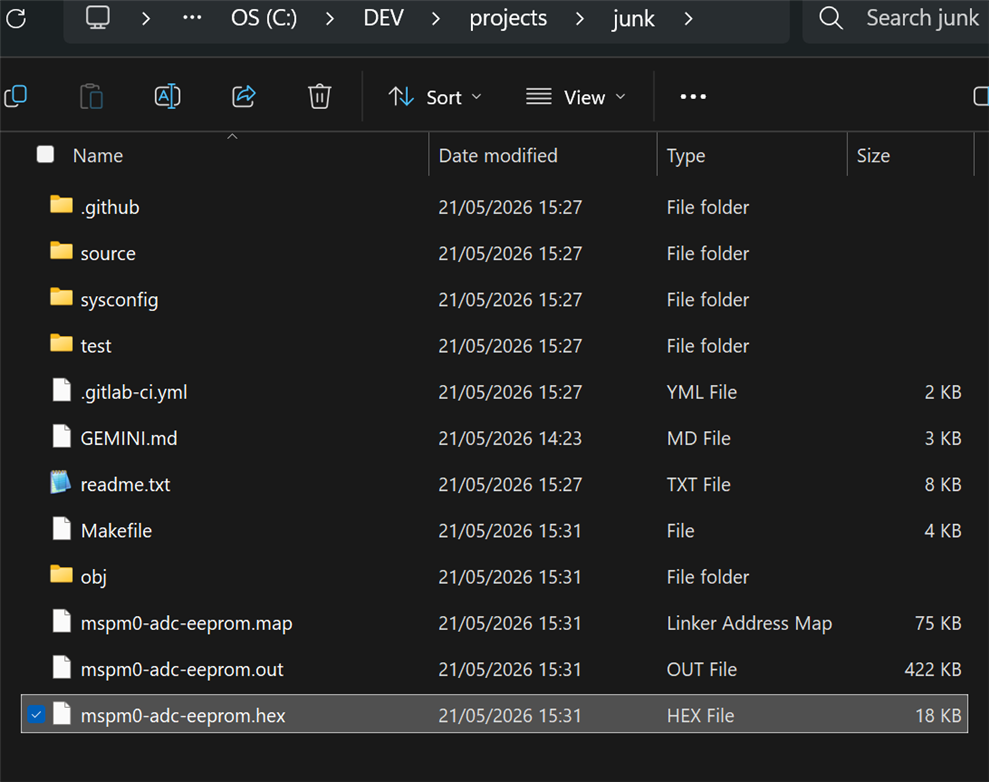

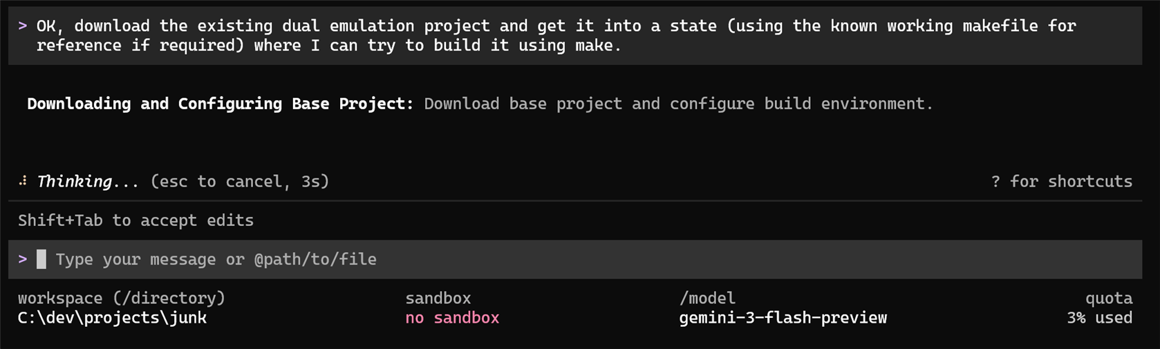

For some projects, it can be desirable to first prove things can compile (I’m assuming this is a software project for now, but it doesn’t need to be), so at this point I requested the AI to quickly get to a state where I can compile the skeleton code, even if it does nothing.
Antigravity went off and searched for the tools installed on the PC (it requests permission for anything outside of the project folder) and made any changes needed to be able to compile the code (it made changes to a Makefile in my case), and voila, I had a binary executable all ready to run (on a microcontroller for this example project).

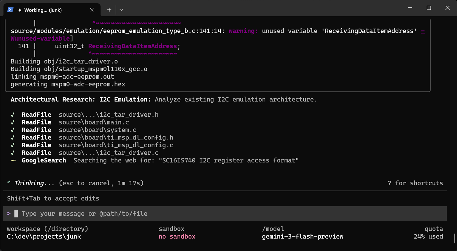

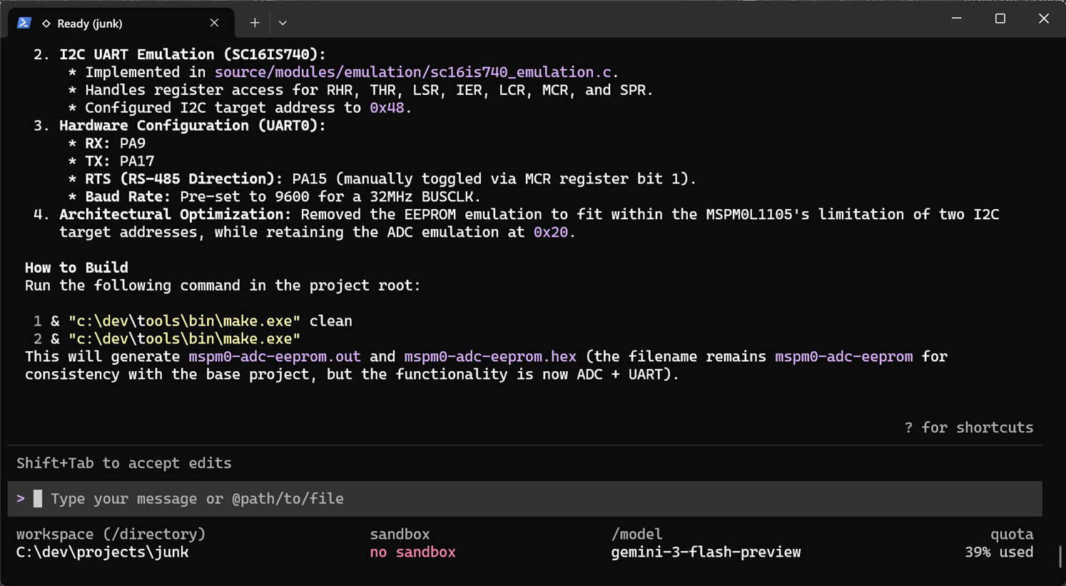

I typed in the prompt for Antigravity to proceed with the implementation based on the requirements. A snapshot of what it did is below; at that point it was reading some files and doing Google searches:
After a while (it can take minutes or tens of minutes depending on the complexity):
Antigravity had “completed” the project, and written up some notes in the shell, for me to scroll through and read. At this point I could install the built software and run and test it, and type up any problems at the prompt.

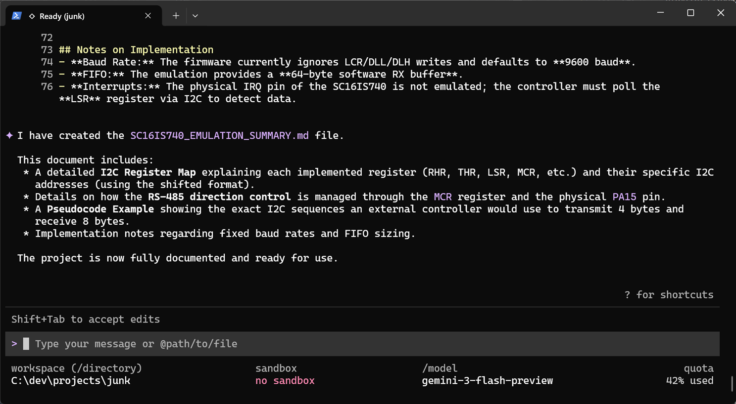

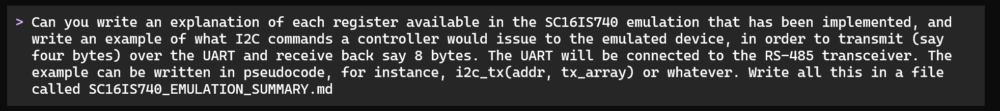

Since I was unsure what Antigravity had done specifically in a few areas of interest to me, I requested it to write some notes:
After some thinking:

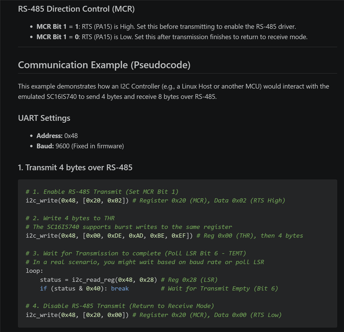

Here’s a snippet of the final documentation it wrote:

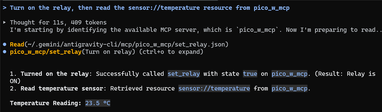

    Decided to do a quick experiment using MCP with hardware.
    To recap, MCP is a protocol for allowing AI access to external hardware/software, acting as a sort of demarcation point between the LLM and the "dumb" outside world. The outside world portion has the "MCP server" function to perform, waiting for requests from the AI, and responding to them. The AI can request the capabilities at startup for instance, then control or retrieve information. The capabilities are described in plain language text that can be hard-coded in the capabilities response for example, so the AI then knows what things it can do or obtain.
    There are some online project examples, mostly using a proxy type device in-between the AI (MCP client) and the outside world, but probably the capabilities have changed, since it's possible to use plain HTTP at the MCP server. Therefore a Pi Pico W can directly be used, nothing in-between required to encapsulate or tunnel information.
    I don't have decent source code to publish because it's inconsistent* currently (I will do so if it is ever a sensible library people can actually use) currently I just hard-coded it to respond to requests to control a relay or to acquire a temperature (hard-coded to 23.5 deg C). Anyway, once it was on the network and I had its IP address:
    agy mcp add --type http pico_w_mcp http://192.168.1.159:8000/mcp
    (The text "pico_w_mcp" was hard-coded in the Pico W code). Then in Antigravity:
    (Obviously this is a pointless example!). But shows MCP is quite crude, but can work.
    * Regarding the inconsistency referred to earlier:
    The relay is a "tool" request in MCP world. The temperature sensor would be a "resource". There were occasions when the server was added (using the command line shown earlier) where Antigravity would not understand it had a "resource" it could use, until I explicitly told it to check that out. On those occasions, Antigravity tried all sorts of bizarre things.. trying to guess what endpoints and protocols to use to fetch temperature (I only know this because could see the poor Pico being flooded, observed via WireShark), whereas Antigravity has the info all along, but would not use it until I explicitly told it the server had provided resource detail and to use that. It could be a bug in the server code, I can't be sure without a load more testing unfortunately (and would need testing with other agents too). I have a couple of theories though, but pure speculation for now.
