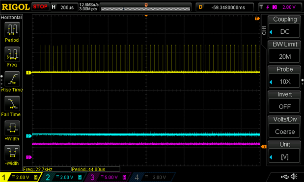

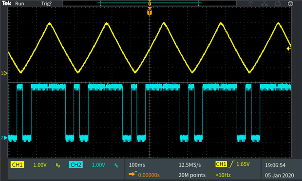

The output signal doesn't look like a triangle when you probe it, because it's a pulse train. When you run it through a low-pass filter, it's integrated into its analog representation: a triangle wave.
I didn't find a good picture with a triangle wave. The below one shows the very same concept but with a sinus signal generated with duty cycle modulation.
On popular demand I'll probe the actual pulse train together with the triangle wave on my launchpad.

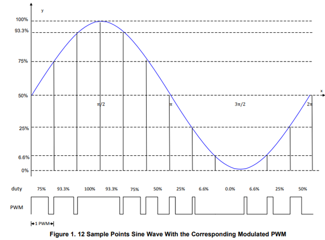

source: part of a diagram from TI application note SPNA217: Sine Wave Generation Using PWM With HerculesTm N2HET
TI has application notes solely focused on generating different wave types (trapezoid, triangle in one and in another note sine wave) by playing with the duty cycle of the HET modules.
They do a much better attempt to explain it than I do here. Check the app notes if the above doesn't make sense.

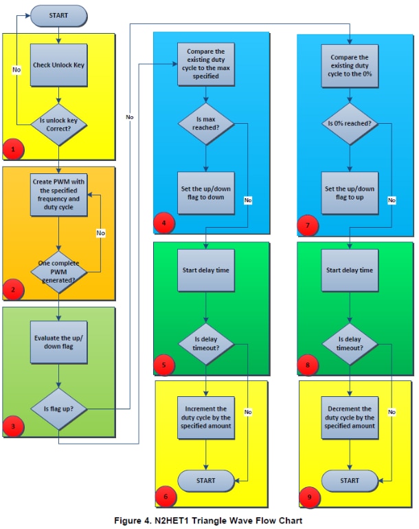

The flow that generates the pulse train is shown in the chart below:
source: TI's application note spna178: Monitoring PWM Using N2HET, showing the triangle waveform logic
Now the HET code that implements this. I believe this is among the most difficult code to read (together with TI' PRU instructions).
I need the comments to recognise the flowchart parts above.

The way of working is basic. The HET assembler translates your HET program in an array with binary data. One entry per instruction.
But it helps you a little with a custom  that fits your code and allows you to see where the parameters are for each instruction, so that you don't have to perform magic logic.
The assembler instruction (as discussed in the previous post , this command is entered in the project pre-build steps:
${HET_COMPILER} -v2 -n0  -hc32 "..\HET_code\Async_PWM_Triangle_Wave.het"
The easiest way to get your head around this is by using the flow chart and HET code side by side and trying to follow the logic.
This is doable. Much more difficult (to me) is writing a significant HET program from scratch. That's a challenge I'm going to battle this year.
    I'd like to see it.
  • jc2048
    jc2048 over 6 years ago
    I'd like to see it.
    Jan Cumps over 6 years ago in reply to jc2048
    1. HET1 output: digital signal with duty cycle modulation.
    2. The same signal, after the RC filter
    3. HET2 output. High hen the duty cycle is outside a given range.
    A full cycle:
    Rising edge:
    The lowest point almost
    The highest point
    Because there's no buffer between the digital output and the RC filter, the digital signal is somewhat loaded and tainted by the downstream filter.
