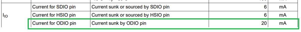

The Texas Instruments MSPM0 microcontroller has a few open drain GPIOs. TI calls them ODIO. These are 5V tolerant, and can switch up to ( see jc2048  comment below) +-8 mA. The main purpose is to support multi-level IO.

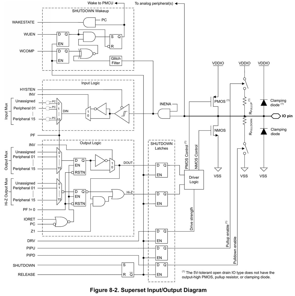

From TI's documentation:
"... the open drain IO only implement a low-side NMOS driver and no high-side PMOS driver. The 5V-tolerant
open drain IO are fail-safe and may have a voltage present even if VDD is not supplied"
"ODIO can be used to implement communication with a 5V device."
source: MSPM0 L-Series MCUs Hardware Development Guide and MSPM0L110x Mixed-Signal Microcontrollers datasheet

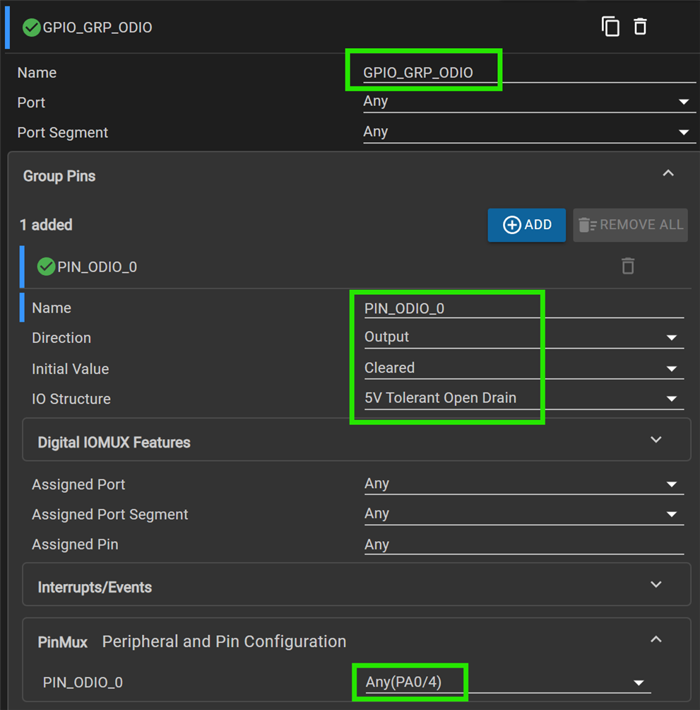

In SysConfig, PA0 is set up as an open drain output.:
The code is extremely simple:

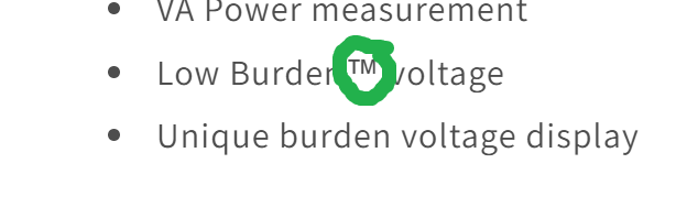

    Don't know how legit the TM in the spec is :)
    but he's definitely proud of that capability...
    ... and it's really useful on the bench.
    Jan Cumps 10 months ago in reply to jc2048
    I had interpreted those |I..L| s in the datasheet as measurement parameters too. But at the same time, I re-read my post as if I was "not me". And it was over-promising.
    Maybe one day (can I be more vague?) I set up a little design with both ODIOs sinking 20 mA constantly, and monitor package temperature.
    We can almost perfectly predict the energy burned, based on your RON and the 40mA.
    But I'm a bit reluctant at the moment. Maybe I can buy some launchpads. They are so cheap that they are almost disposable. This board is dear to me - a birthday present.
    It's EEVBlog's 121GW. It has some quirks, but the low burden current  mode is definitely a strength.
