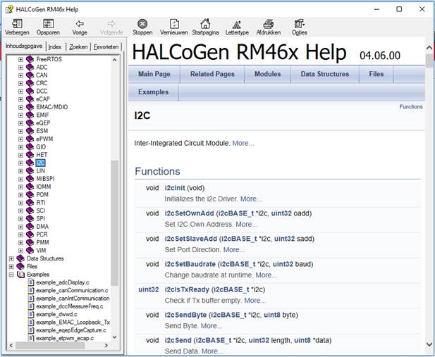

The Pi code is linux based. It uses the linux i2c file device to talk to the LCD driver.
Our Hercules isn't a linux controller. Our work will be to port from the file type i2c access to a hardware driver based API.
The API is documented in the HALCoGen configuration program.
That help set also has an example that we can use to understand how a typical i2c conversation looks like: example_i2cMaster_TX_RX.
The first part of that example is a Master Send scenario with a loop. Exactly the same as what shabaz uses in his Pi test.
That means we don't have to find out what API functions to call when. We can just replace the each linux-based set of calls in the Pi code with the ones from the example.

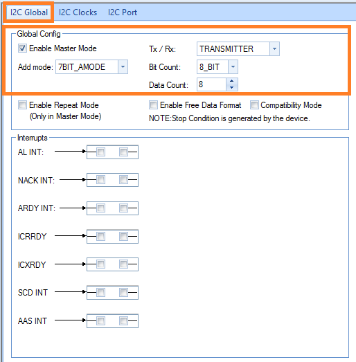

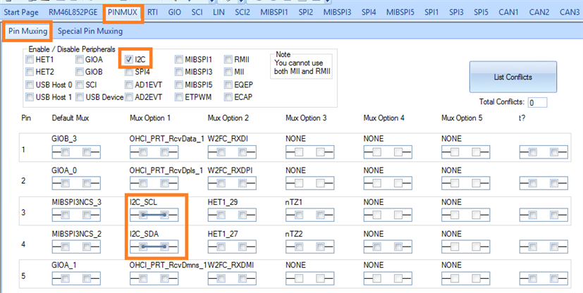

Configure I2C
True to the Hercules way of working, we set up the i2c driver in HALCoGen.
  • enable the driver
  • set multiplexing to enable i2c functionality
  • set the parameters
