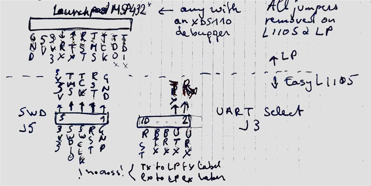

 shabaz designed a development kit for the recent Texas Instruments MSPM0 microcontroller series.
In this post, I show how to use a LaunchPad as debugger for that board. Complexity: low.
(post that introduces the kit)
 Required hardware and software
  • EasyL1105 kit, with headers soldered to the programmer interface J5
  • an IDE that supports XDS110 debugging. I use ccstudio 20
  • A LaunchPad with XDS110 debugger on board (cheapest: LP-MSPM0C1104, $5.99 from TI store).
  • USB cable to connect LaunchPad to PC
  • 7 patch wires to connect EasyL1105 signals to LaunchPad
I used an MSP432 LaunchPad for this blog. As long as your LaunchPad has XDS110 on board, and it's accessible, it 'll work
Functionality
  • programmer
  • debugger
  • COM port passthrough
  • power
Connections
Remove all jumpers from the EasyL1105. And all (at least the debugger) jumpers of your LaunchPad.
Then connect the two, using patch wires:
EasyL1105 LaunchPad
J5.1 GND GND
J5.2 RST RST
J5.3 SWCLK TCK
J5.4 SWDIO TMS
J5.5 3V3 3V3
J3.2 UART0_RXD RXD*
J3.4 UART0_TXD TXD*
*on the LaunchPad jumpers, the TXd and RXd are labeled for the controller side signal. So no Rx/Tx crossing.
On the cheap LP-MSPM0C1104, here are those signals:
On the MSP432 LP that I'm using, it's very similar. The table above will guide you through the setup.
Double check, then connect the LaunchPad USB to your PC.
