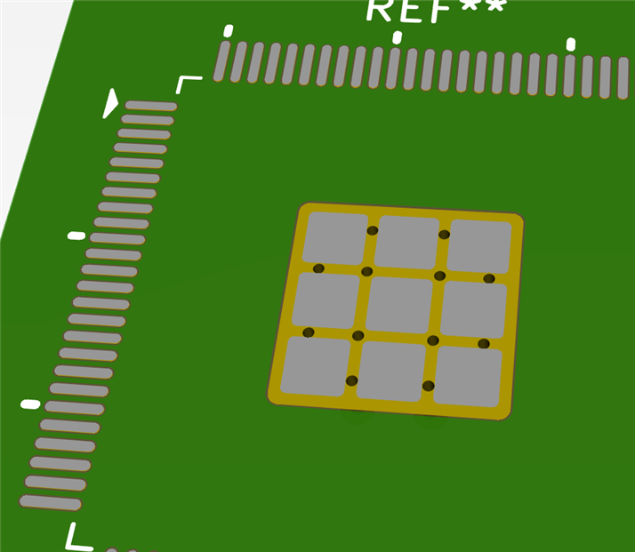

    You might find it useful to put larger vias through the processor centre pad.
    For heat transfer you do better with a flood of small vias but if you end up having to remove the processor - ( or re-solder the pad because the pins were  a bit bent and it was lifted above the board the first time) - then 1 or maybe 4 big vias (1mm hole or more) are much better for heating up with a soldering iron from underneath.
    Remember to thermally isolate the pad from the ground plane !
    I also wonder if you considered using PMOD compatible pin-outs - not sure of the value of this although I have done it a few times - (not sure that they were ever used as PMODs by customers).

    shabaz 22 days ago in reply to michaelkellett
    Hi Michael,
    Thanks for catching that, I've improved it a bit (I have not ordered yet, because the firms are on hols currently). This is the footprint with some more vias:
    This should be a lot easier now to heat up from the PCB underside:
    I've heard of PMOD but not come across any such modules so far. I've decided to create another board while the PCB factories are offline, MINI-MCXN or something, but will use a flat flex connector instead of 0.1" pin headers, and only bring out a few connections to just a small amount of attached hardware, and shrink down to approx 30x50mm PCB.

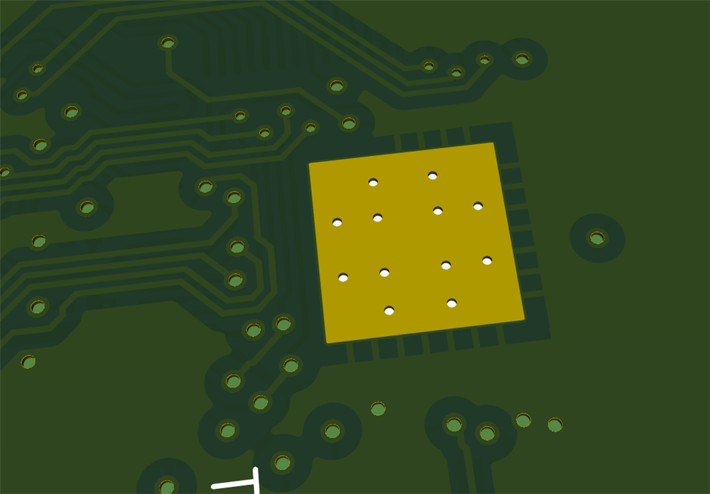

    I would go for more or bigger vias on that centre pad and a full pad on the bottom with no thermal reliefs to the vias on either side (but thermal relief to the ground planes if there are any).
    This is so you can get a decent coupling from a soldering iron to the bottom pad if you should need to. (And you do not want solder resist on the bottom side of this pad. I don't put solder resist on vias of any kind on prototypes to facilitate bodging later !).
    I would also take any unused pins out to connector footprints because I have often found this useful later when I end up using a board for some purpose I had no expected.
    Do you have a plan in mind for this board ?
    MK
    shabaz 20 days ago in reply to michaelkellett
    Unfortunately that's an older screenshot (it's the usual problem, the more recent updates get hidden by the site : ( I'd made it a solid pad, but didn't enlarge the holes further (I have made them larger now; from 0.3 to 0.4mm dia), the pad is 6x6mm so hopefully that should be sufficient to get heat in (there happens to be no ground plane on the top side pad, and thermal relief on all other planes as you mentioned):
    Pad underside:
    The actual ground plane is the layer underneath top layer:

    michaelkellett 20 days ago in reply to shabaz
    That looks more like I expected. Good luck with it.
