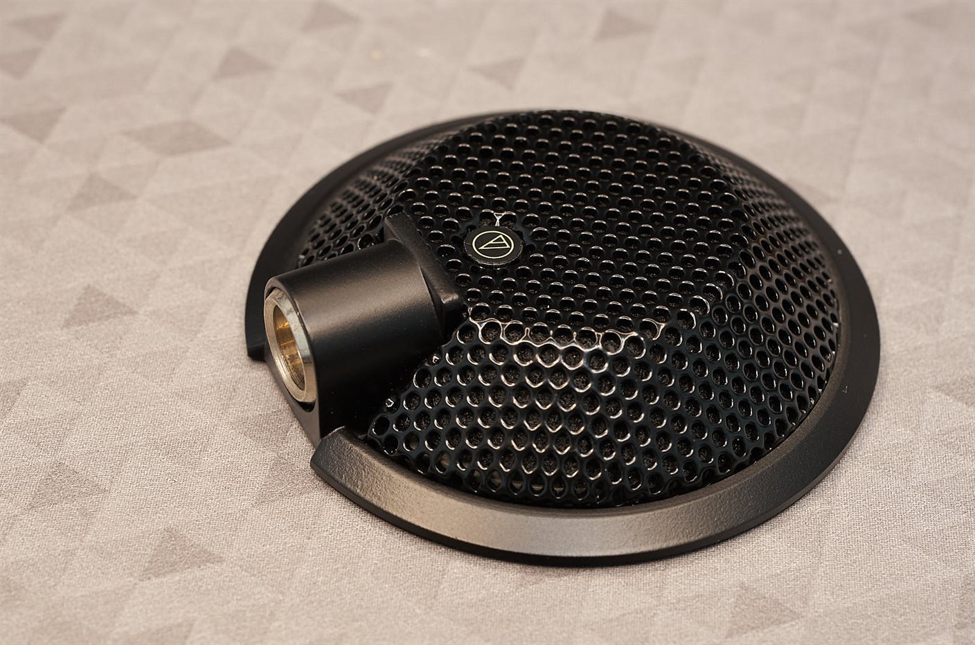

It’s not everyday I take apart a (reasonably pricey) microphone! But, I was curious, and taking things apart is sometimes how one learns.
A long time ago I took apart an Echo Dot, which contains very different microphone technology (MEMS devices, seven-fold), so check that out too if it's of interest.
Anyway, the U841A is an electret condenser mic, intended for (I believe) speech for audio/videoconferencing purposes. Hopefully any audio experts can provide more detail.

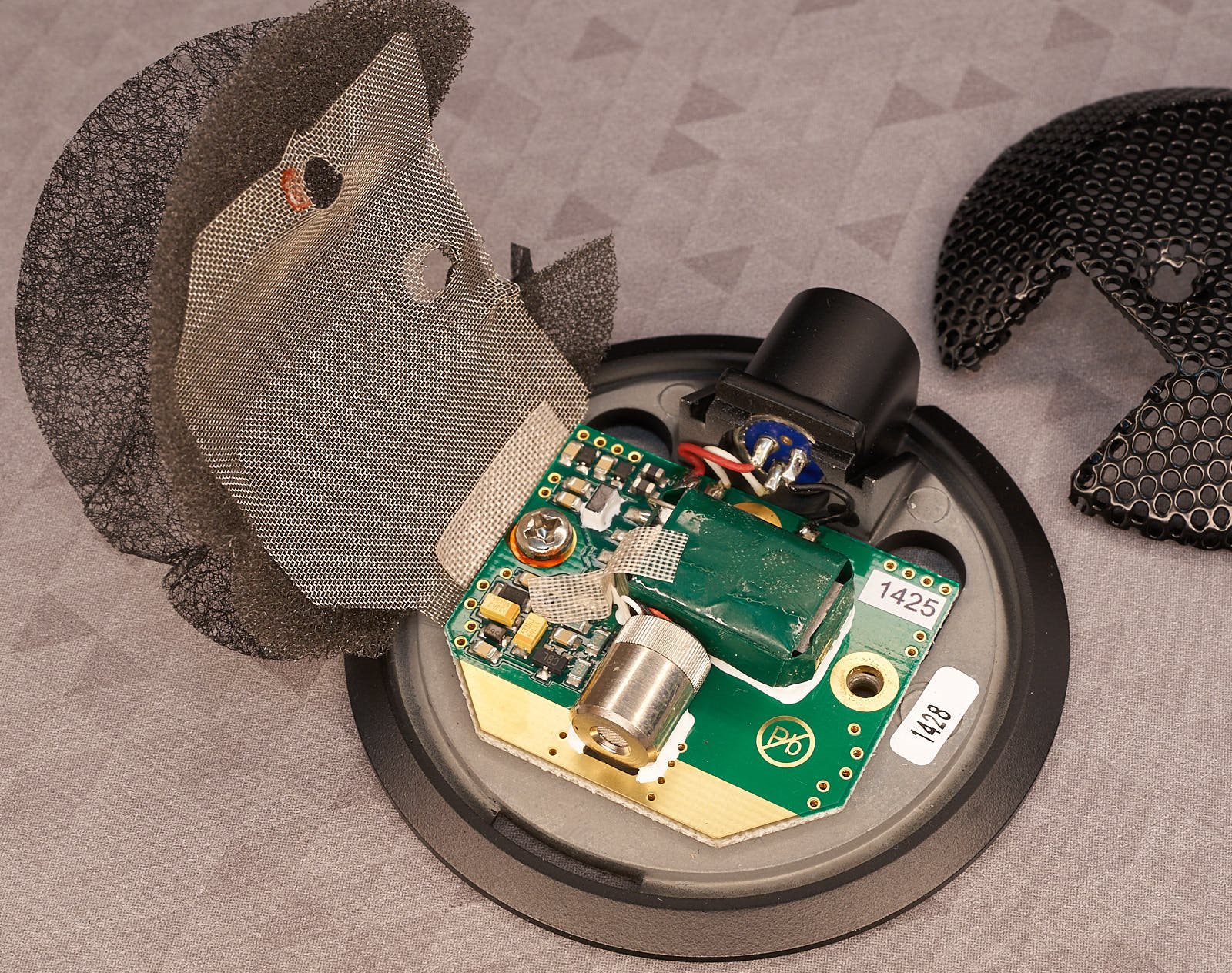

The microphone is very ruggedly built. The secret to opening it up, is to peel off that tiny circular logo on the top; it reveals a screw : ) Then the stamped metal grille lifts off.
There’s a lot to visually unpack just from the photo below. On the left, you’ll see three material layers; a thin (0.2 mm) stiff layer (kind of like collar lining! there must be a technical name for it..), followed by 2 mm thick soft acoustic foam, followed by (what feels like) nickel mesh 0.25 mm thick (very slightly magnetic), which is secured to the ground, and must be acting as electrical shielding.
The big green rectangle was originally a mystery, although I suspected it may be a transformer. Everything is superbly constructed.

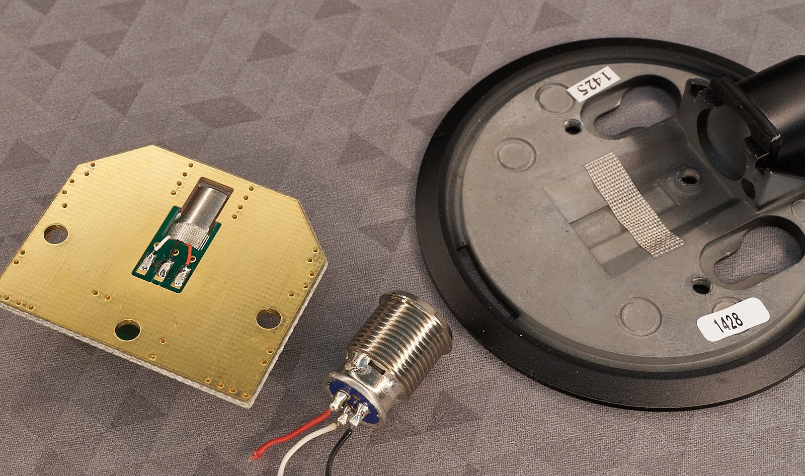

Pulling it apart further (there’s a grub screw which holds the mini XLR connector in place, and it needs to be desoldered to remove the PCB. You can see the electret element has three wires, which suggests it contains an internal amplifier.

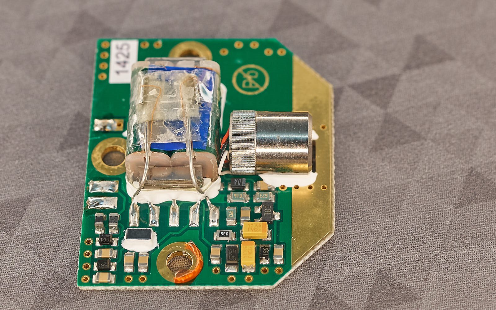

Here’s a closeup of the circuit board, with the green tape removed; now it’s clear that was hiding a transformer.
In the photo below, the board area can be split into three portions; the lower-left contains circuitry for filtering off RF interference arriving via the microphone cable, the center houses the transformer for constructing a balanced output, and the lower-right contains the audio amplifier.

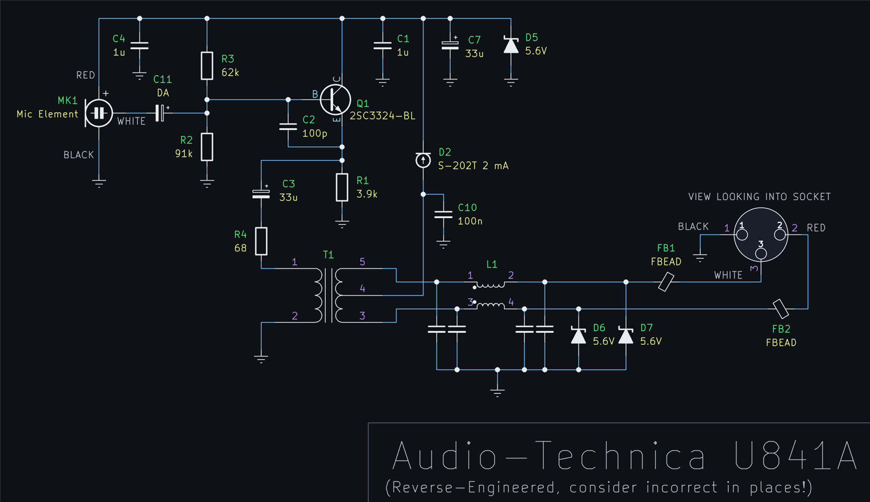

I tried reverse-engineering the circuit (without destroying it, hence I’m sure I have some of this wrong – and all of the non-polarized capacitor values are placeholder guesses).
I’m not sure what D1 is, it has a DA inscription. With some thought, the black component inscribed DA must be a capacitor. Edit: now measured out-of-circuit, it is a 100 nF capacitor.
D5/6/7 are guesses (they have a 561 inscription (Edit: see comments below, D6/7 are most likely 56V zener diodes), they may be 5.6V Zener diodes (although I was under the impression this mic supported a far higher phantom voltage input, so either I am mistaken about the part, or this mic may be a slightly different variant). Edit: D5 is possibly 5.6V zener.
I can’t say I really understand what’s going on with the transformer input and please don’t assume I drew the circuit layout correctly. If you have suggestions/corrections, please let me know. I do intend to fire it up and feed in a signal in place of the mic element and take some measurements one day, but finding time is hard. Funnily enough, I've been thinking about constructing a microphone simulator (but for digital mics).

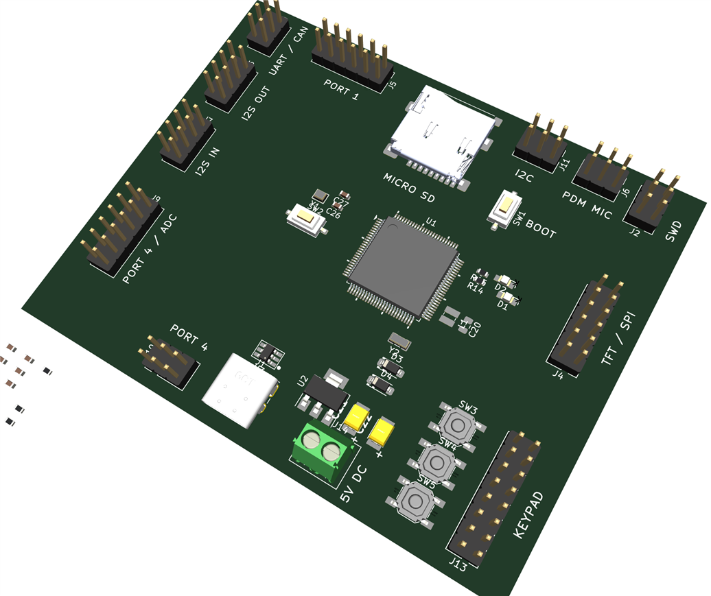

    shabaz 1 month ago in reply to shabaz

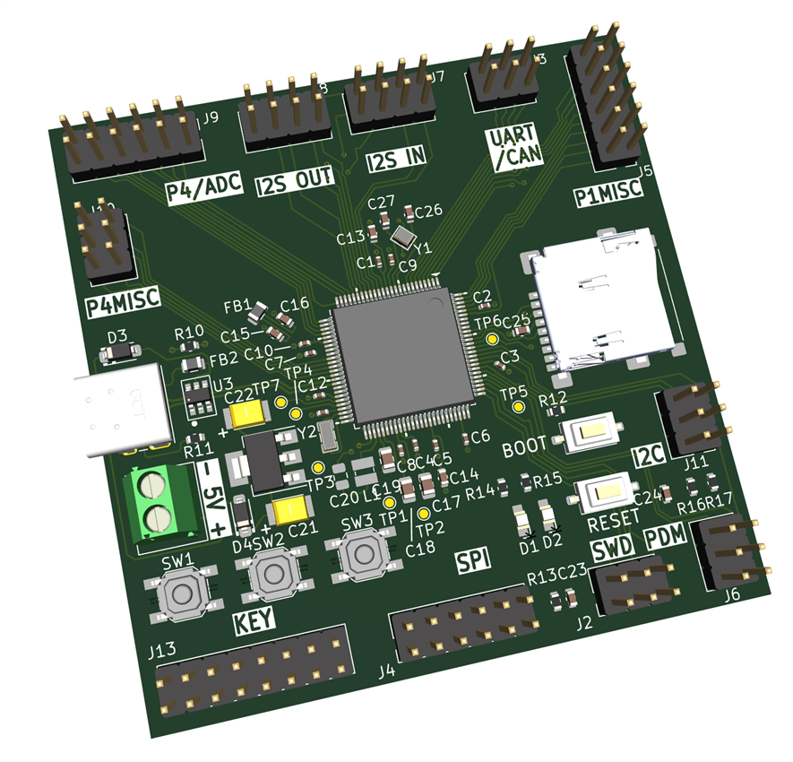

    A bit more progress from the weekend (about 70% routed).
    Also, there is a MCXN547VKLT part, which could be a drop-in replacement! It has dual core, more RAM and Flash, a neural processor unit (NPU), a second USB interface, plus Ethernet. For the second USB interface, I've placed test pads. The Eth PHY could connect to the P1MISC header, but would also need one signal from the SPI header, so unfortunately the MISO pin would not be available if Ethernet was used. Anyway, it's just a test board, to try out the IC(s), the MISO won't even be needed if that SPI is only used for a display, and MCXN547VKLT is just a stretch goal, so I'm not too concerned about that.
    The supported ICs are:
    MCXN236VKLT: 1MByte Flash, 352k RAM
    MCXN235VKLT: 512kByte Flash, 192k RAM
    MCXN547VKLT:  2MByte Flash, 512kByte RAM, dual USB, 100Mbps Ethernet, NPU
    It's proceeding to a degree.. not fully thought out yet, but may look something like this, about 80x80mm board (I've not routed any signals, just positioned parts approximately where they could go).

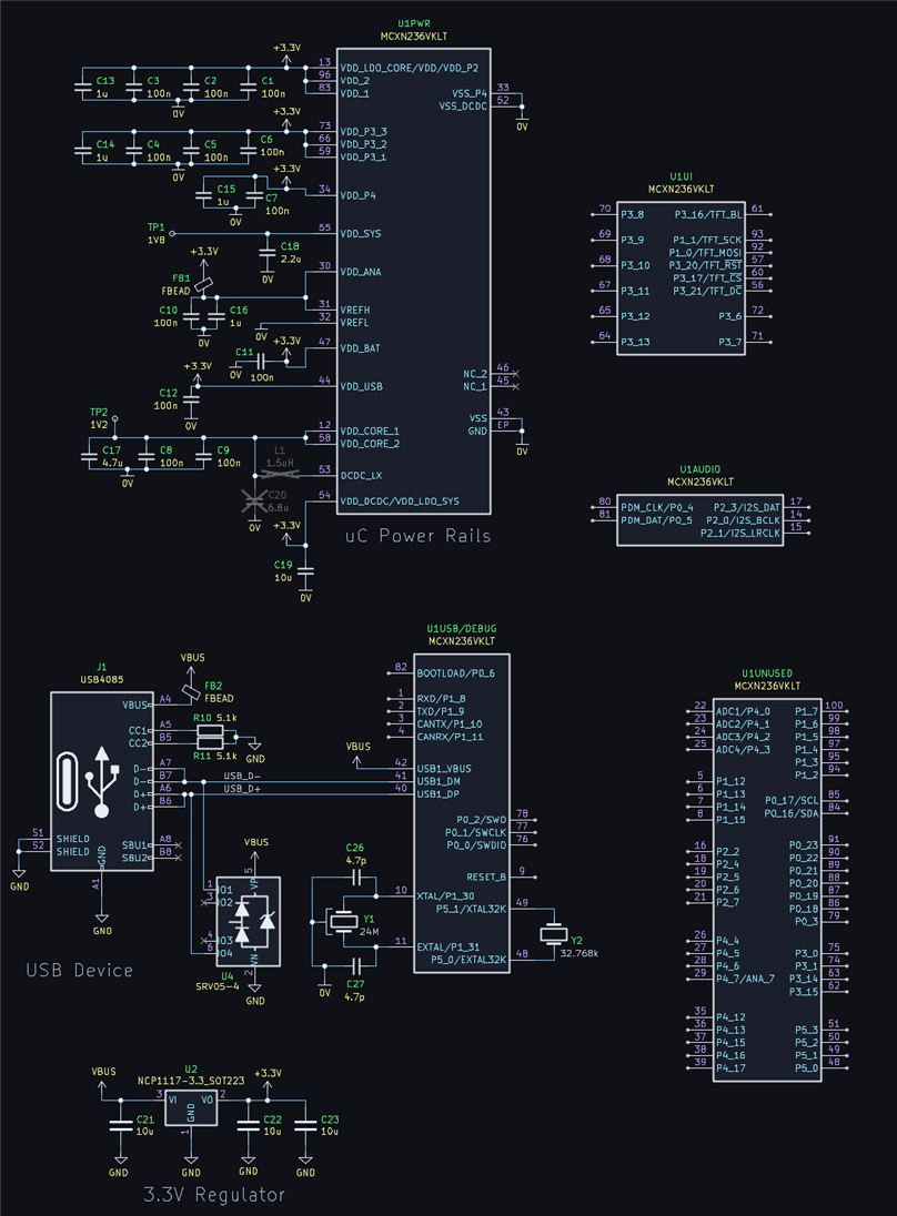

    If anyone wants to look over the circuit to make any suggestions, the schematic is here:
    imagePDF

    jc2048 1 month ago in reply to shabaz
    Might be solid tantalum. This range from Vishay has a SMD marking code of 'DA' for a 100nF 20V part.
    https://www.vishay.com/docs/40179/tmcp.pdf
    There's a very low-cost ($20) development board for the MCXN236. Looks extremely good.
    Even has CAN FD on-board! Plus, it has the really nice MCU-Link on-board, which is a CMSIS-DAP Debug Probe, which works with most ARM Cortex-M microcontrollers (might be tied to the target microcontroller on the board though), works with the usual OpenOCD with (say) GDB, and is quite speedy compared to some other debuggers. This board would be great for audio experiments too.
    I've started creating a custom dev-board (since I want to use the TQFP package, not BGA). I'll bring out all pins to headers.
