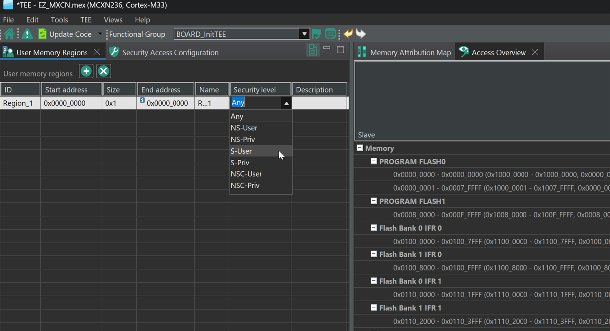

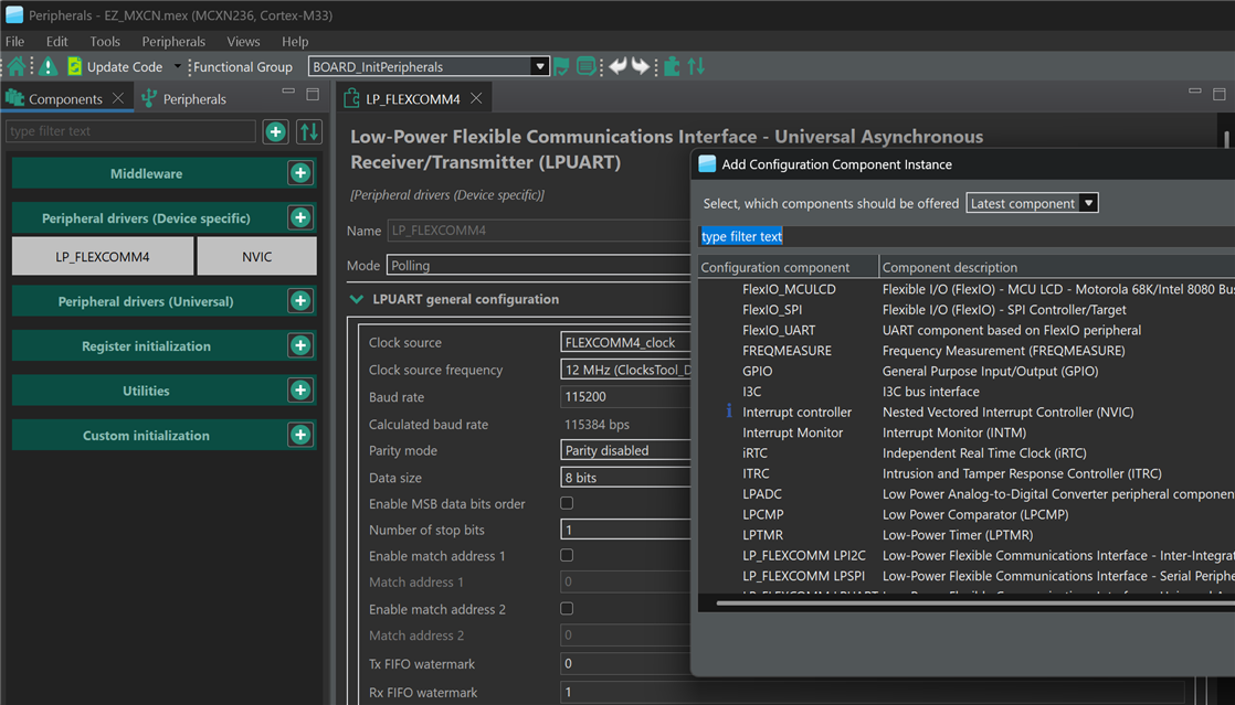

    shabaz 23 days ago
    This is what the MCUXpresso Config Tools software looks like. The software allows for the configuration of:
    1. pins
    2. clocks
    3. drivers/peripherals
    4. security (trusted execution environment aka TEE)
    The screenshot here shows the pins config, this is pretty straightforward really, just tick to select the desired pin function, and it will appear in a list in the bottom pane, where you can then give it a friendly name etc. The chip illustration in the right pane is not very readable, someone didn't check the resolution of the image they placed in the software I guess : (
    The clocks config is scary, although, I was trying it after reading zero documentation, and did manage to get it to eventually not generate an error. To get the most out of this I will need to study a bit : (
    There's an auto-resolve mouse-right-click feature, which figures out all the PLL register settings, after typing in a desired frequency.
    The drivers config looks fine, generally understandable:
    I know nothing about the trusted execution environment functions, but it seems to be a way of setting access rules for different regions of memory, which is neat.

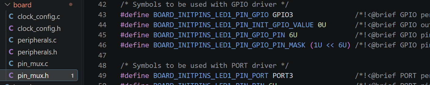

    After all that, by clicking on an Update Code button, these files are generated, all ready for adding into projects.

    kk99 22 days ago in reply to shabaz
    This MCUXpresso Config Tools software looks like a helpful tool. It’s good that a version for Linux is also available.
    The security features are important when you’re working with signed firmware and devices with secure boot enabled, especially when you need to deliver secrets. In such cases, the user-accessible regions usually provide only an encrypted payload or request specific operations, while the security regions, together with OTP/eFuse, operate on that data. At least, this is how it works for the slightly bigger-core brothers, e.g., Cortex-A55 with TrustZone and OP-TEE OS running on Linux.
