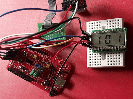

Port of  Building a Low Power Compact LCD Display to TI's MSPM0 controller. I use  EasyL1105: A Dev Board for the TI ARM Cortex-M0+ L-Series . This port can be used on any MSPM0 launchpad or board.
LCD
It's a low power 3 character i2c display. There is no backlight. It uses reflected ambient light.
Ref Code Mnfr Part #
LCD1 1838930 LCD-S301C31TR
Check the original post for the schematic, PCB and BOM.
Connections

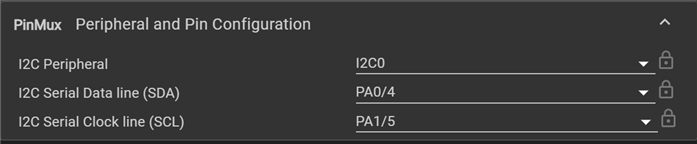

Only power and i2c is needed. The EasyL1105 has the necessary pull-up resistors.
signal LCD board MSPM0 EasyL1105
GND 1 J1-1
I2C SDA 2 SDA/PA0 J1-8
I2C SCL 3 SCL/PA1 J11-7
3V3 4 and 5 J1-11
MSPM0 configuration

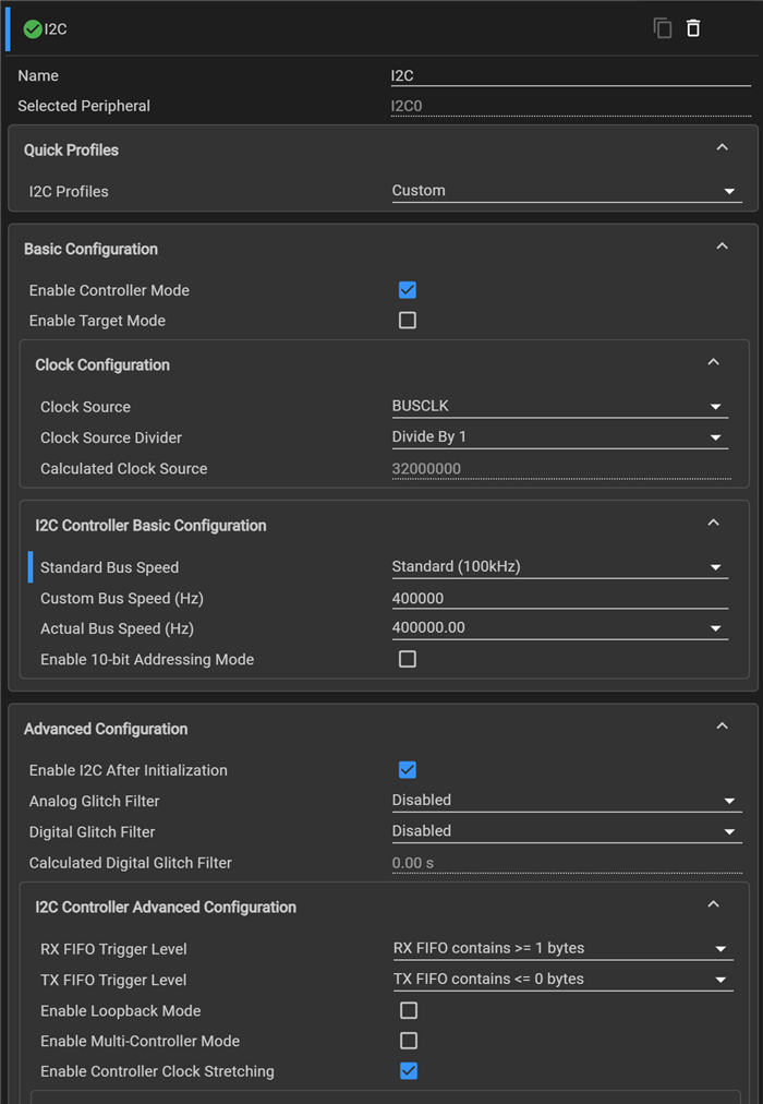

This only needs the i2c peripheral. I'm using buffered FIFO, transmit only.
I managed to get the clock up to 800 kHz, and it still worked reliable. I haven't checked yet how (or if) I can configure the controller to go to 1 MHz.

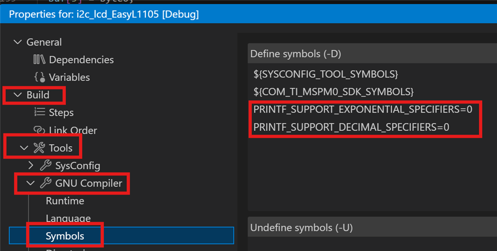

I disabled floating point and exponential format in the printf lib, to reduce code size.
PRINTF_SUPPORT_EXPONENTIAL_SPECIFIERS=0
PRINTF_SUPPORT_DECIMAL_SPECIFIERS=0
The LCD, and software, can render numbers with decimal point. If you want to use that, remove the above 2 symbol definitions.
