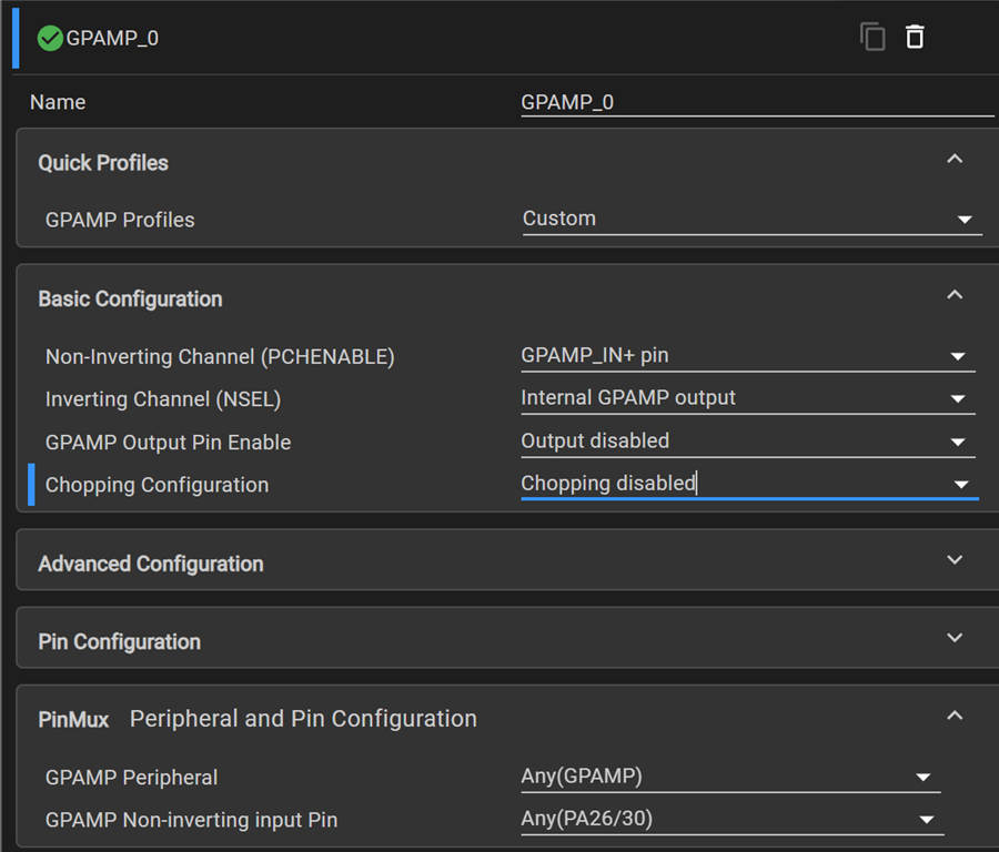

For this example, the GPAMP is configured with x1 gain (a buffer or input follower). And its output is internally routed to the ADC input.
source: wikipedia all rights released (Public domain)
GPAMP settings:
The non-inverting input (+) is routed to pin PA26. The output is internally routed to the inverting input (+).

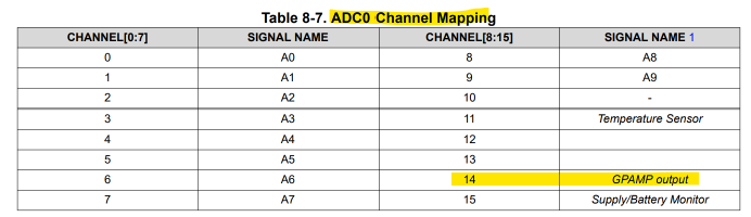

The internal routing to the ADC is done by setting the ADC channel:

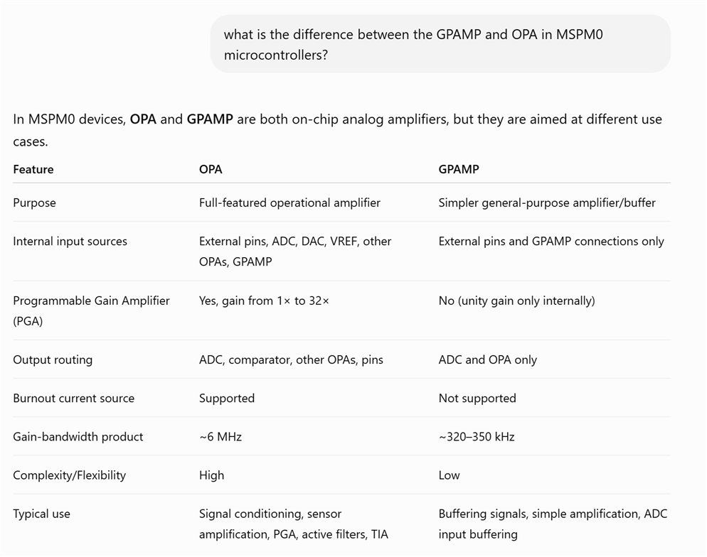

ChatGPT info:

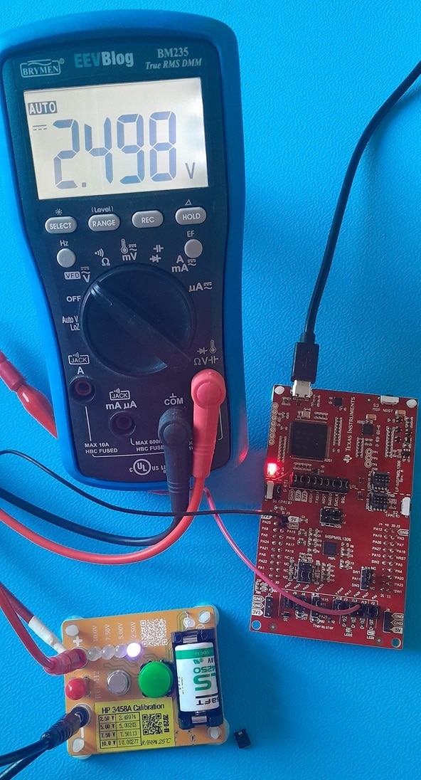

The test source is a 2.5 V reference. The ADC reference is VDDA (3.3 V). I've done 3 tests: measure the ADC reference voltage, and the 2.5 V test signal.
  • buffered by GPAMP,
  • directly to the ADC
  • with a Brymen BM235 DMM
GPAMP (0 - 4095) ADC (0 – 4095) BM235 (mV)
ADC ref 4085 4095 3290
input 3110 0.761321909424725 3097 0.756288156288156 2498 0.759270516717325
This will work for the EasyL1105 board and with an L1306 Launchpad.
