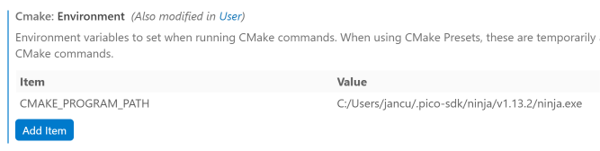

If your CMake and Ninja executables are not on your path, you can define them in the settings. If tcmake.exe and ninja.exe are on your path, you can skip the steps.
Select the Manage cogwheel, and select Settings. Select the Workspace tab.
Extensions -> Cmake Tools
Set the path to your cmake.exe in Cmake Path:
And add Ninja's executable as CMake Environment variable CMAKE_PROGRAM_PATH.

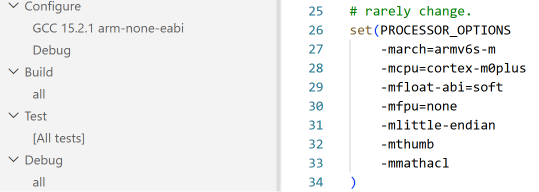

Minimal CMake File and Test Code
I lean heavily on TI's notes here. The C source is the same. The CMake file is adapted to GCC. And I left out the parts that will be covered in a follow up post.
The goal is to have a successful build. Create a binary without errors or warnings.

set(PROCESSOR_OPTIONS
    -march=armv6s-m
    -mcpu=cortex-m0plus
    -mfloat-abi=soft
    -mlittle-endian
    -mthumb

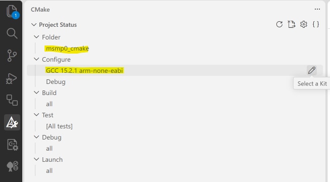

Use CMake Tools to configure the project and run a build
Open CMake Tools. Select your project folder.
If your arm cross is on the path, you can directly select it as a kit in the Configure node. If not, press the Select a Kit pencil, and scan recursively for toolchains.
In the dialog that pops up, navigate to the root directory of your GCC arm-none-eabi kit. If you use the Raspberry Pico extension for VS Code, you will find at least one GCC version in its toolchain subfolder.
Complete configuration by pressing the Configure button:
You should see output similar to this:

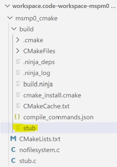

Then build the project:
The output should have no errors and warnings
[main] Building folder: c:/Users/jancu/workspace_vscode_mspm0/msmp0_cmake/build
[build] Starting build
[proc] Executing command: C:/Users/jancu/.pico-sdk/cmake/v4.2.1/bin/cmake.exe --build c:/Users/jancu/workspace_vscode_mspm0/msmp0_cmake/build --config Debug --target all --
[build] [2/3  33% :: 0.127] Building C object CMakeFiles/stub.dir/stub.c.obj
[build] [2/3  66% :: 0.144] Building C object CMakeFiles/stub.dir/nofilesystem.c.obj
[build] [3/3 100% :: 0.262] Linking C executable stub
[driver] Build completed: 00:00:00.319
[build] Build finished with exit code 0
Let's check if the executable is built: yes Slight smile

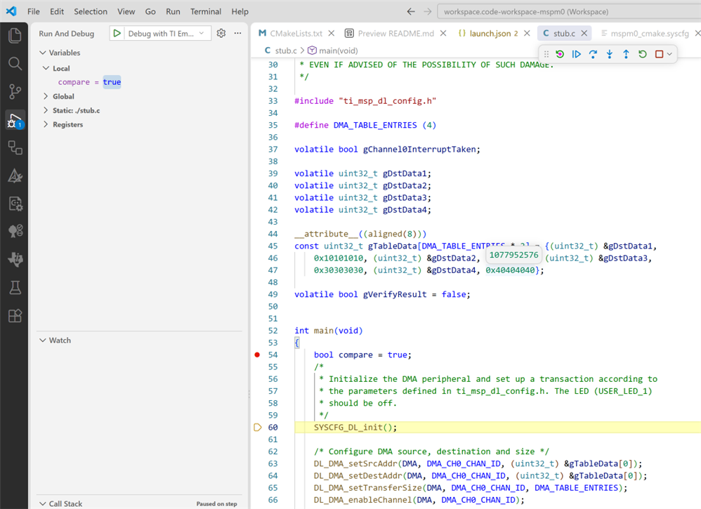

    Jan Cumps 2 months ago
    All works. It can build firmware (also .hex file compatible with shabaz ' bootloader).
    And the debugger works from within VS Code Heart :
