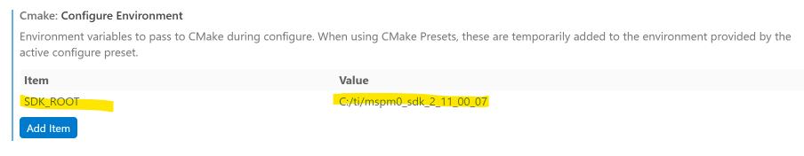

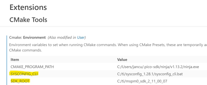

Configure Environment Variables
SDK_ROOT and SYSCONFIG_CLI:
In the next post, where I use the debugger, there are a few more settings to do.

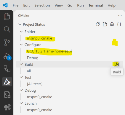

    Use the VS Code CMake plugin to select the GCC compiler, and then config and build the project:
    If all is well, you should get this message after config:
    [cmake] -- Configuring done (4.2s)
    [cmake] -- Generating done (0.1s)
    [cmake] -- Build files have been written to: C:/Users/jancu/workspace_vscode_mspm0/msmp0_cmake/build
    And this after build:
    [build] [4/4 100% :: 1.279] Linking C executable mspm0_cmake
    [driver] Build completed: 00:00:01.337
    [build] Build finished with exit code 0
