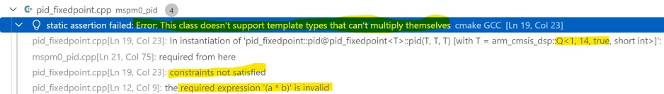

template <typename T>
concept SupportsSelfMultiplication = requires(T a, T b) {
    { a * b } -> std::same_as<T>;
export namespace pid {
template<typename T, bool negative = false> class pid {
   public:
    pid(T kp, T ki, T kd) : kp(kp), ki(ki), kd(kd) {
        // Provide a clear message to display if compilation fails
        static_assert(SupportsSelfMultiplication<T>,
            "Error: This class doesn't support template types that can't multiply themselves");
    // static constexpr  T out_max {std::numeric_limits<typename T::value_type>::max()};
    static constexpr T out_max {automated_traits<T, negative>::max()}; // Use dsp_traits to determine the maximum value for type T
    static constexpr T out_min {automated_traits<T, negative>::min()}; // Minimum allowable output

C++ disclaimer:
This class is as efficient as a classic C API style design. Nothing in this OO code uses any clock tick, flash space or RAM. Not a bit. Not a tick.

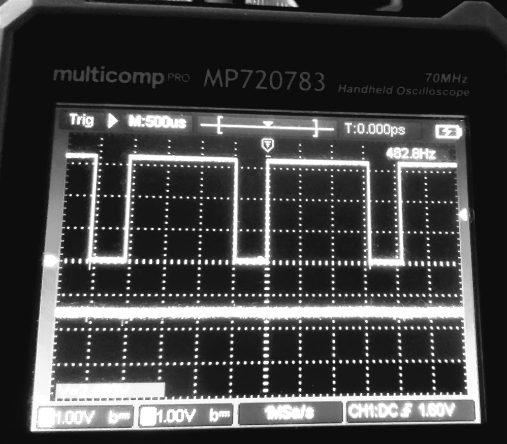

main: Use the PID class with the DSP++ fixed point format:
Here, everything comes together:
  • the floating point format is defined. I use DSP++ Q15 and its integer math support.
  • a PID controller object is created, that knows it is working with Q15 format.
  • PID loop is executed at regular times. Look at its code to see how UINT ADC and PWM values are converted to DSP++ Q15.

void perform_pwm() {
    // Convert Q15 per-unit (0.0 to 1.0 excluded) to raw timer counts (0 to 65535)
    DL_TimerG_setCaptureCompareValue(PWM_0_INST, (static_cast<uint32_t>(output_pid.v) << 1), DL_TIMER_CC_0_INDEX); // update ccr0 value
void perform_pid() {
    output_pid = controller.compute(target_command, feedback);
