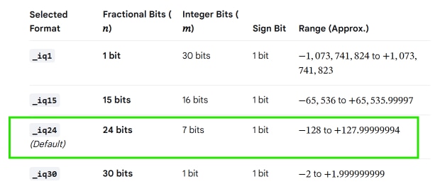

The lib allows you to select the number of bits reserved for the fractional part. I used the default Q(24) format, where 24 bits of an int32_t are used for fractional.

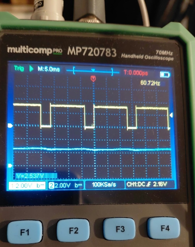

image: real time capture, regulating to desired output of 70% of 3.3V. PID loop executes every 2 ms.

With the clock at 32 MHz, and GCC 15.2.1, optimisation set to max, the PID takes 140 µs. That includes:
  • sample and convert value to IQMath
  • run PID algorithm
  • convert IQMath outcome to 16 bits unsigned and set PWM duty cycle
With the same toolchain, but optimisation off, for debugging, the loop takes 150 µs.

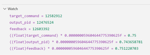

The project tries to set an output voltage to a given set level.. It uses PWM to generate that voltage. ADC is used to measure that voltage.
At runtime, the PID algorithm constantly validates if the voltage matches the set level. If not, ith adjusts the PWM duty cycle to drive the voltage either up or down.

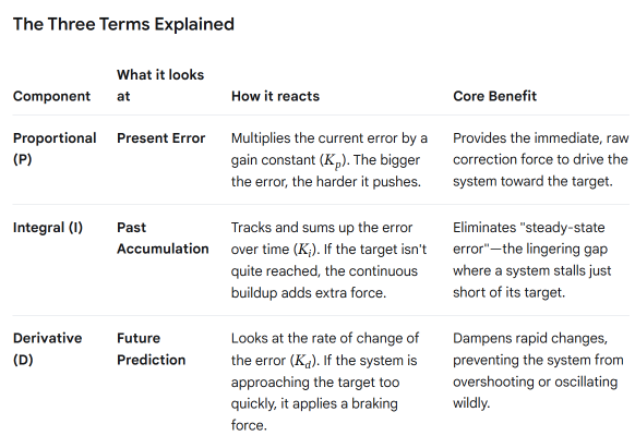

AI can support. You can ask it to suggest parameters to make it move faster to the set point, to react faster or slower on load changes, to improve stability, to avoid ringing or overshoot...
This is how Google Gemini AI explains the role of the parameters:

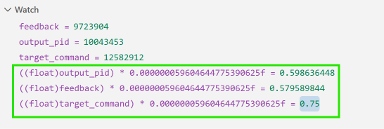

Want to see if this works? Create a small program that runs these instructions. Look at the underlying representation with a debugger:
     // test conversion ADC unsigned 12 bit value to IQ24
     uint16_t adc_result = 4095; // max
     _iq iq_adc_result = ((int32_t)adc_result) << 12; // 1.0
     [[maybe_unused]] float float_adc_result = ((float)iq_adc_result) * 0.000000059604644775390625f; // for your convenience, show as float. Should be 1.0
     // test conversion IQ24 to 16 bit PWM duty cycle compare value
     _iq iq_duty_cycle = _IQ(1.0);
     [[maybe_unused]] uint32_t duty_cycle = ((uint32_t)iq_duty_cycle) >> 8; // should be 65536

  • generic timer PWMG1, to make the control loop tick every 200 ms. It fires an Interrupt to signal the loop has to be executed.
  • GPIO pin PA27 to make a LED light up when the loop runs.
    The loop is so fast that you can't see it, but you can put an oscilloscope over it.

    This is a real-time render of the startup sequence of the controller in action. requested output: 0.7. (That's 3.3V * 0.7 = 2.31V) PWM frequency: 488 Hz PID loop executes every 2 ms P: 0.1 I: 0…

    in this design, a passive low pass filter turns the PWM to a DC voltage:
    Originally, I used TIMER TIMG1 for PWM. But it can only access low drive output pins.
    When you want to load the output (to experiment with the PID correction), those PWM pins are too weak, and don't drive to 3.3 V.
    TIMG0 can drive PA5. And that pin has the hardware for high drive. So I changed the design to use the TIMG0 / PA5 combination.
    In the original code, timer TIMG0 was used to control the PID control loop. That timer doesn't need to drive any output, so I switched it to TIMG1.
    All changes can be done in SysConfig. Code doesn't need to change. You 'll now find the high drive PWM on PA5 (LaunchPad headers pin 15).

    I added a new version of the project, with an updated PWM duty cycle set  function.
    There was bug in the original code, where if the output was set to max (1.0), the Duty Cycle counter resulted in value 56536. And that's one too high.
    It results in the PID thinking it's pushing to the max, but the PWM outputting nothing (0% duty cycle).
    The code below checks for that condition, and sets the the PWM to full on (3.3V)in that case (100% duty cycle).

    Jan Cumps 1 month ago
    P: 0.1
    I: 0.01
    D: 0.05
