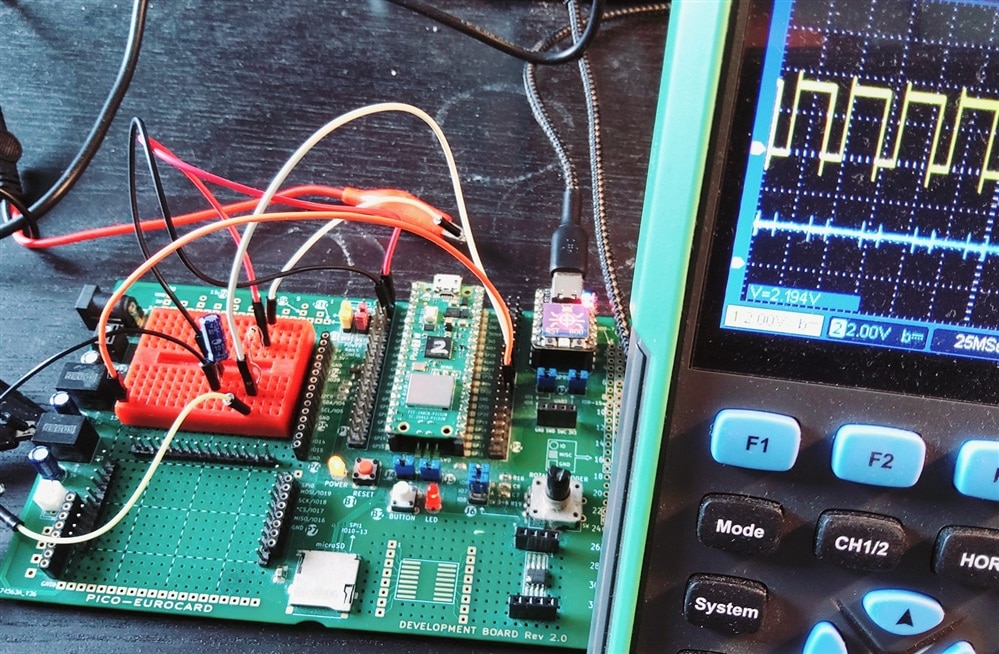

This is a proof of concept. A test to show that the generic PID class I wrote with a TI MSPM0, is actually generic.
In this post, I make it run on a Raspberry Pico2.
The design is a stabile DC voltage supply.
  • Pico PWM generates a DC voltage. The level is set by changing the duty cycle between 0% (0 V) and 100% (3.3 V)
  • a low-pass RC filter turns the PWM signal into DC.
  • Pico ADC monitors that DC value (feedback).
  • my PID class controls the PWM, based on desired output, and the ADC feedback.
For a full design explanation, see  PID controller without floating point for ARM controllers using DSP C++ fixed point API . This post uses the exact same design. Only the peripherals are ported from the MSPM0 SDK to Pico SDK: GPIO, ADC, PWM and timer tick.
Differences compared to MSPM0 design:
  • the Pico can run the PWM at higher frequency, with the same duty cycle resolution (0-4095): MSPM0: 488 Hz, Pico 36 kHz.
  • It executes the PID loop faster. With compiler optimisation to max: MSPM0: 140 µs, Pico RP2350: 2.8 µs
Same as MSPM0 design:
  • identical code, except the SDK calls to GPIO, PWM, ADC and timer
  • same resolution of ADC and PWM duty cycle
  • same GCC ARM compiler version and optimisation settings
Pico port of the PID example

    // PWM is +- 30 (36.6) kHz, set PID loop to 1/10: 3.66 kHz
    add_repeating_timer_us(-274, repeating_timer_callback, NULL, &timer); // call PID every 274 µs, Start-tot-Start timing
    while (1) {
        if (perform) {
            perform = false;
            gpio_xor_mask(1u << GPIO_PIN); // toggle before
            perform_adc();
            perform_pid();
            perform_pwm();
            gpio_xor_mask(1u << GPIO_PIN); // toggle after

    Jan Cumps 19 days ago in reply to Jan Cumps
    Here is a design based on timer based ADC sample:  Pico low jitter PID controller
    In this test code, a timer makes the PID loop run, and the loop performs ADC.
    A better approach is to time the ADC sampling, and let an ADC interrupt kick off the PID as soon as the sample is in.
    On a Pico, you'd make the ADC run timed, in the background by:
    adc_set_clkdiv();
    adc_run();
    And you 'd kick off the PID cycle by setting up an "ADC finished" interrupt:
    adc_fifo_setup();
    adc_fifo_drain();
    irq_set_exclusive_handler();
    irq_set_enabled();
    adc_irq_set_enabled()
    And then in the ADC handler, you retrieve the FIFO sample and run PID.
    uint16_t sample = adc_fifo_get();
    // run the pid
    The main loop () is not involved.
