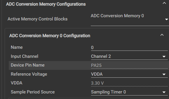

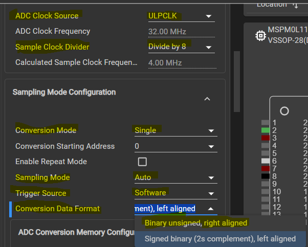

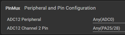

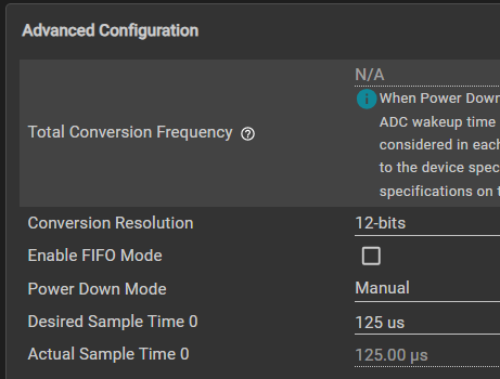

Set up ADC SysConfig
The Conversion Data Format, 2s complement, left aligned, happens to be the same Q15 format that our PID library uses.

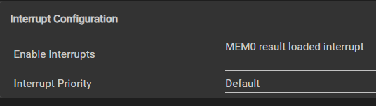

Code adaption from post 1:
I use a flag to check if sampling is done. The Result Loaded trigger will set that flag.
volatile bool gCheckADC;
uint32_t gAdcResult;
void ADC12_0_INST_IRQHandler(void) {
    switch (DL_ADC12_getPendingInterrupt(ADC12_0_INST)) {
        case DL_ADC12_IIDX_MEM0_RESULT_LOADED:
            gCheckADC = true;
            break;
        default:
            break;
In main(), the IRQ gets enabled

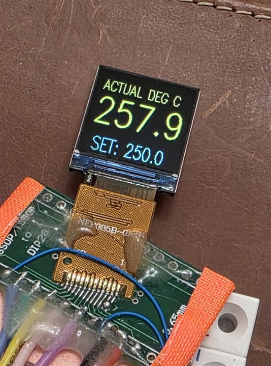

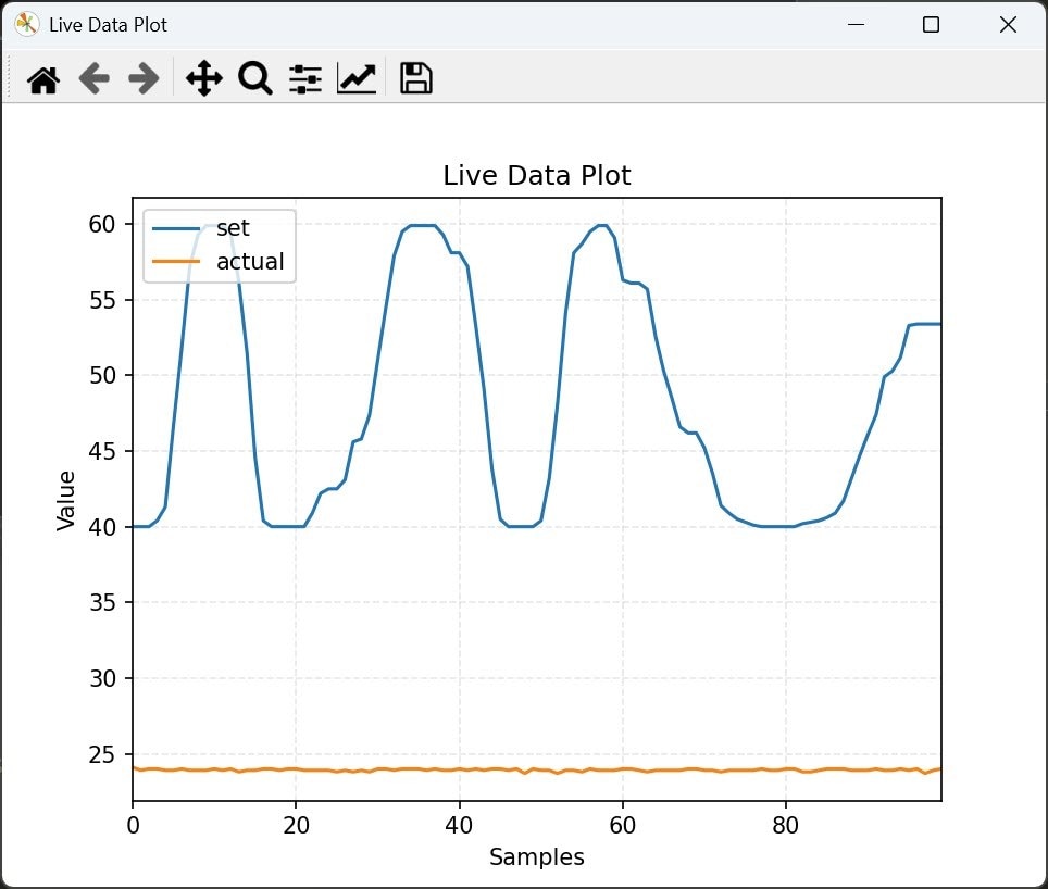

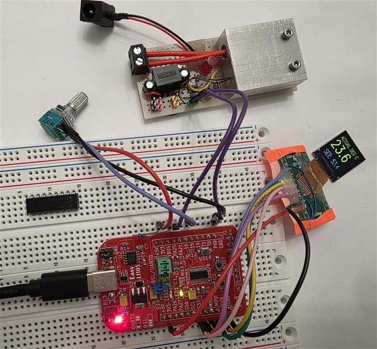

    Making progress, I've still not integrated the PID in your latest blog posts, I still need to get to that, but I have now implemented the perform_adc() for both the thermistor and the set temperature potentiometer, and finished building the testbed.
    Here's the testbed. At top-left the teal-colored potentiometer (20k) will be used to set the desired temperature, it is connected to PA15.
    At the top of the photo is the test block of aluminium, with heater (red thick wires) and thermistor (very thin wires just below it). The heater is connected to a MOSFET. There is also a DC-DC converter visible, it's used to convert the 24V DC input to 3.3V, eventually to power the microcontroller and display, but I've not wired that up yet. I've only wired the thermistor (via purple wires) to the microcontroller so far.
    In the code, I've temporarily set the potentiometer range to be for 40-60 degrees C (eventually it will be changed to 50-150 degC perhaps).
    Here is the live plot, I was just playing with the potentiometer, you can see it was adjusted betwen 40 and 60 deg C (I'm actually using values multiplied by 10, but I divide them later for the display). As can be seen in yellow, the thermistor is reporting about 24 deg C which is about expected currently, since the heater is unpowered.
    The logger is executed using the following (the --div10 instructs it to divide the values by 10):
     python .\pid_logger.py --port COM8 --baud 9600 --div10
    The other neat thing is that the UART still works for the CLI, so we can type (say) kp/ki/kd to see the PID parameters, and adjust them on the fly, and immediately see the effect on the live display.
    The main downside of the project is that the display flickers since it is wiped clean every fifth of a second. It's still readable, but does look ugly as a result. It would be nice to re-do that so digits are only wiped if they change, but it's a lot of effort, I might leave that, since the display is usable, The font is proportional so it's not so easy to modify, although one could save the co-ordinate of each character since the character drawing function does provide the spacing offset to the next character. Anyway, I'm more interested in getting the project functionally working currently, rather than the cosmetic fix of the display.

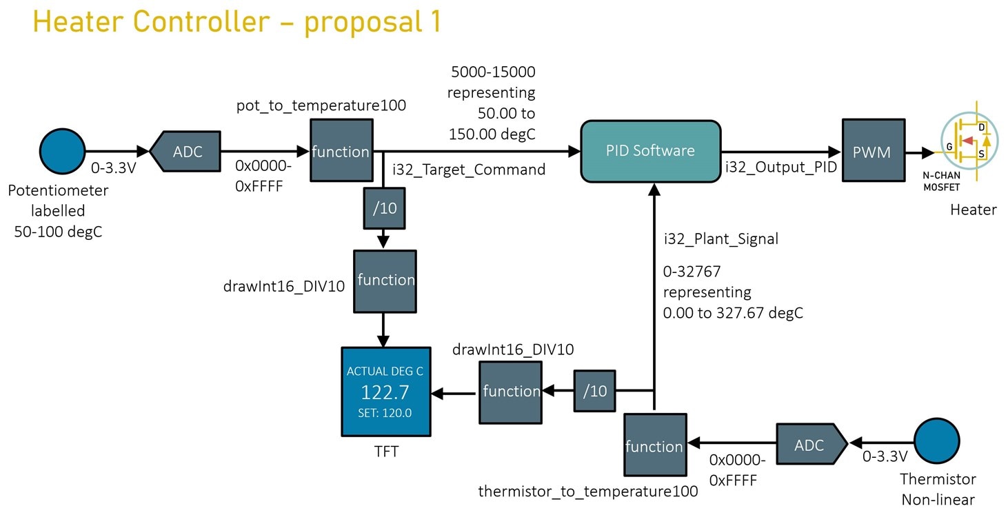

    I wasn't sure where was best to do the conversions. Currently I was thinking of doing the conversions before going into the PID software, since I was concerned about linearizing the thermistor as soon as possible (otherwise I suspected I would have to do something with the potentiometer conversion to match). In any case, there is the initial advantage that it may make troubleshooting the system more human-followable from the debug outputs, but it may well increase the runtime costs as you say, and reduces resolution into the PID : (
    Regarding the resolution of data available into the PID software, currently I have the data represented as hundredths of a deg C (e.g. 10000 = 100 degC), but for display purposes, I still need to write a function to divide that by 10. To display with a decimal point, I've implemented (and tested) a drawInt16 function that accepts a DIV10 flag to automatically insert a decimal place.
    Hopefully the proposal looks feasible. If so, then I reckon we are almost there (and we could always optimize further, or re-jig things once some experience has been obtained with the PID library, it's a very gray area for me currently in terms of how well it can handle the suggested ranges/resolution of values.
