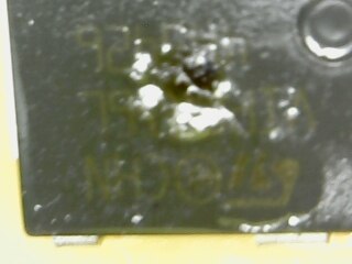

Hi guys
It has been a long time since I soldered something, but with COVID-19 decided to dust off my knowledge about electronics.

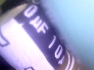

My air-fryer Philips XXL (5 years old) stopped to switched on (after I felt the smell of something burnt out).
I found resistors got burnt - see pictures
I need your help what Om and W value of those ones?
Looks like they have 4 bands: Orange, Black, Black, Gold, which is 30 Om.
Not sure whether it is correct. Plus, not sure how to find W.
Thanks in advance for your help,
Vlad
    jw0752 over 5 years ago +4
    Hi Vlad, I agree with Jan that the black capacitor near the transformer looks like it has over heated and is probably damaged. If you have a meter it would not hurt to measure the resistance of the heat…
    dougw over 5 years ago +3
    The power rating can usually be deduced from the physical size. These look to be about 1W. but I'm not sure from the picture exactly how big they are. . They don't look burned enough to be smelling burnt…
    Jan Cumps over 5 years ago in reply to vladnech +3
    L1 is an inductor. It indeed looks like there's a blowhole in the IC. For the glue-like compound: has something melted above the IC and dripped down on the IC?

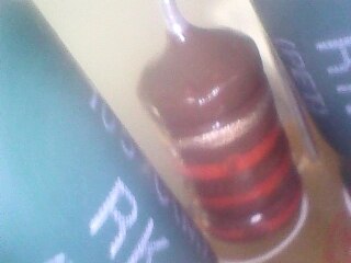

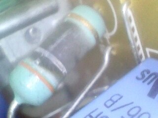

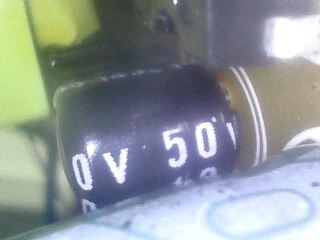

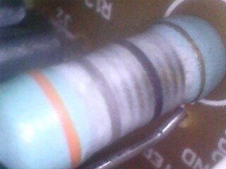

    vladnech over 5 years ago
    Hi guys
    Thanks a lot for your time - really appreciate it.
    I have done pictures to identify nominals (sorry for the quality - I did it using USB ear camera image ) and video (to show all landscape).
    Maybe it will help to bottom out the issue.
    1. Capacitor (C6)
    2. Brown/red resistor (L1)
    3. Resistor R1
    4. Resistor R12
    IC and other components are on the video (Google Drive publicly available video): https://drive.google.com/file/d/1fJ8EYyfmIklSo9xOCAaim1El4aIWuVje/view?usp=sharing (IE or Edge can ask you to download the file - 154Mb)
    Also, I found the following forum (link was moderated, sorry), where guys discussed a similar issue, they also identified:
    1. C6 - 10uF 50V
    2. L1 - 22 Om. Maybe 3W
    3. R1 - 33 Om 5% 3W
    4. R12 - 33 Om 5% 3W
    Not sure it is valid.
    Plus, in my video, I found the IC is covered with glue or something, but maybe something has blown out and covered it with that substance?
    Thanks again for your help,
    Vlad

  • vladnech
    vladnech over 5 years ago in reply to vladnech
    Sorry, guys, for the delay. Looks like my message has got stuck in moderation.

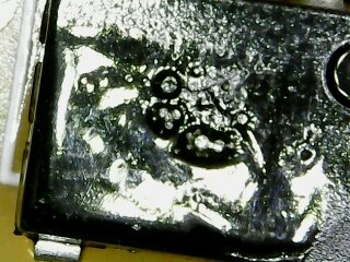

  • vladnech
    I just followed John's advice and took a picture of the chip, using a microscope.
    Looks like it is blown out, which caused the Capacitor and Resistors suffering.
    Not sure what the nominal of this chip.
    Probably this one -
    VIPER16LNVIPER16LN
    https://au.element14.com/stmicroelectronics/viper16ln/ac-dc-converter-800v-60khz-7dip/dp/2311359?ost=viper16l&krypto=Sbg…
    jw0752 over 5 years ago in reply to vladnech
    Hi Vlad,
    The Viper 16LN is an AC to DC switching converter and when it failed it likely took out the other components.
  • vladnech
    vladnech over 5 years ago in reply to jw0752
    Hi John
    Does it mean it is better to replace PSU circuit - not to do individual components replacement?
    Thanks,
    Vlad
    Hi Vlad,
    That depends on you, your electronic skill level, and how comfortable you are with the cost versus risk. I know the feeling of accomplishment you will have if you do replace the parts and ultimately repair the board if worth a lot too. I hope you keep posting as you go along as we are all interested in your success.
