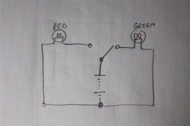

Hello,
I am trying to find a way to turn off a circuit with a red light, when another circuit with a green light is closed. When the green light circuit becomes open, the red light should turn back on.
Any help with this problem would be greatly appreciated.
-Thanks

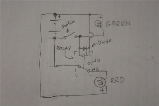

    jw0752 over 9 years ago in reply to mark.yankowiak1@gmail.com +1 suggested
    Hi Mark, I drew this schematic very quickly and the RL is just a left over. If there were more than one relay they would be numbered RL1, RL2, etc. The SW2 switch can be replaced with a wire and SW1 can…

    COMPACT over 9 years ago in reply to COMPACT +1 suggested
    Modded for a single power source

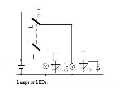

    hi,
    Intermediate switch.
    https://upload.wikimedia.org/wikipedia/commons/b/b5/Crossover-switch-symbol.svg
    and two diodes in series to the lamps.
    https://www.google.at/search?q=Intermediate+switch&biw=1301&bih=829&tbm=isch&tbo=u&source=univ&sa=X&ved=0ahUKEwiOvZOEwMD…
    https://en.wikipedia.org/wiki/Switch
    Gerald

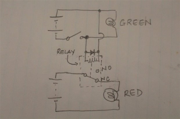

    Is this what you are trying to accomplish?
    When the Green circuit is OFF by the switch -  the Red Circuit is ON by the relay.
    When the Green circuit is ON by the switch  - the Red Circuit is OFF by the relay.
    The NO contact on the Relay stands for Normally Open
    The NC contact on the Relay stands for Normally Closed
    (With Normally meaning the state when there is not power to the relay coil.)

    0 mark.yankowiak1@gmail.com over 9 years ago in reply to COMPACT
    Thanks. I believe that's what I'm looking for. What is the symbol above the coil?

    JW,
    You forgot the back EMF diode and you are making the assumption that both circuits are running from the same power source.
    Why the extra switch for the red light? The question doesn't mention one for it.

    That's a diode. Some relays have them built in whilst others need to have them added.
    When a relay coil is de-energised the collapsing magnetic field creates feeds power back into your circuit in the wrong direction and potentially with a very high voltage.
    The diode dissipates this unwanted power in a controlled manner.

    0 jw0752 over 9 years ago in reply to COMPACT
    Hi Compact,
    We have no semiconductors to protect and I am using a cuttler Hammer 400 Amp Switch so arcing won't be a problem. Based on what Mark gave us to work with we are both making a few assumptions.image  I put the extra switch since Mark indicated he had an existing Red Light circuit so I drew a circuit and put a a switch in it.
    Mark,
    The Diode that Compact mentions is actually a very good idea and will keep you out of trouble particularly if you are using semiconductors to switch the relay. Please pencil a diode into my schematic.

    0 COMPACT over 9 years ago in reply to jw0752
    Since when are snubber/flyback diodes only for semiconductor protection?

    0 mark.yankowiak1@gmail.com over 9 years ago in reply to jw0752
    Thanks John,
    The single power source will be more convenient. Will this work if there are no physical switches? I am trying to turn on the green light when a steel washer touches two contacts. Also what does the RL stand for?
